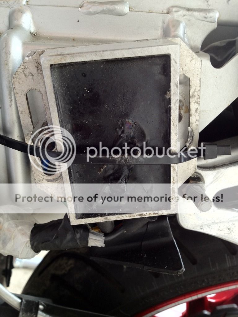

I set to checking all the fuses and found the 30A main starter solenoid fuse had blown. Replaced this and as soon as I attempted to place the solenoid lid back on, pop, it went again. This is with the ignition off.
Ive traced the wires from the battery to the solenoid and all looks good. I have also traced the wires from the solenoid to the ignition and can see no scorch marks or areas where the wire could be grounding. All earth wires I can find look secure.
Then I checked the regulator and found this:-
https://i209.photobucket.com/albums/bb70/rumppole/Regulator.jpg
Is the regulator toast?
Could this be causing the short in the main fuse?

Most certainly, that reg/rec is very poorly mounted and as such cannot get rid of the heat it generates which is likely to have caused the problem. You will need a new reg/rec which will need to be correctly fitted, also check out battery and bottom ac coils prior to starting the bike and disconnect the battery asap.

Disconnect the reg-rec to isolate it, put in a new fuse and see if it all works.
The bike should start and work fine without it connected. Obviously it won't charge up mind you, so don't ride it further than you are prepared to push it!! Wink
I think it is best to test it this way before buying anew Reg-rec that you may not NEED ...

Thanks guys, I appreciate your advice.
Could a bust reg/rec actually cause the main 30a fuse to blow though?
I tried looking at the wiring schematics and it would appear that it may well be the culprit.
I'll disconnect the reg/rec tomorrow and try another fuse.

When i got my NC30 the 30A fuse and reg-rec were both toast, it had also killed the battery. I bought the reg-rec from david silver spares for quite a bit of cash. I later found out that they are the same reg-rec as CBR600's used during some time period and that they can be got for about £35 on ebay. The better ones have a metal case with fins on to dissipate some of the heat.

You can move it to the left hand side of the bike behind a fairing vent, will get some cold air there and mount to the frame to remove more heat Thumbs Up

Sorted. New regulator from Hunters.
