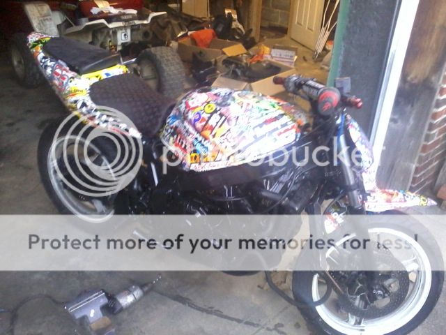

So my CBR has given up the ghost yet again. Assuming it's the stator as that's the only thing i never checked/replaced the last time.
So, bidding on one on the bay, and hopefully that should sort the problems. Gonna go over it with a mate to make sure everything is as it should be.
Now, i'm going to be buying a new hornet - waiting on the dealer getting back to me about finance deals, so i'll be fixing this up if i get it running again, and turning it into some form of mental stunter streetfighter that i can mess around on.
Something a bit like... this....
https://i133.photobucket.com/albums/q41/XxMustang281xX/Facebook/FOR%20SALE/120518_004.jpg
The subframe on my bike is modified slightly for an R6 tail to fit onto it, so i could get a race type tail fairing, and fit a 12 o'clock bar to it. Who knows, this could turn out pretty epic.
We shall see.
For now, i'll be fixing the issues, then i'll get onto cleaning it up Thumbs Up

Looks like the issue was a dodgy connector. done another 500 miles over the last couple of weeks and it's been spot on. not a problem Thumbs Up
So... shopping list now:
Tyres £? speaking to a breaker mate that might get me some part worns
While i'm there i'm also gonna see if he's still got the bits from the GPZ500s streetfighter i had. If he's got the speedo and bars, i'll be having them.
2008 R6 race tail fairing £70. shall be cutting the subframe down a tiny bit as it almosts fits, and will look pretty damn good.
Then i might go down the route of getting a single sided swingarm and some USD forks. We'll see how much cash i have.
Dunc
Edit: ALSO... Bars or clipons?
