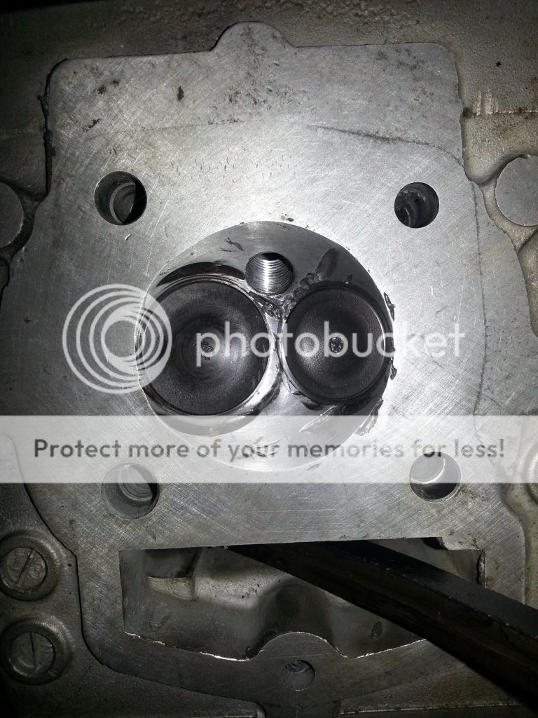

Can you point out the part of the picture are talking about.
I have striped a few bikes that have dropped valves and some where people tried to push start them afterwords.........made a mess.

To be honest you do not seem certain that it wasn't in that condition before you sent it. I think you'd have to be certain before you could really try anything. Maybe they cleaned it up and it just looks worse now?

That head looks to have been skimmed.
The valve seat is very very close to the edge of the combustion chamber.
If it was skimmed you will need to make up for that with gaskets.

Mark Roberts wrote:
I'll cut the crap.
The head is off my mates bike.
The deal is.
I rebuild it, and get to ride it aslong as it takes for me to get my full license back and get the GT back on the road.
It happened roughly 2 1/2year ago now, when the engine blew, then early on this year I propositioned him about me putting it back on the road if I fix it, because he was on about his dad wanting to get a bike.
I have the rest of the bike in the garage, waiting for the engine. But not sure where to fit this head, and risk it blowing up again in a few miles.
Mark just be aware that if one part of the engine like the head/crank goes then other parts of the engine will likely fail after you fix it.
A total rebuild is best but it might keep going for some time.

That surface does not look as though it has been skimmed but been cleaned up by using a sheet of emery cloth on a flat surface.
If the valve guide/guides have been replaced have the valve seats been recut?
Those valves do look a bit recessed into the head.If the seats were recut did they trim the 45 degree cut using 30 and 60 degree cutters to trim the 45 back to the correct width?
It would seem like the best advice has been given.Buy that engine part from ebay rather than trust that worked on part.
