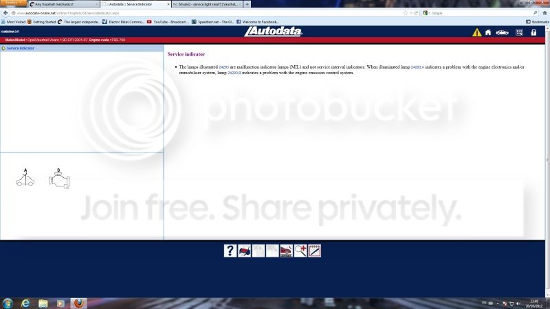

then the symbol with the car and spanner in it
I read fine, and work on vivaros every fucking day unfortunately.
You have one service light, the spanner in the center display.
The other lights are to do with engine emissions, and engine electronics/immobiliser.
You dont always get codes from these vans or cars using certain diagnostic tools, especially snapon...
Try it on Tech2 or Opcom/vauxcom or even Bosch kts, sometimes it helps to go in under renault trafic or nissan primastar.
There may be an oil quality that needs to be reset.
Im only trying to help and sometimes i wish i didnt bother.
