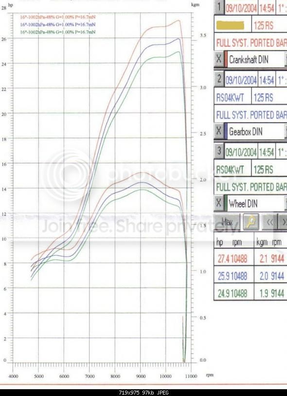

A tuned RS125 two stroke (with a powervalve) and the following; Jim lomas SS system, 34mm Carb, V Force 3 reeds, HPI Racing cdi, Mitaka Barrel and piston kit
Makes a dyno graph like this;
https://i1148.photobucket.com/albums/o574/_Iain_/dyno.jpg
Note the engine revs along the bottom. It makes no power whatsoever till 6000rpm. Then it suddenly shoots up & trails off at around 9250rpm. It revs out at 11,000 so i'm assuming it hit the limiter and the dyno operator shut the engine down. Thats well over the redline!
The engine makes decent power for 3000rpm. The rest of the time it's flat as a fart & makes the power of a moped. Totally and utterly useless unless its going to be spending all its time above 7,000revs. And then it'll blow up very quickly as it'll be thrashed to death.

Note how it pulls from 2,000 all the way to 9250? The shape of the graph?
It's smooth predictable power, which is what you're asking for. You're trying to get this power, and power curve out of a two stroke 50cc. It just wont happen!
