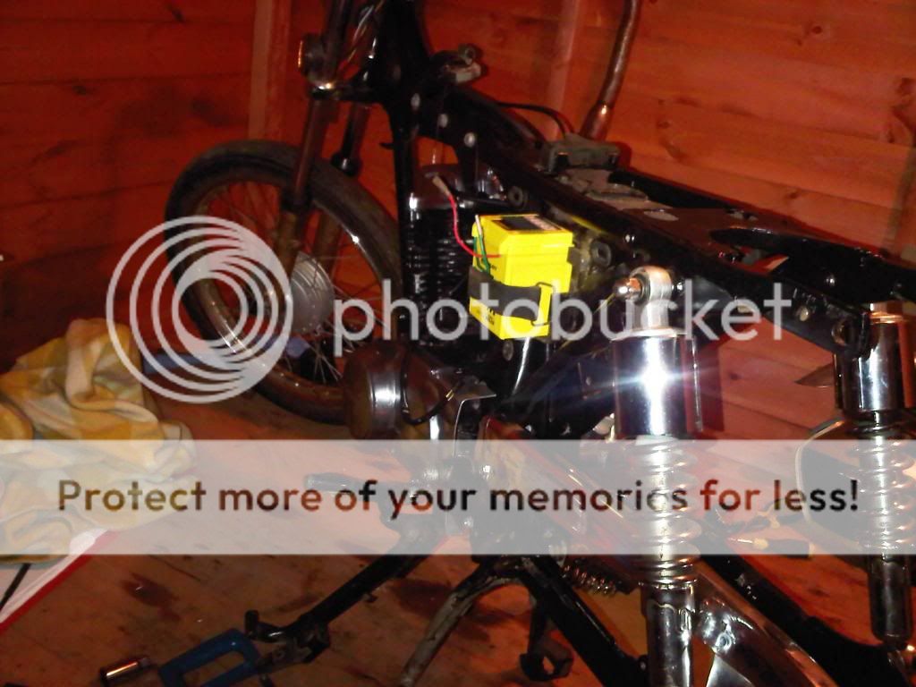

so i have stripped the frame
https://i25.photobucket.com/albums/c81/mudcow007/IMG00030-20120504-2102.jpg
sanded an painted (nitromors smooth finish)
https://i25.photobucket.com/albums/c81/mudcow007/IMG_1620.jpg
engine polished an re-blued
https://i25.photobucket.com/albums/c81/mudcow007/IMG_1640.jpg
https://i25.photobucket.com/albums/c81/mudcow007/IMG00138-20121112-2030.jpg
new shocks an chain guard
just currently working on electrics
fingers crossed it will be back on the road January - just in time for all the ice
