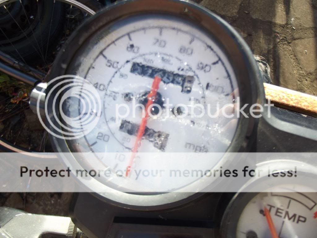

i have just acquired a ns 125 rk with some help from snorty, one of the things i am unsure on is condensation in the clocks and how to remove it....
any hints tips or ideas would be greatly received
will post better pics tomorrow
U_W v2.0
Joined: 07 May 2012
PostPosted: 18:36 - 10 Nov 2012    Post subject: Reply with quote
take them off, dump in a bowl of rice, or leave them sitting above an average temp radiator (note ABOVE, not ON)
with rice, be careful none gets into the workings of the clocks.
rice is well known for the "drying out a wet mobile phone" trick due to its moisture absorbing propterties. i should think an overnight stem should maybe do it

so here is a better pic of the clock as it is now.
https://i1353.photobucket.com/albums/q672/Nightshaddow_Barker/DSCF1642.jpg
PostPosted: 18:58 - 11 Nov 2012    Post subject: Reply with quote
Happens (although not to that extent) on my bike.
If you can hold of a fan heater and aim it at the clocks. Does the job for me. They can belt out some heat at close quarters so don't put too close. It'll take hours to dry yours out.
Best advice tho is to take them off, dry them inside and see where the water gets in. You might be able to use clear silicone sealant.
