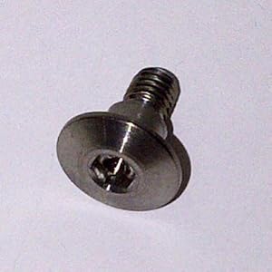

Honda fairing bolts sometimes have a non threaded shoulder to prevent damage to the plastic.
If you get aftermarket then you can duplicate this using a sleeve of copper or rigid plastic (shoulder washers).
e.g.
Original Honda...
https://ecx.images-amazon.com/images/I/41MoKGAnuYL._SL500_AA300_.jpg
...and aftermarket fix...
https://www.easyfairings.com/media/catalog/product/cache/1/image/9df78eab33525d08d6e5fb8d27136e95/b/l/black_bolt_kit_sbk_ef_gallary_3.jpg
Although I have found Honda use 5mm hex allen key size and aftermarket ones are frequently 4mm.

Err, sorry to be bearer of bad news but I think you need to look again.
For the part number you gave, 90112MC7000
Enter in David Silver site £2.65 plus £1.95postage = £5.52 inc VAT. (click here).
That's for a part that they say special order.
That probably means is they have to get it from a Honda dealer.
Part info and image is on cmsnl if you click here.
If you can get to the Lings Honda site have a look for it on there.
What size is that screw/bolt, does it have the shoulder collar? I ask as it looks like the 5mm hex version from the Blackbird may fit. Look at part # 90112-MAT-000. Size is 6X16.
https://www.davidsilverspares.co.uk/graphics/parts/90112MAT000.jpg
https://www.davidsilverspares.co.uk/graphics/parts/90112MAT000_1_thumb.jpgclick on images for David Silver link
I mention as I find the Philips type used by Honda to be like cheese and disintegrate. The hex allen ones hold up well.
If you need a Philips/X-head then part # 83641-KY6-000 is the same size/match as the 90112-MAT-000 - see pic on cmsnl here.
