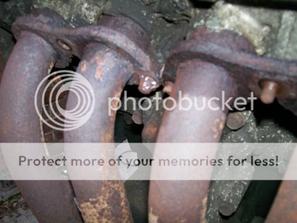

so something more like this then illuminate?
https://i450.photobucket.com/albums/qq223/jeffa/cbr600fmpart2056.jpg

Aaaaaanway. Have you started feeding in PlusGas or another release agent (not WD40)?
How seized are we talking here? If your butler is trying to get them out with a regular weeny allen key, forget it. Get him to try an allen bit on a 3/8" or 1/2" socket, or get some grips or a length of pipe onto a key.
The other thing to try is get the under footman to give the bolts a good smack, towards the engine. It probably won't free them up, but it'll make you feel all manly, by proxy.
