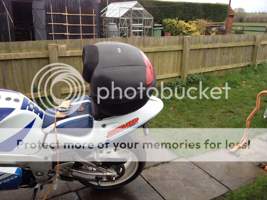

I bought a battered pillion seat via ebay and drilled straight through it, bolted mounting plate on with big bolts and repair washers.
https://i370.photobucket.com/albums/oo141/bramble43/46440069-A512-459C-92A6-C86E52C57C06-4123-000003E23909D68B.jpg

PostPosted: 12:43 - 04 Dec 2012    Post subject: Reply with quote
This is a seriously good idea. I'm going to try and find an old pillion seat.
