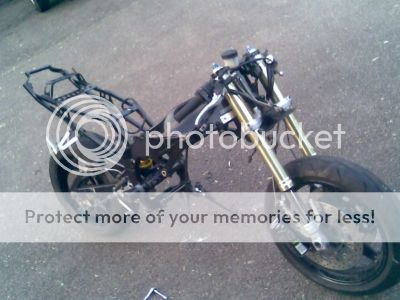

here's a few pics from the start (as it was the water pump that failed it was a strip down that iv got way to anal with Question )

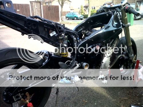

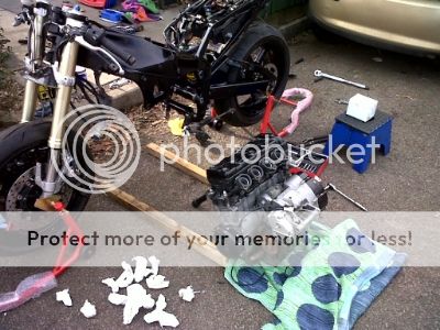

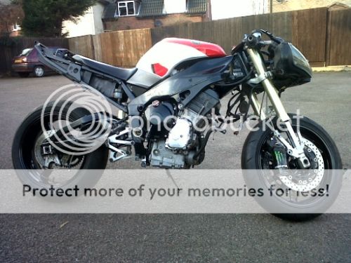

first the bike was completely stripped and the water pump replaced, i also re ground the valves and replaced the head gasket as it was down on compression, blasted and powder coated the wheels and rear swing arm, stripped all the electrics out and cleaned up the frame and suspension. the brakes were pretty good so i just too the calipers off and gave a good clean off the bike,
https://i1287.photobucket.com/albums/a637/chris9811/3bf36070-ab6e-414e-ae27-26c97399e98b_zps7e95b36d.jpg
putting the engine back in and electrics, wheels and swingarm re powder coated at this stage Very Happy

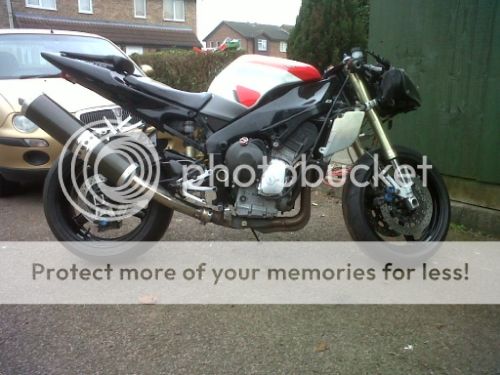

after an absolute mare with the exup, the exhaust was on and the rad and all the gubbings were cleaned and re fitted, new pads front and back, calipers re fitted and brakes bled Smile
https://i1287.photobucket.com/albums/a637/chris9811/87a3189c-06df-4b8f-8080-3ff744f92057_zps148a315d.jpg

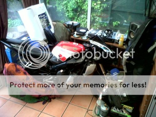

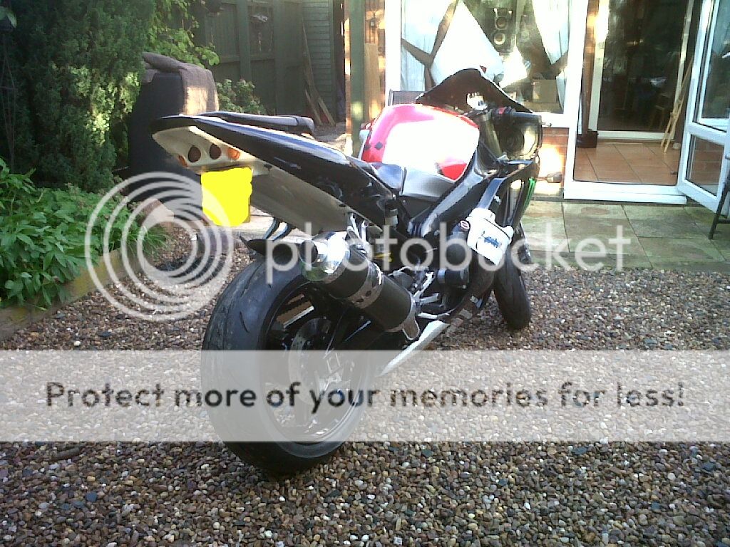

spent some time in the house (dont ask how i got away with that, i still dont know to this day lol), while it was it had a new chain and sprockets a very good second hand rear set, a pair of leavers and i cut the standard can down (highly recommended, looks and sounds great and not over the top noise wise Thumbs Up)
https://i1287.photobucket.com/albums/a637/chris9811/8696dcc6-fb8d-4c8f-a95a-d28aeba0f997_zps292d6e74.jpg
nearly there now Wink

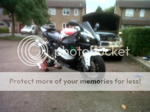

fairings on now, all the electrics sorted and the engine running like new,
https://i1287.photobucket.com/albums/a637/chris9811/c5f701e0-c049-48e9-96d7-ef3d4915f9d2_zps39fb5fe6.jpg
https://i1287.photobucket.com/albums/a637/chris9811/35f3d51a-23a1-47d7-953d-d6fbd464ac1a_zpsc6741f38.jpg

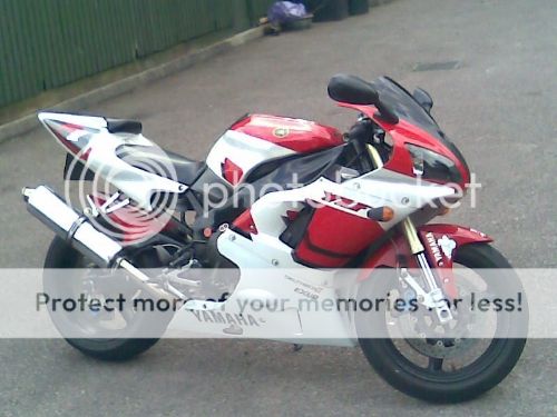

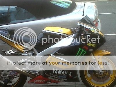

no doubt iv missed loads but now its time to paint the tank and im split on what to do with it, i could do it black or try something like this but white instead of yellow
https://i1287.photobucket.com/albums/a637/chris9811/614d2812-1367-4eb0-a56a-55496307979d_zps38a05e92.jpg
will have to point out that these are just cheep jap fairings so this wont be for more than a few years (fingers crossed),
hopefully it will eventually be back as it was but with a matching belly pan Very Happy
https://i1287.photobucket.com/albums/a637/chris9811/84754cfa-2664-4c10-836a-537ab11d6823_zps03134fa3.jpg
so what do you guys think about the tank and do you think i should keep the white undertray or go black with it? apoligies for the massive first post Thumbs Up
