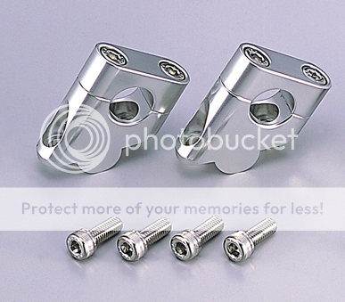

While searching for handlebars online, I found this set back bar riser.
I've decided to go for this one and ordered.
This seems to be minimum risk and enough effect.
I really appreciate your advices. Thumbs Up

Is there no room on the bars for chopping them down? I find its always best to go for small adjustments at a time.

Good choice, they look smart too Thumbs Up
You can easily fit different shaped bars quite cheaply later.

Joe f, thanks for your tip Thumbs Up There's enough room on the bar.
I will check if I can borrow a tool to cut it.
