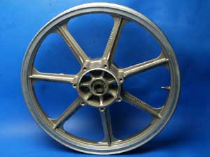

https://www.stotfoldengineers.co.uk/wp-content/uploads/2012/10/Astralites07.jpg
This was THE must have drool-worthy race accessory of the 1970's / 80's. The wheel was alloy, and made in a similar manner to the wire spoke wheel, in having a seperate rim, and hub, but instead of being laced together with triangulated wire spokes in tension, they were connected by alloy plates in compression.
Lighter than a wire spoked wheel, and many cast alloy wheels, they were 'almost' as strong, curtecy of triangulation and section, and certainly 'strong enough' for race aplications.
BUT, big advantage was that the seperate components, the hub, rim and spokes could be manufactured by different methods, and in different grades of material. The hub commonly cast, the rum, probably extruded, the plates from rolled sheet, or possibly even 'spun' basically moulded on a lathe, the metal 'spun' out from maybe a 4" billet, and moulded to shape with iron shaping tools pushed into the soft metal as centrifugal forces stretched it to final diameter.
With joints between rim and spoke and spoke and hub, the construction was said to offer the 'complience' of a wire spoke wheel, against cyclic fatigue and shock loading, and be less susceptible to cracking or fracturing.
This was the thinking behind Honda's original plate 'Com-Star" wheels of the mid 70's on.
https://images.canadianlisted.com/nlarge/honda-front-end-parts-and-comstar-wheel_5623992.jpg

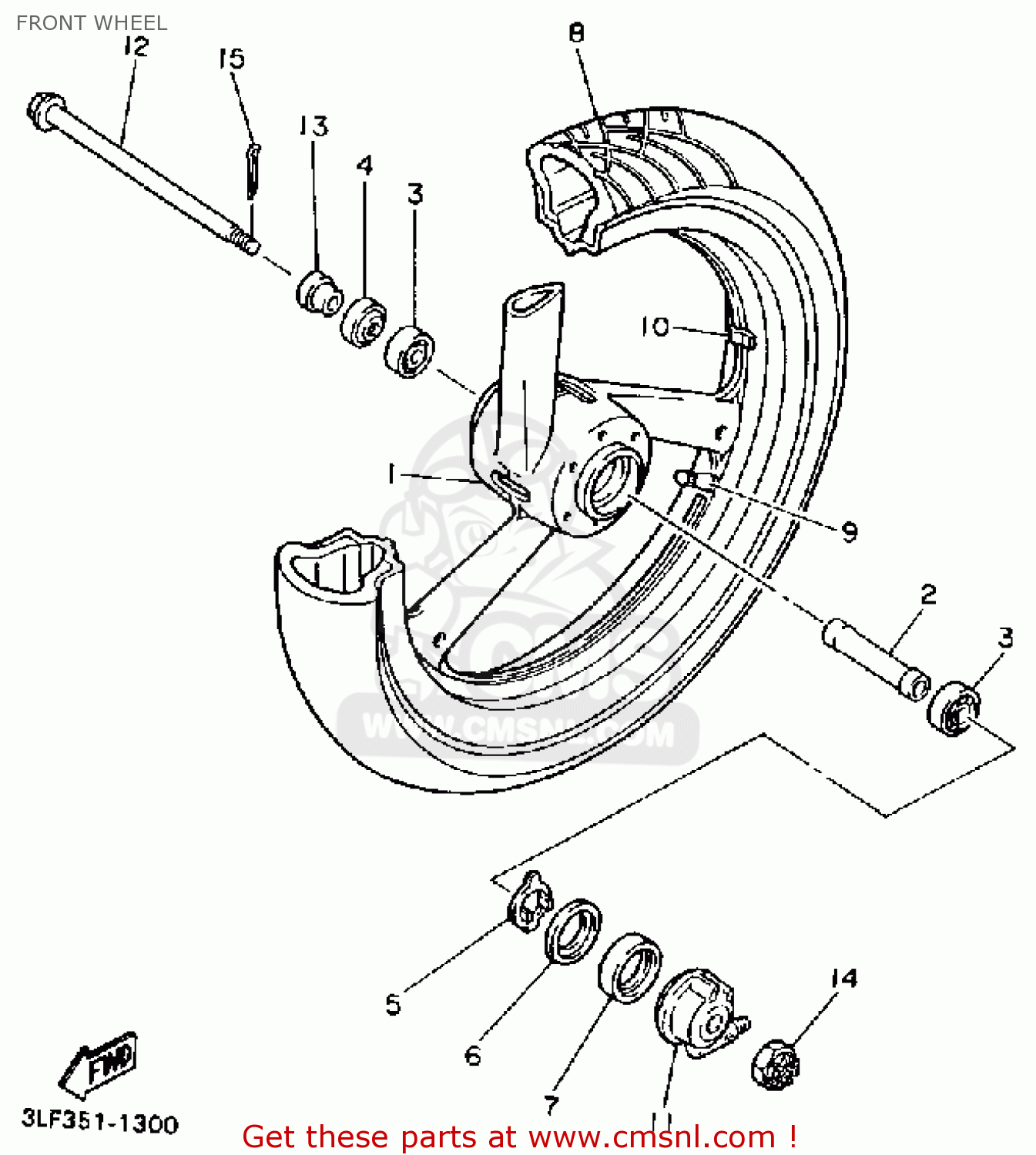

Mid eighties, and we get to the now common 'hollow' three spoke.
https://images.cmsnl.com/img/partslists/yamaha-fzr1000bc-1991-front-wheel_bigyau1141f-7_e8a1.gif
Black & white pic, becouse factory scematic nicely shows the hollow spoke section.
Right, pioneered by I believe Marchesanis? And used on racing Bimota's with whome Yamaha had close technical relationship at the time; the hollow section cast alloy wheel, was a clever solution to many of the problems of the cast wheel.
To make a wheel stronger meant thicker spokes or more spokes. Both made the wheel heavier. Dymag in the UK were renouned for making some of the strongest-lightest magnesium wheels, but they did it by having deep girdered spokes, very carefully pressure 'Die' cast, demanding expensive tooling and very slow manufacturing cycle time, as the wheel had to be controll colled in the mould before it could be ejected and another one made.
The Marchesanisi Holoow spoke wheel, achieved a very high stiffness from minimal metal, by making big thick spokes.... but hollowing them out.... and as I understand, saved such expensive manufacturing costs by using a 'lost wax' process, so a slightly more refined version of simple gravity sand casting. Great for keeping low volume costs down, but not so great for making large volumes of wheels cheaply.
That was the task that Yamaha set to solving, 'productionising' the hollow spoke cast wheel, and I think they did it with a low-pressure die cast system.
And that is where we are at now. Materials technology and manufacturing technology basically being refined to minimise the problems of the cast wheel; softer more maleable alloy compositions helping avoid cyclic fatigue fracture and structural engineerig tackling the weight-strength issue....
BUT aided by the other trends LIKE the vogue towards smaller wheels, and wider tyres, that allow wider spoke structures, and reduce bending moments.
