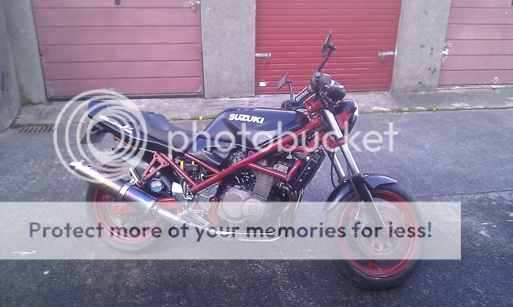

Basically looking to build some form of crash bar for my bike.
It fell over a while back when parked on a hill badly Embarassed and the first thing that hit the ground was the engine casing. It cracked it.
I will be riding the bike all winter and if we get adverse weather down here, I dont fancy dropping it and smashing the casings. I'm not so concerned about going down, more about how badly it damages the bike. Levers and such are to be expected.
Best angle I can find of my bike:
https://i1126.photobucket.com/albums/l618/HDrayton7/IMAG0628.jpg
So cheaply and quickly, what can I build as crash bars or sliders to protect the engine casings? Ideally, I can 'borrow' the materials from school which means I have access to different bits and bobs and machines.

Most bikes with crash bars have the frame running above and below the engine whereas this engine is mounted below the frame, thats the issue I am having. Just after any design solutions.
R&G and the like don't do anything. I did once see bungs that come from the top right (in this photo) engine mount. I could buy some nylon or similar and turn it down and then buy some longer bolts I guess?
