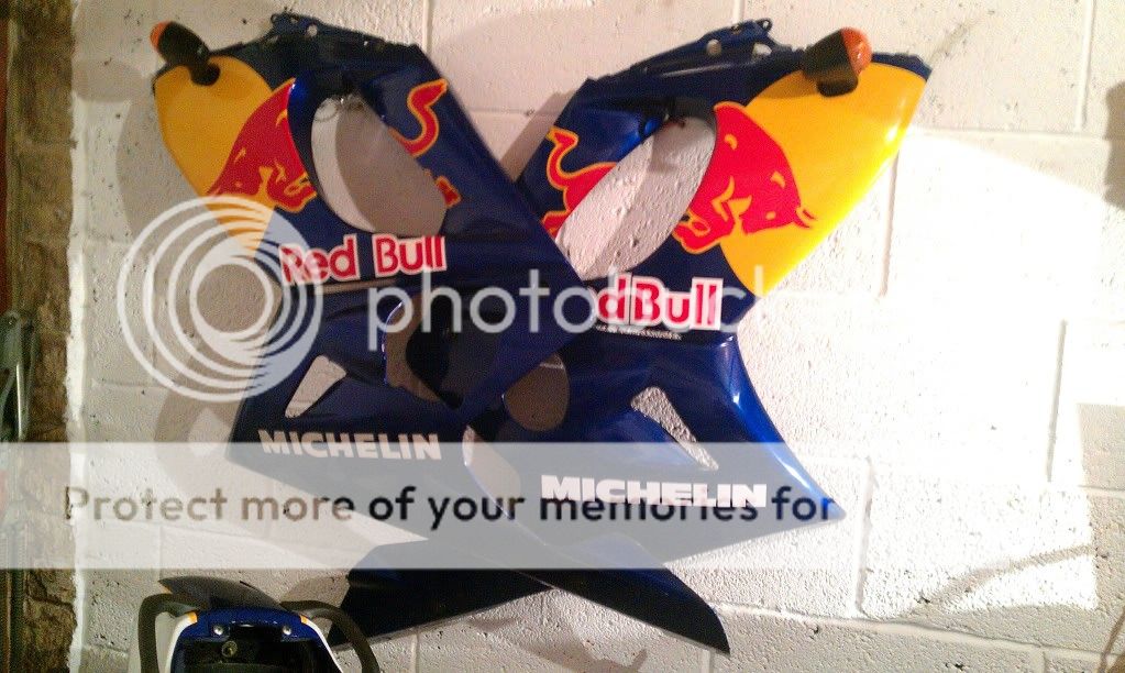

Popped the fairings into a safe place
https://i267.photobucket.com/albums/ii302/ian505050/ian505050%202/IMAG2263.jpg

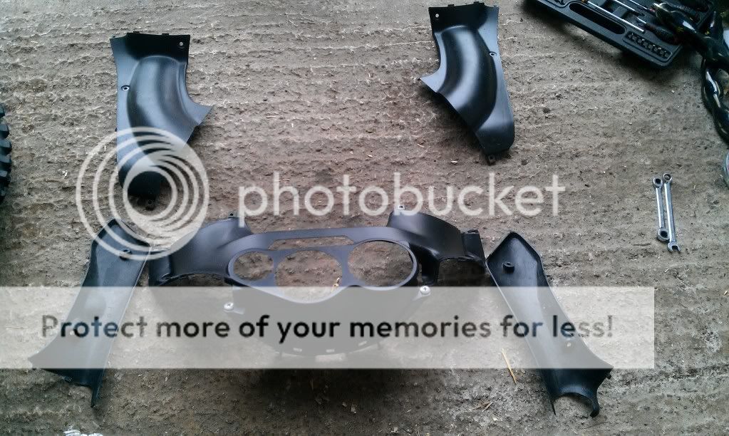

Then decided to remove the front fairing to have a nosey, just plenty of cobwebs
https://i267.photobucket.com/albums/ii302/ian505050/ian505050%202/IMAG2403.jpg

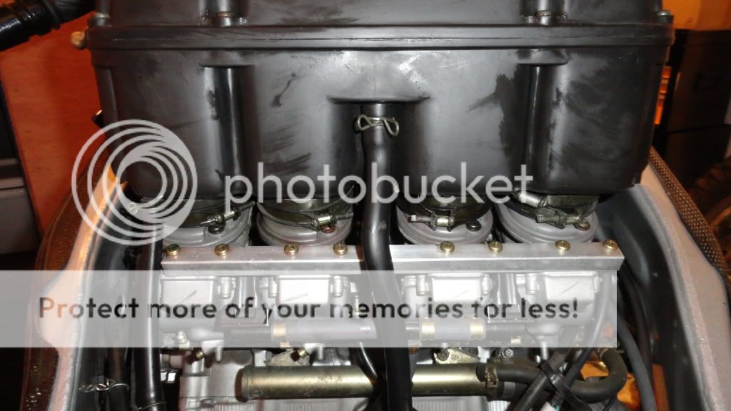

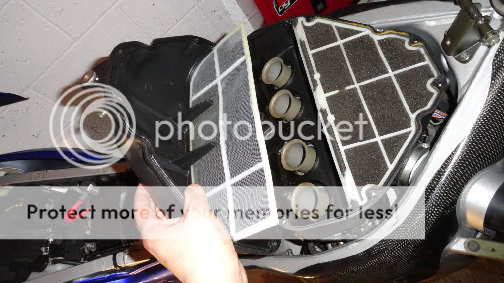

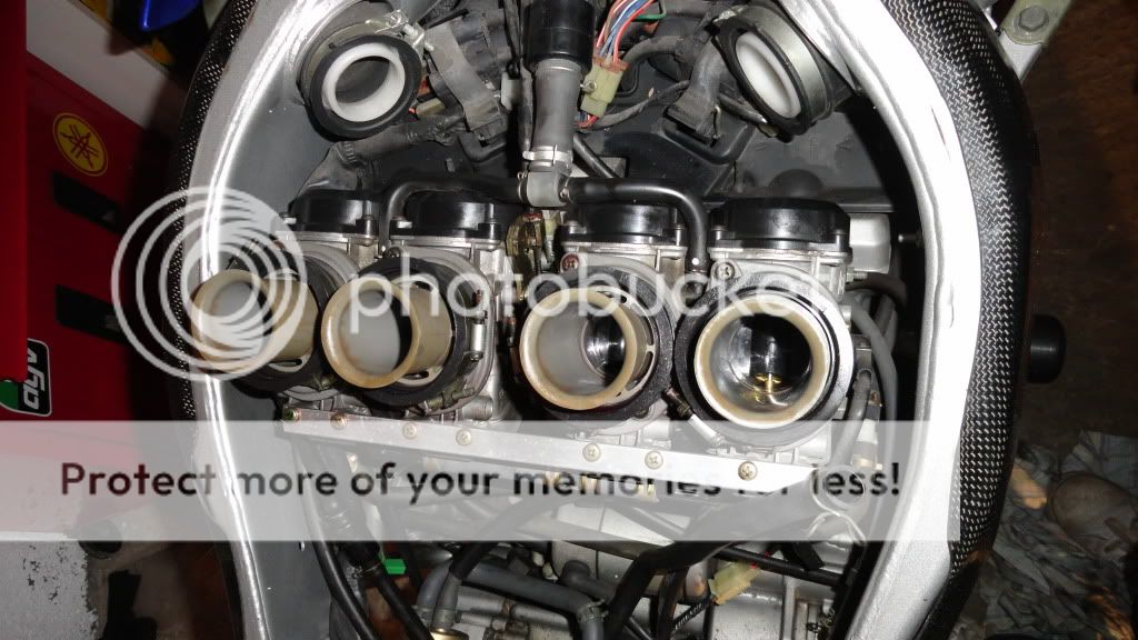

Then next i removed the air filter which was a little dirty and had become quite thin and frail
https://i267.photobucket.com/albums/ii302/ian505050/ian505050%202/DSC00539.jpg
Then i decided to spray some easy start in the carb and this got it running again after fully re-chargeing the battery.
https://i267.photobucket.com/albums/ii302/ian505050/ian505050%202/DSC00530.jpg
It ran for 2 minutes and cut out again and would not start, i put some more easy start and it struggled to start but got it running again. I decided to run some redex directly into the carb, 50mm in each intake and after repeating this a few times the bike started to run a lot better.

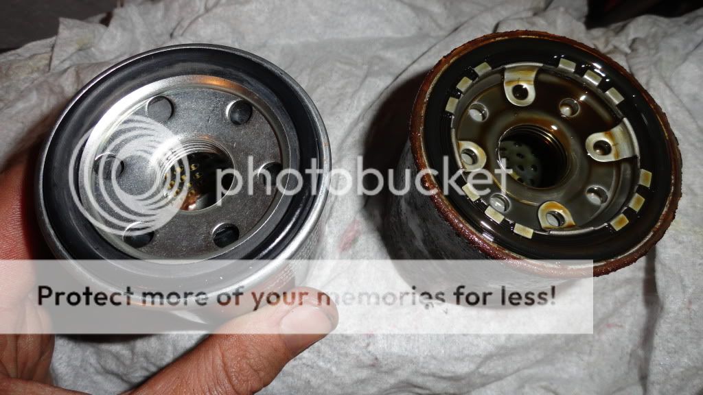

Next i decided to do a full service now it was at least running.
I replaced:-
Engine oil, oil filter, air filter, fuel filter, engine coolant, spark plugs, brake fluid, brake pads front and rear, brake piston seals, brake levers(spazzo).
Before and after
https://i267.photobucket.com/albums/ii302/ian505050/ian505050%202/DSC00551.jpg

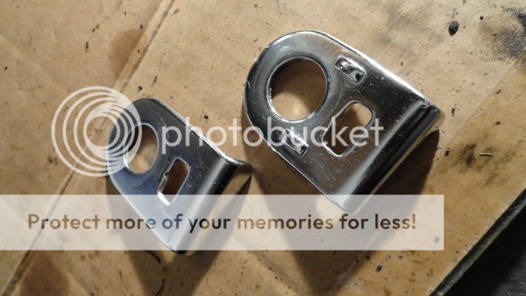

I gave these bits a taste of autosol, they were orange with rust before i started
https://i267.photobucket.com/albums/ii302/ian505050/ian505050%202/DSC00558.jpg

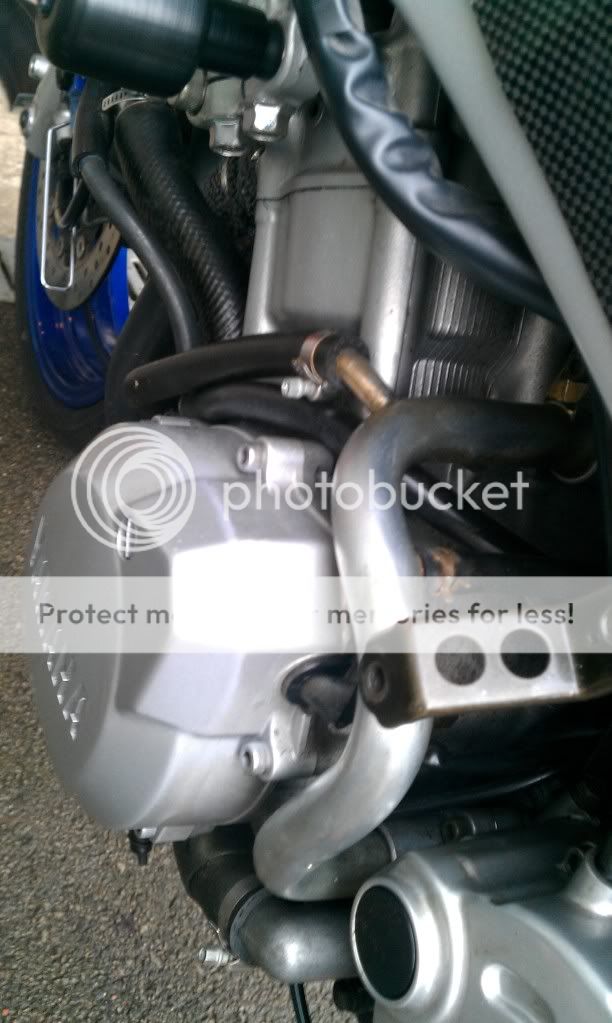

Then i noticed that one of the down pipes was not heating up, and found that one of the spark plugs leads was not correctly connected. After plugging it in correctly all down pipes seemed to reach the same temperature when running.
Then got the autosol out on the end can
https://i267.photobucket.com/albums/ii302/ian505050/ian505050%202/IMAG2410.jpg

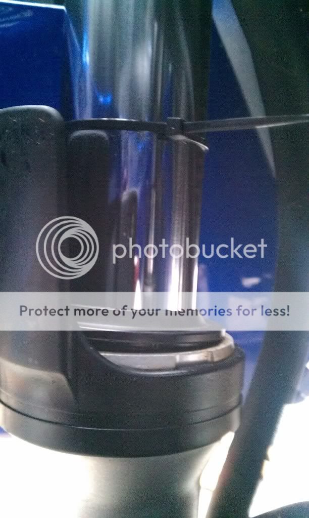

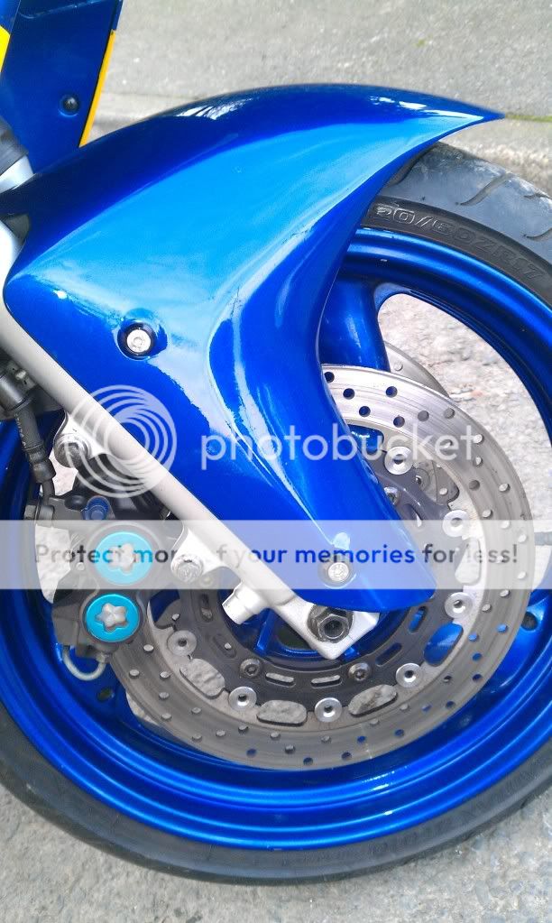

Then studdied a few youtube videos to work out how to set the suspension up correctly for my 12.5 stone ass.
Cable ties came in handy for taking measurements
https://i267.photobucket.com/albums/ii302/ian505050/ian505050%202/IMAG2413.jpg
Finally i was happy with the bike and put all the bodywork back on. When i put the bodywork back on i gave it a misting of wd40 and left the bike for a week. The wd40 seems to clean all the crap off the bodywork better that anything else i have tried.

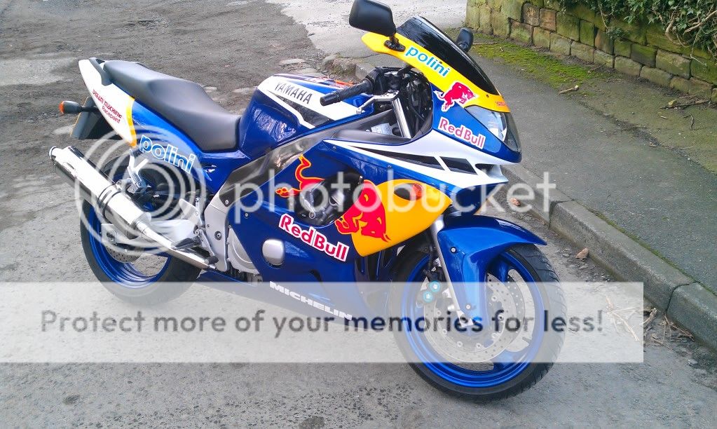

Decided to take a few snaps on the was home Very Happy Such a good feeling when all the hard work comes together and i now have a bike that should run all summer issue free.

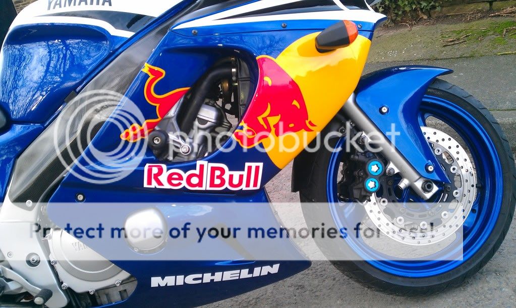

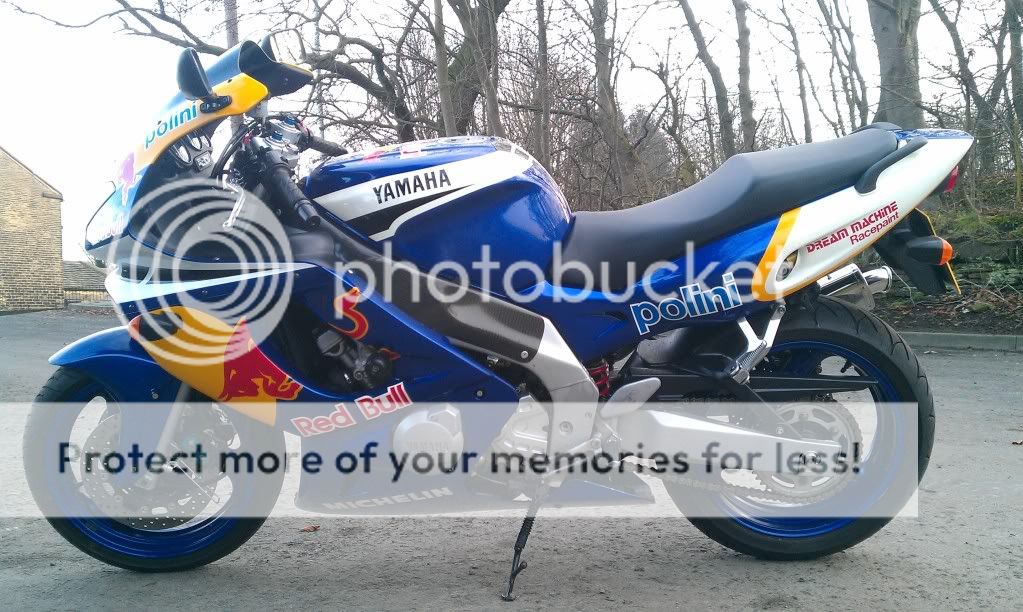

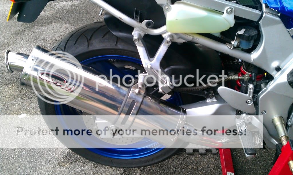

R/H side
https://i267.photobucket.com/albums/ii302/ian505050/ian505050%202/IMAG2444.jpg
https://i267.photobucket.com/albums/ii302/ian505050/ian505050%202/IMAG2446.jpg
https://i267.photobucket.com/albums/ii302/ian505050/ian505050%202/IMAG2447.jpg

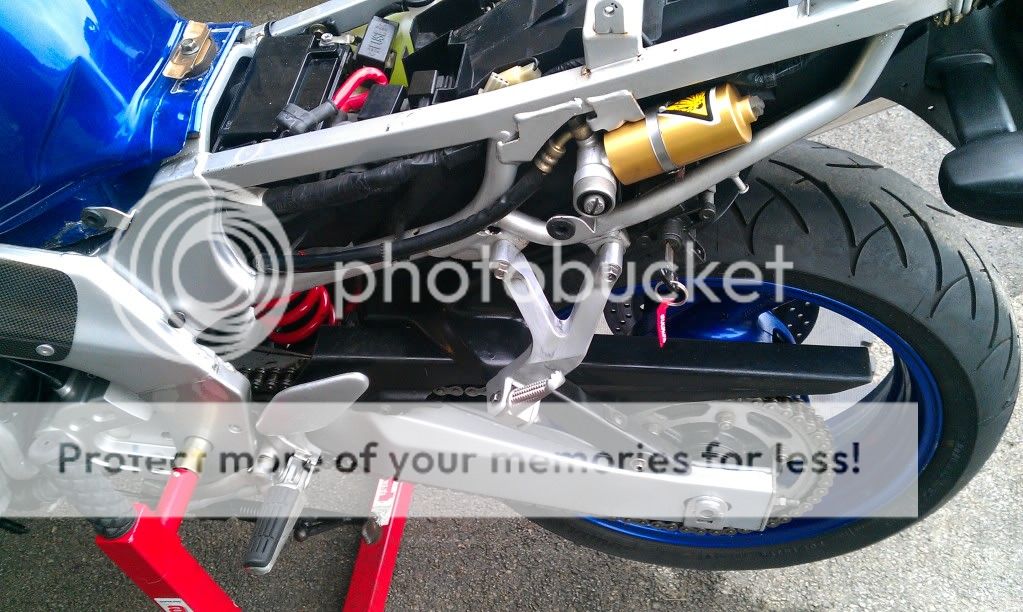

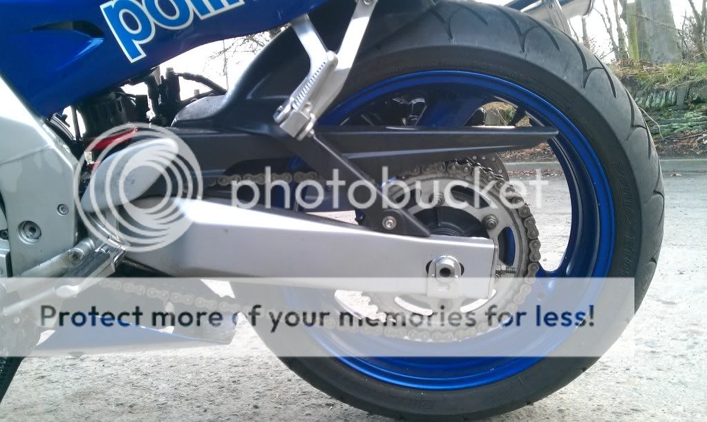

Chain and sprocket nice and clean
https://i267.photobucket.com/albums/ii302/ian505050/ian505050%202/IMAG2451.jpg

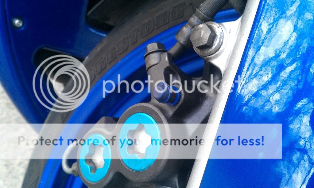

blue bleed nipples because i am a sad cunt

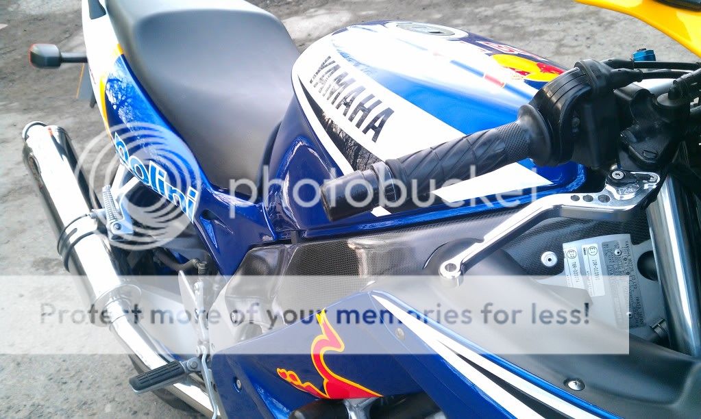

https://i267.photobucket.com/albums/ii302/ian505050/ian505050%202/IMAG2458.jpg
spazzo levers £17 a set!!!!!!!
https://i267.photobucket.com/albums/ii302/ian505050/ian505050%202/IMAG2456.jpg

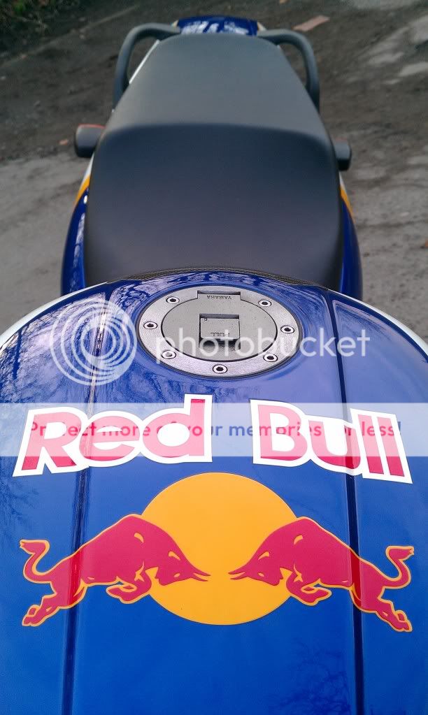

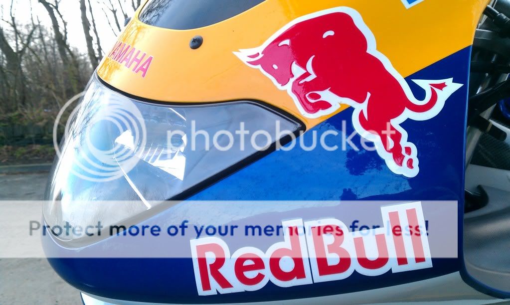

Tank view(awaiting racing fuel cap)
https://i267.photobucket.com/albums/ii302/ian505050/ian505050%202/IMAG2462.jpg

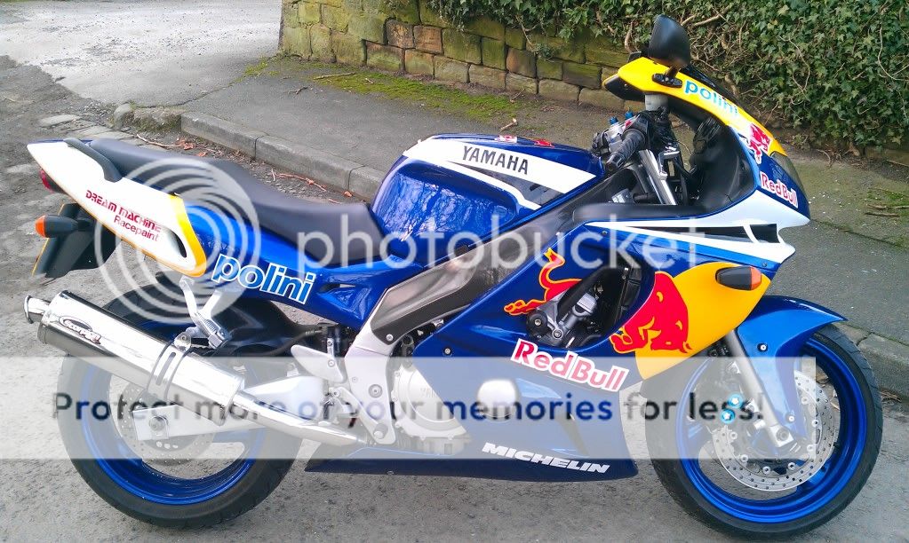

L/H side
https://i267.photobucket.com/albums/ii302/ian505050/ian505050%202/IMAG2450.jpg
https://i267.photobucket.com/albums/ii302/ian505050/ian505050%202/IMAG2455.jpg
https://i267.photobucket.com/albums/ii302/ian505050/ian505050%202/IMAG2464.jpg
https://i267.photobucket.com/albums/ii302/ian505050/ian505050%202/IMAG2443.jpg

That fork dust seal doesn't look seated properly xD

Very nice! Very Happy
meh, MOT tester missed it anyway and thats all that matters, hahah.
Its only the dust seal anyway Thumbs Up
Rigga
Joined: 29 Nov 2012
PostPosted: 21:33 - 12 Jan 2013    Post subject: Reply with quote
Gorgeous although i think those wheels would look better in gold!
ian505050
Joined: 27 Oct 2010
PostPosted: 21:37 - 12 Jan 2013    Post subject: Reply with quote
nar..... Gold would look crap, the only other colors i might consider are white
or
rear red and front yellow to match the redbull logo.

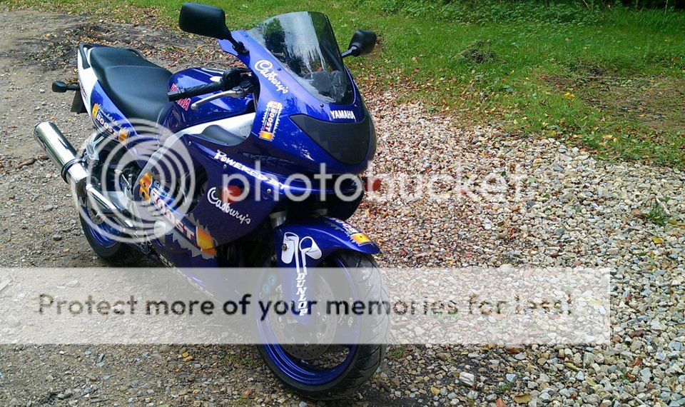

I like them too, thats why i bought this redbull one to replace my purple one
https://i267.photobucket.com/albums/ii302/ian505050/ian505050%202/380102_10151234724114414_881300903_n.jpg

That looks like a real nice quality paintjob, makes a change.
Lovely bike, jealous Evil or Very Mad
ian505050
Joined: 27 Oct 2010
PostPosted: 22:00 - 12 Jan 2013    Post subject: Reply with quote
the scheme is good, but the actual quality of the paint is brilliant, very thick paint and bright colour.

Looks awesome but on 2nd visit to the thread, I've spotted the Michelin stickers are different on each side Neutral
Edit- the two sides are totally different red bull logo and lettering too.
PostPosted: 01:51 - 13 Jan 2013    Post subject: Reply with quote
Thinking indeed... that would piss me off no end.
You won't be saying that when the oil seal corrodes to the slider and you can't split the forks Laughing

For the sake of a few minutes work, I'd seat that dust seal properly, it'll be beneficial in the long run. You can do it just using something soft against the sal and knock it into place.
I did mine with my bare hands + brute force, although it did take a few months for the resulting bruised nerve in my thumb to heal and restore feeling to my thumb tip. Rolling Eyes

##Paddy## wrote:
Prety sure its impossible to spot now the bodywork is fitted to the bike Middle Finger
I tried bare hand followed by a metal pole along side the fork and a mallet but this did not work. Maybe a bit of plastic wrapped round the fork leg and a few knocks. Would WD40 help? I would have thought that i should keep wd40 away from the fork seals.
Flatbadger
Joined: 07 Apr 2012
PostPosted: 11:43 - 13 Jan 2013    Post subject: Reply with quote
Get Red Bull to chip in - lovely bike but why all the stickers?
