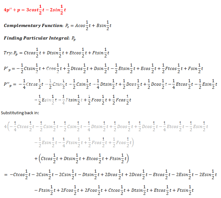

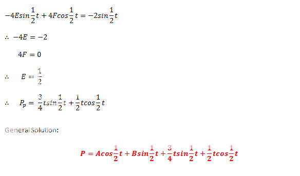

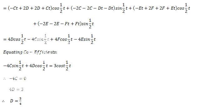

Firstly, could someone confirm I have got the correct answer please?
It's a 2nd Order Differential Equation with Resonance.
https://i300.photobucket.com/albums/nn6/ElScampio/BCFmaths1_zpsed1d87d0.png
https://i300.photobucket.com/albums/nn6/ElScampio/BCFmaths2_zps41b148e4.png
https://i300.photobucket.com/albums/nn6/ElScampio/BCFmaths3_zps86570270.png

Secondly, can Matlab solve forced 2nd ODE's? If so, what do you input?
