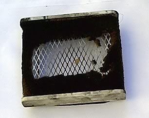

Don't try to reuse it too often though! Although I suspect this one was more a case of the previous owner never having looked at it since the bike was new (24k miles). Moral of the story, If you buy a bike that's "just been serviced", don't believe a word of it.

That looks in a similar condition to that my sub-air filter was in.
+1 to the "don't trust previous owner(s) to have done the servicing properly" idea!
