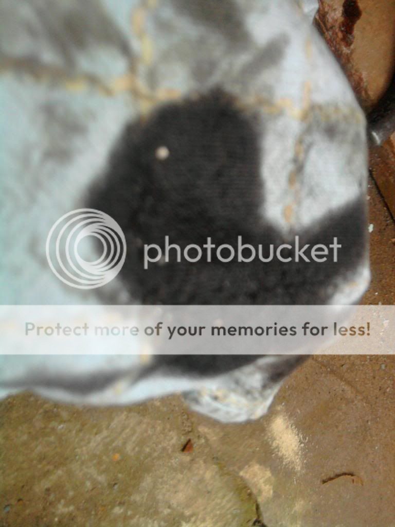

thanks for the reply's.. its still playing up .. today i done an oil change
https://i154.photobucket.com/albums/s267/jimbob005/Photo0025_zps5803d740.jpg
found some shiny bits in the oil
how bad is this?
thanks james
