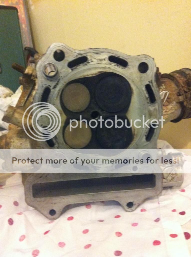

My Drz stopped working about three months ago, but have only just had time to take the top end off. It just wouldn't start. Sent it to a garage and they said they wanted £500 to sort it out. Didn't have that sort of cash so am trying to do it myself.
This is my first time doing any sort of engine work with the most basic set of tools.
Having dismantled the top end... I am now stuck, not really sure what I am looking for or where to go from here.
Below are some pictures of what I have found.
Any help/advise/next steps would be greatly appreciated!

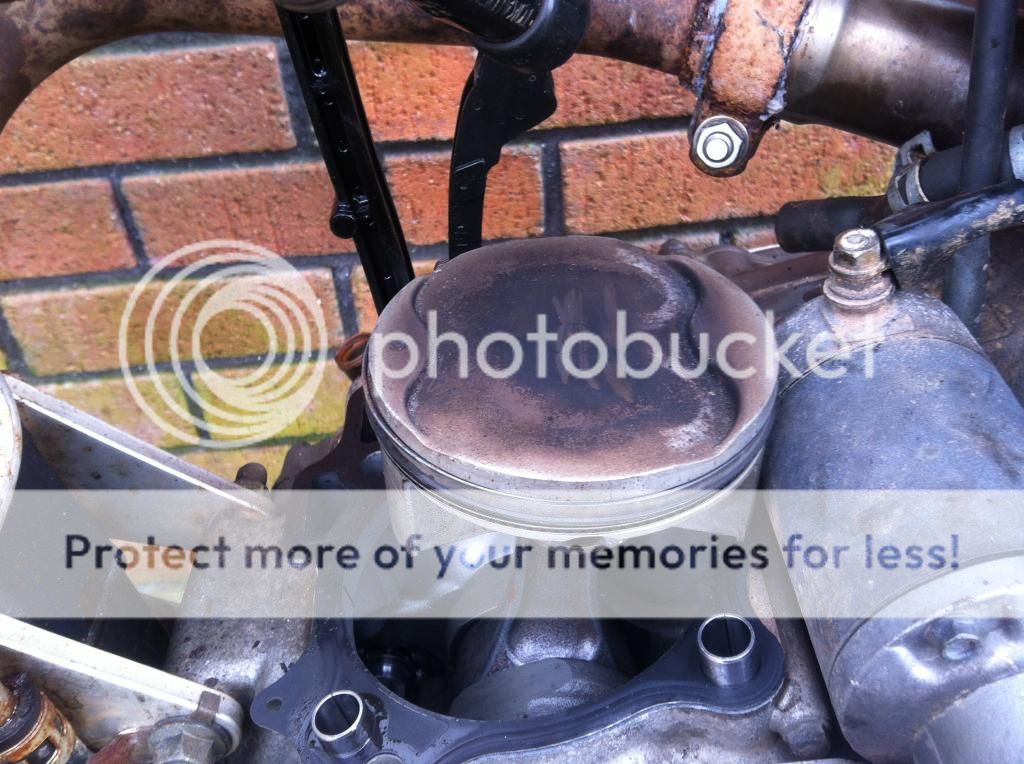

The piston needs decoking I think - how would I go about this?

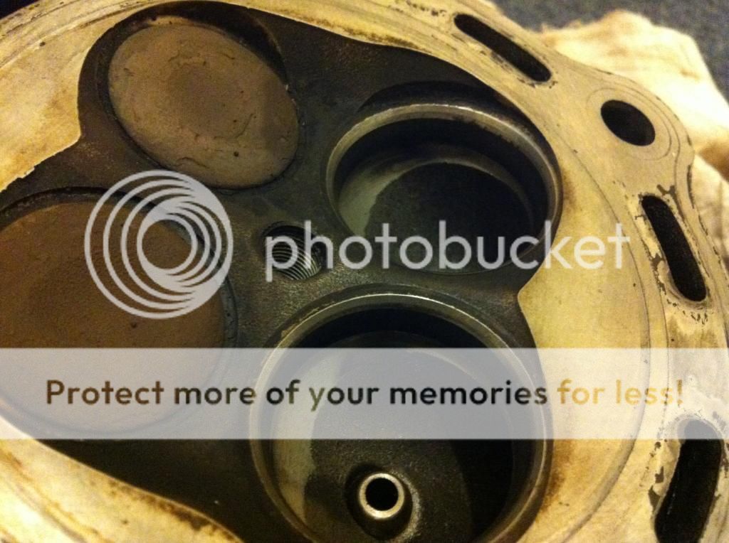

Also, the IN valves have clearly hit the piston, but it doesn't appear to have left any lasting marks (once cleaned up).
https://i460.photobucket.com/albums/qq322/UsernameTaken_01/Engine%20Troubles/photo2_zpse5202714.jpg
The valves - not sure what colour they are supposed to be. The EX valves are the chalky ones and the IN valves are covered in carbon.

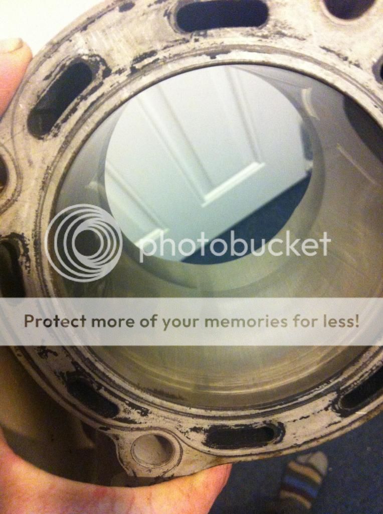

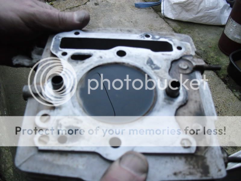

The barrel looks ok?

Not silly questions at all.To check to see if the inlet valves are bent,pour something like white spirit or parrafin into the combustion chamber and see if it flows away through leaking valve seats
https://i666.photobucket.com/albums/vv23/WiNot_Rhencullen/Workshop/CIMG2951.jpg
If the bike had been over-revved,it is quite likely that the valves are bent.
As the inlet valves are black,this could be oil or a rich mixture.Check the end gap of the piston rings within the bore and if the valve guide seals have perished.

The garage basically said a new top end would be the cheapest option as the valves were pissing petrol.
I think I may have rode it with the choke on (stupid mistake and one that I haven't made in 5 years of riding) which would explain the blackened inlet valves?
'Check the end gap of the piston rings within the bore and if the valve guide seals have perished.'
What would this entail?

Take the piston rings off the piston,place them within the bore,square them within the bore using the loose piston and measure the gap between the ends of the rings.If they are over a specified limit,or even close to,then hone the bore and install new rings.
If the inlet valves are damaged,they are normally cheaper than the exhaust items.You might get away with just lapping in the new valves and check for leaks again.But if the valve seats are pock-marked,then you might have to have the seats recut if grinding them in does not work.

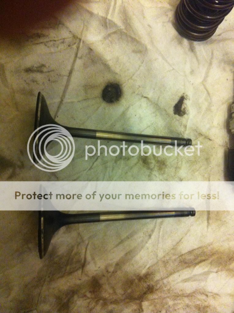

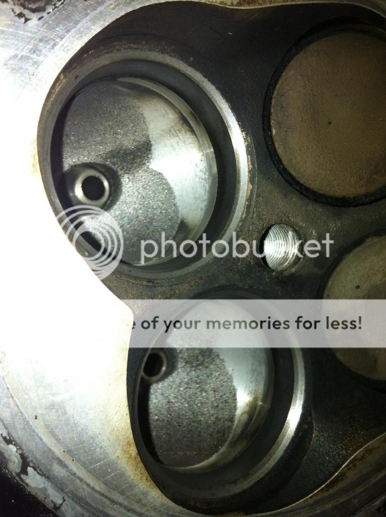

Ok, just managed to get the inlet valves out to have a look. They don't appear to be bent, go into the 'hole' with little resistance and don't feel as though they have any pitting...
But I could be completely wrong!

I'd be tempted to change the seals, etc. and lap those back in. I've seen far, far worse in running vehicles so I can't believe ones like that would stop your bike starting at all.

I'm with nexus. They don't look bad at all. Seen hell of a lot worse come out of running tractors. Personally I'd wap new piston and rings in. Change valve stem seals, lap valves in. Check for leakage. If they dont leak jobs a good un. Put back together and hope for teh best

As Nexus says, lap em in, new seals.

looks as though the inlet valaves may have been hitting the piston, no vlave clearance or minus valve clearance so open and stricking the piston??

those marks on the piston made by the inlet valves aint normall dudes, also fit valve springs the right way up.

Have just assumed that the marks on the piston are a combination of the bike running rich/carbon build up therefore making the piston/valves 'thicker' and hitting each other.

If the piston has hit the valves and they leak ....get new valves. No point pissin about with trying to lap them in etc. probs been caused by over reving at some point if it's the inlet valves only. As for the difference in colour between inlet and exhaust. They look ok. Inlet valves get cooled by the inlet charge and have a larger surface area to transmit the combustion heat to the head....whilst the poor exhaust valves get hotter as they get fried on both sides by hot exhaust gasses. Rings and piston look ok as no scores or blow by visible in the pics but whilst you have the motor out if you can spare the cash then fit new ones. Bikes like the drz give pistons a bit of a hard time so always a good idea to replace whilst your in there.
