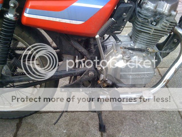

https://i435.photobucket.com/albums/qq79/connieboobie/IMG_5032.jpg
That's all that's left lol so pattern part will be ok for a year or 2 off eBay ? Although some only have 1 bolt.hole not 2 like mine
My first bike was a CG, exactly the same model as yours, can't remember, might have been a J reg. Good little bike to start out on though!
