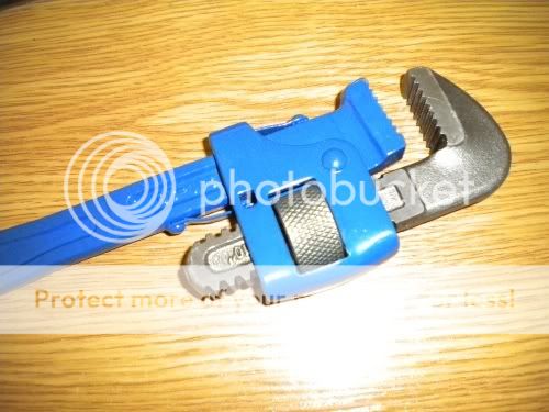

If it's rounded off then replace it. My favourite tool for rounded off bolts is this...
https://i244.photobucket.com/albums/gg19/Mordoklej/Random/pipewrench.jpg
It will chew into the bolt no matter how f00ked it is.

Yes the Stilson plumber's wrenches are very good, but I think they might a bit too bulky for this. They are a bit sloppy and it depends on how much of the bolt head is exposed. Maybe a small wrench plus a piece of pipe to extend it.
