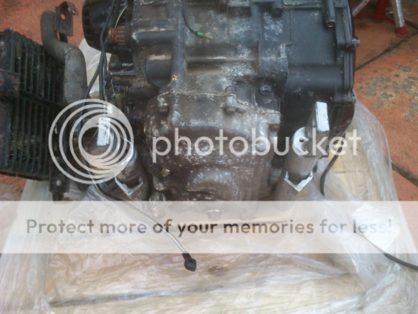

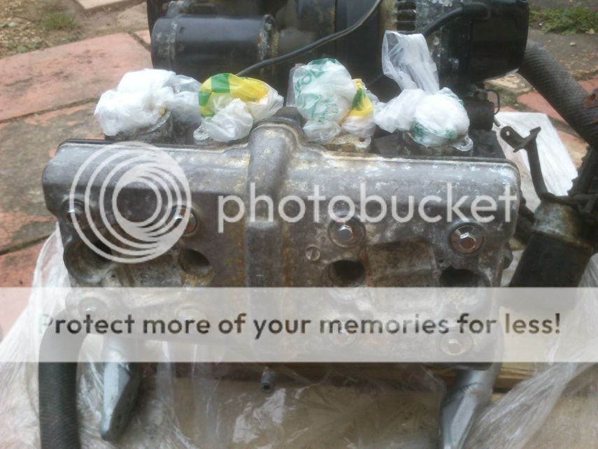

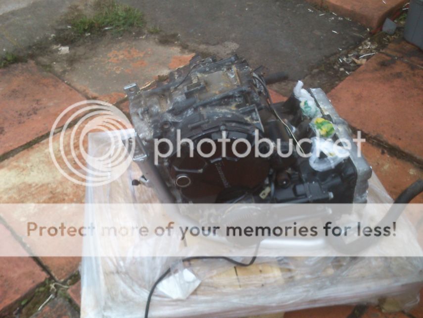

OK I decided to get the pictures uploaded.... it ain't pretty:
https://img.photobucket.com/albums/v320/andy36586/nEngine04_zps0f330384.jpg
https://img.photobucket.com/albums/v320/andy36586/nEngine03_zps6a0a2e42.jpg
https://img.photobucket.com/albums/v320/andy36586/nEngine02_zpsd396b16a.jpg
https://img.photobucket.com/albums/v320/andy36586/nEngine01_zpsb5d18a93.jpg
OK bit of a scrub up I thought.... I went to replace the carrier bags stuffed in the intake ports and found this (if it shows up well enough):

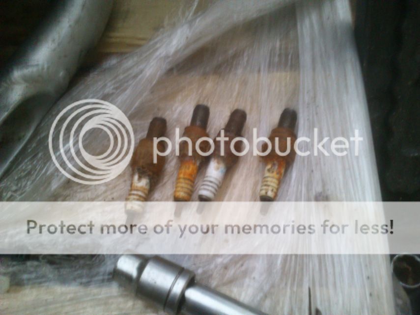

But I figured I would take the spark plugs out and see how they looked and:
https://img.photobucket.com/albums/v320/andy36586/Sparkplugs_zps92144b0c.jpg
On the plus side I took the valve cover off and it was proper smelling/looking oil that started dripping.
So is there any suggestions for cleaning the top end of the engine without stripping it down?

It's a grubby old thing that's definitely been standing outside for some time, looking at the sparkplug body's. It will probably clean up and paint quite nicely with some furious scrubbing and a few litres of de-greaser etc.
TBH it's always a big gamble with buying an unseen never heard running secondhand lump, especially a more expensive and complicated 4stroke multi. But there's always the chance it could look far worse than it runs, and that when you get it installed it could run much better than the old lump ever did. You have no real way of telling until it's in the bike though.
If you could rig up a battery to operate the starter motor with it standing on the floor, then at least you could do a compression test, which is the best way to give you some indication of if it's worth trying to clean up, and get running, without a partial strip down.
If not, then you have got to get it into the bike, and then do a compression test. But if your fitting an engine you probably only mean to do it once, so you'd be probably wanting to clean it up and paint it first. It's a good idea to check the valve clearances while you've got great access, and then at least you can inspect the cams for wear as well.
Once it's in the bike, id say bung in some new plugs, fit a new oil filter, and fill it with the cheapest fresh bike oil you can find. If it does start and seem to run well without smoke, funny noises etc, then id do a 100-150mile shake down run (a tank full of fuel), and then drop the oil have a look at what drains out, and change the filter again and fill it with some reasonable oil and see how you go.
There could be some common problems and things to look at with the new lump, and these might be, sticking or contaminated clutch plates, a corroded or silted up water pump, best to check that now, and oil leaks, water leaks, and gear selection problems etc. If none of these issues are present when you fire it up and run it up the road, then you have been savvy and bagged a sound motor. If your very unlucky with it, then id look at it as a potential organ donor for you original engine as a positive outlook.
Good luck with it, and don't forget to keep all your fingers crossed before you hit the button! Wink

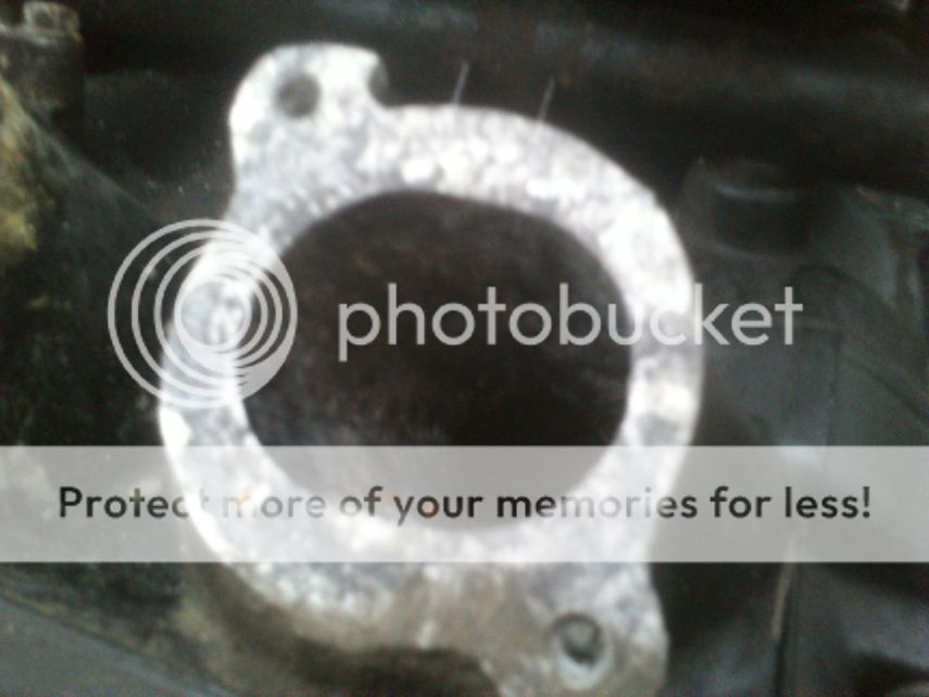

From what I can see they look black enough, but will check better tomorrow... what I did notice though:

Looking down those ports is painful, those valves are very crusty and the seats are probably as bad, its literally screaming "money pit" to get that lump singing like it ought to is not going to be cheap.
