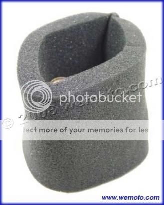

its a foam filter, looks very much like this...
https://i25.photobucket.com/albums/c81/mudcow007/ebd9_2_zps41fcf7fd.jpg
with this over the top of it
https://i25.photobucket.com/albums/c81/mudcow007/10002974_zps30b1c6e6.jpg

Does it run fine with the filter off?
If so, wash the oil off with washing up liquid.

Or, don't do that. Don't try to run it with the filter off.
Dab the filter with some kitchen roll to try to absorb the excess oil, then see if the bike runs better.

im guessing the filter is choking the engine
will try getting rid of more of the oil..failing that will replace the filter

That type of filter normally requires engine oil.
The K&N stuff is probably not suitable for that type of foam.

Joining MJ, Too much oil!
