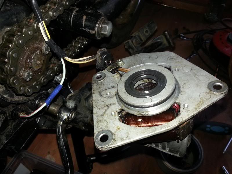

im trying to replace a seal on my CG genny plate thingy
https://i25.photobucket.com/albums/c81/mudcow007/20130316_170127_zps6de74261.jpg
(big round black thing on this pic)
any ideas how i can replace it (im guessing the new one will have to be driven in) without damaging the strator behind it?
to remove the old one can i just screw a screw into it an yank it out?
gracias

You should be able to carefully push it into place with your thumbs. It's not like a bearing, there's no great resistance, especially if you make sure the housing is greased before putting it in.
A large socket about the same size as the OD of the seal could be used as a drift, if it was necessary. But seals are easily damaged and you'd need to be very careful.
PostPosted: 15:42 - 25 Mar 2013    Post subject: Reply with quote
I'd probably just ping/lever the old one out with a big screwdriver then push the new one in with my thumbs.
If it won't push in, use the old one on top of it as a driver, or a bit of plastic water pipe the same size as the OD of the seal.

as you all said the old one just pinged out with a screwdriver an the new one just slipped in after being liberally greased
just hope the swine stops leaking now
thanks

Did you change the large ''O'' ring as well? If not then it would probably be a good idea to do so whilst you have everything apart.

God fecking dammit bastard fecking GAHAHAHAHAHAH
its still fooking leaking after replacing both seals
i'm getting fed up of this "bomb proof" bike Sad
anyone any ideas where it could be leaking from??

well...i refitted everything, refilled with oil.
kicked her over a few times - wouldn't start (i'm guessing because of the cold) an i noticed a dribble of oil through the flywheel
so im guessing if/ when it fires up the leak would get pretty messy
i will whip the flywheel off again an try to figure out where its leaking from
as radicalrabit says....is there a correct an wrong way for a seal to be fitted?
i fitted the new one as per the old one with the flat side facing out with the spring inside

The oil seal has been installed the wrong way around.
The ''spring'' side should be facing inwards towards the crank.
Pants!
really>?
so the seal in the pic above is incorrectly fitted too?
i will take it out tonight an try an switch it around
thanks raffles

If you scroll down to Chapter 6, page no. 94 then you will see a picture of how the oil seal should be mounted within the stator plate:-
https://cpi.shs.net.pl/files/Poradnik%20warsztatowy%20Honda%20CG125%20(Workshop%20Manual).pdf
BTW Unless the oil seal that you have already installed is a very loose fit then you will probably knacker it during removal.

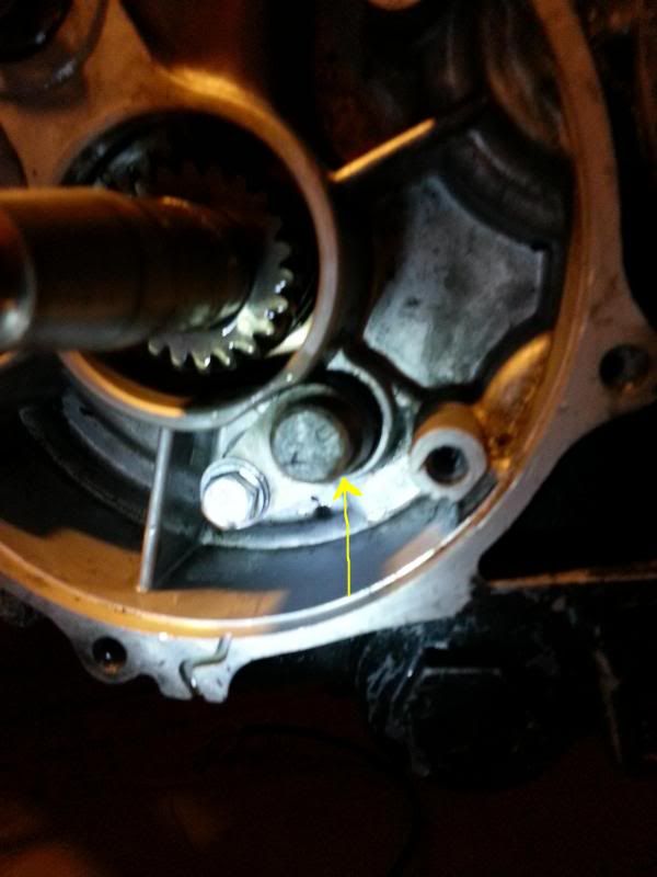

i think i may have found my leak....
after running the bike last night idling for about 10mins i noticed there was a bit of oil on the o-ring on the selector shaft (i think its called - yellow pointer in pic)
https://i25.photobucket.com/albums/c81/mudcow007/20130327_220114_zps7c707aa3.jpg
i think i will see how bad it leaks, as it looks a ball ache to start removing that
