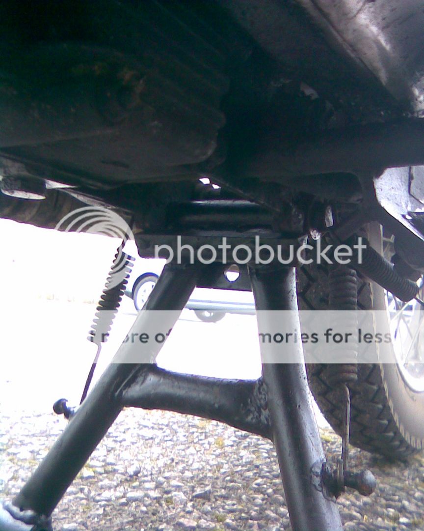

One of the down sides of having an RXS which has covered 417,000 miles is that bits you wouldn't normally expect to wear out...have worn out Laughing
The one which is a big concern for me and has been for a while is the frame - where the mainstand/rear brake pin passes through it. The holes are considerably enlarged now - I rarely use the mainstand now in a vain attempt at not making it any worse. Unfortunately I do still have to use the back brake Shocked
Has anyone else come across this issue? And can it be sorted in any way other than getting another frame, cutting that bit of it off and grafting it on to my frame (which I really don't want to do)?
When I use the back brake, the mainstand moves about four inches Shocked Never been mentioned at MOT time but it's getting to a point where it's more and more of a concern. Am hoping this doesn't spell the end of my RXS after 23 years of ownership.
Any advice/info/the like much appreciated.

The pin isn't supposed to turn - the stand and lever turn on the pin. What happens is the stand seizes on the pin and wears the hole out.
Just about anything is fixable. Just depends how much you want to spend. Hardest part I think will be dismantling it all.

I probably haven't been as thorough as I should have been keeping that pin greased up. But I'm fairly sure it's never turned significantly. I think the sheer number of times the bike has been put on the mainstand over the years is largely to blame - the hole is kind of oval.
I've considered boring the hole round again and using a fatter pin. Only flaw with this idea is that the end bit would need to be thinner to fit into the brake pedal (which I noticed recently now has a hole worn in it from tapping against the footrest about 47 billion times over the years Shocked ).
I will spend whatever it takes to keep the old fossil going. But I always try to do everything as inexpensively as possible on this bike as it seems to thrive on cheapskatery and bodgery. I was hoping to do something other than the above...as I have a nasty feeling I'd end up with a bigger and bigger hole until something unpleasant and terminal happened.

Problem with this is that the pin is just long enough as it is - there's a circlip on the brake end. Welding washers to the frame would mean I'd need a longer pin. I may be able to run something up...but it's never usually as simple as it sounds Confused

Build the holes up with weld and then file back to the correct shape.
Usual welding rule applies - the area needs to be spotlessly clean first, I would clean it up with a flap wheel and then give that part a dip in acid in a washing up bowl.
If there is any way of adding grease nipples for future lubrication, do it.

not if you welded the washers inboard of the frame tabs. Is there a sleeve running between them? If so it's a bit more involved

Get the pin out first - I'll be very surprised if you can without cutting it.

Building up with weld sounds like a good idea in theory. I'm just not sure how solid things are down there. I have this horrible thought of the frame just melting into large holes as soon as heat is applied, on account of the rust Confused
Pin comes out no bother. It's never seized. I do grease it up now and then. I've been keeping tabs on the progress of the wear for about seven years now, since I first noticed it.
There's no sleeve - just a pin that runs through the frame, through the mainstand and into the brake pedal, which it's held in place with a circlip.
Will have to throroughly clean up the frame round the mounts and see how sound it looks. Am hoping to make it to the 500K miles mark.

in that case do this
https://i49.tinypic.com/5nw40.jpg
yellow = pin, black = frame, silver = new sleeves
alternatively a pikey alternative you could just tack weld the pin in place, but then if you did need to grease it you'd need to grind back the welds.

Is it possible to ream the frame so that the oval holes are round but significantly bigger as suggested earlier in the topic?
If so, I'd do that and have a sleeve turned on a lathe so that the OD matches the reamed out hole and the ID is the same as a brand new frame.

If possible the simplest thing is fill the hole with weld and drill out to an interferance fit for the pin.
Fill and drill the parts which move around the pin to suit.
Fatter pins would probably be short term as maing the hole bigger may weaked the pivot. There is a lot of force on this part of the frame.
You may if, clever enough, be able to get a new pivot/lug made by a local engineer (talking a few quid for this) and have them remove the offending part and fit the new part. Slabber it with primer and paint then sit back in awe of your ingenuity. Cool

My concern about attempting to fill the holes with weld and redo them that way is that the frame might not take it. But if it worked, I'm guessing that would permanently solve the issue, especially given that the bike is unlikely to last another 26 years/400-odd K miles.
If the worst came to the worst, I would live without a mainstand and weld some kind of a stub on the right side of the frame for the brake pedal to mount on.

The tricky bit is getting the holes round again.
Once you've done that however, the solution is to make sure the stand turns on the pin and not the pin in the holes in the frame.
This is a common problem on enfields too which have a very similar setup. The solution with those is very simple. There is a split-pin through the end of the pivot which stops it pulling out. You replace this with a bicycle spoke which curls up and around the return spring mounting point. The pivot pin can no longer turn.
If yours is held in place with a circlip, you could replicate this by drilling a hole through the end of the pin and using a washer over it instead of the circlip with a pin to the outside of it through the hole.
https://i48.photobucket.com/albums/f216/stinkwheel/distributor/Image001.jpg
If you find the stand is kind of leaning forwards when the bike is on it and could do with being more vertical, it may be that the bump-stops have also worn away a fair bit. You can extend them by welding a bit of flatbar to them. Mine was originally the round bit, adding the flatbar on top give me a good inch more clearance under the tyre and made the bike infinately easier to get back off the stand, I was having to lift it up and over previously.
https://i48.photobucket.com/albums/f216/stinkwheel/distributor/Image000.jpg
OR
If you're really struggling with the holes. Cut a 1" bit of pipe in half down the middle to give you two c-shapes and weld it to the bottom of the stand legs to make them longer.
Remember though, if you don't do something about the pin rotating in the lugs, the holes will continue to oval.
