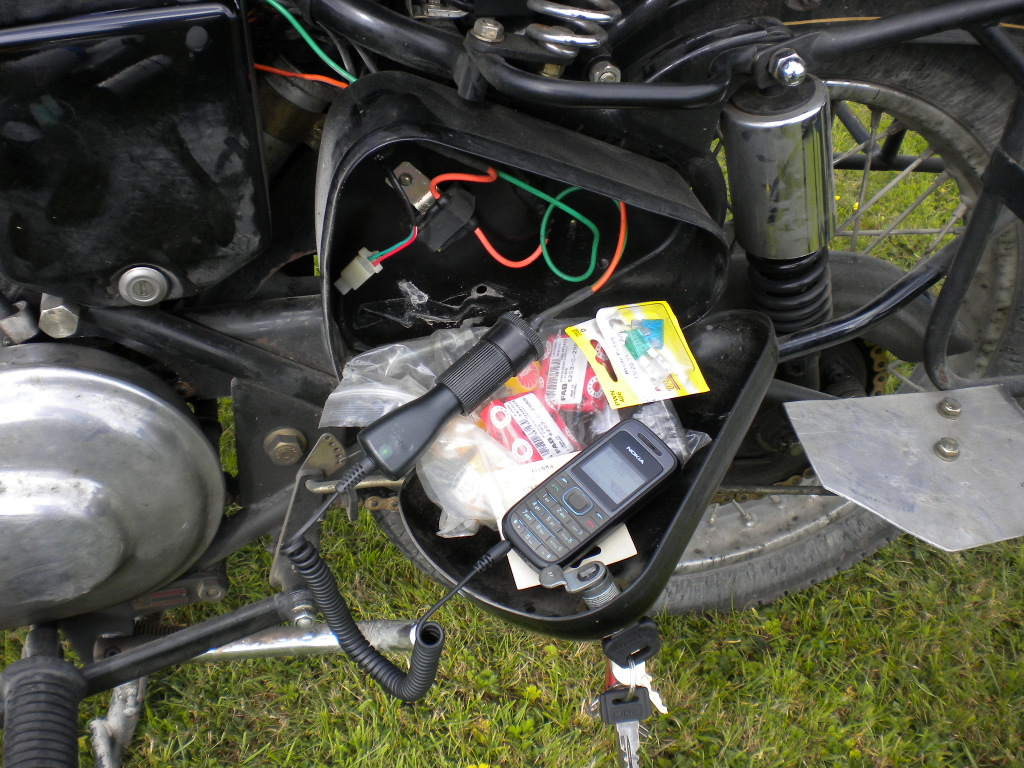

PostPosted: 14:33 - 26 Mar 2013    Post subject: Reply with quote
https://i48.photobucket.com/albums/f216/stinkwheel/rbr/DSCN0793.png
