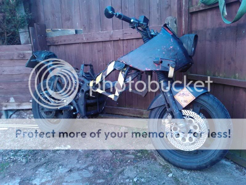

So some of you probably know of my gsx600f rat, some have met it, some have been pillion Laughing (sorry mac)
https://i251.photobucket.com/albums/gg307/virusjohn/GSX%20rat/ratty.jpg

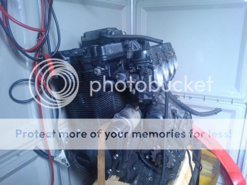

Well I decided i was bored of the power and was offered something for a good price, so begun the 'ratfighter' project.
https://i251.photobucket.com/albums/gg307/virusjohn/GSX%20rat/WP_000169-1.jpg
Yep, thats a bandit 1200 engine, I cant afford to do a gsxr7/11, so im doing a gsx6/12 Laughing Cool

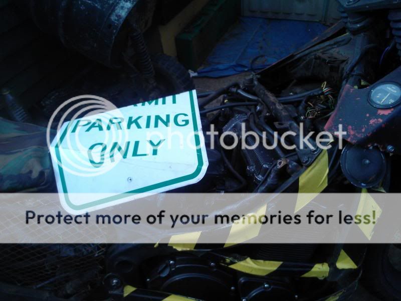

Its been a while of saving up and hoarding parts but the tax ran out on the 6 last weekend and I decided not to re tax it, this means im walking til I get the 12 in, so thats more than enough encouragement to do the job.
So out with the 600
https://i251.photobucket.com/albums/gg307/virusjohn/GSX%20rat/empty.jpg

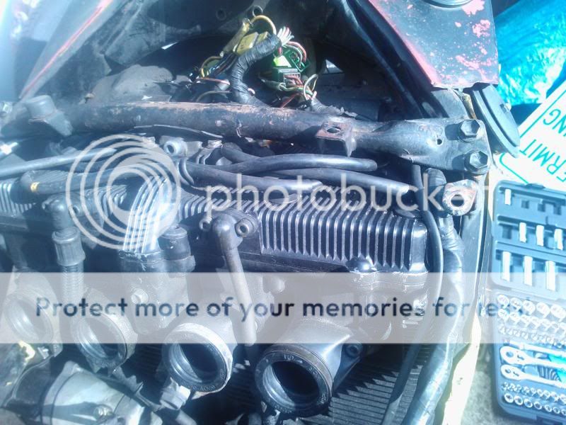

Swapped rocker covers over for clearance as the 12 is half an inch taller anyway.
https://i251.photobucket.com/albums/gg307/virusjohn/GSX%20rat/rockers.jpg
Bandit rocker cover breather box on the left, 600 on the right, every little helps.

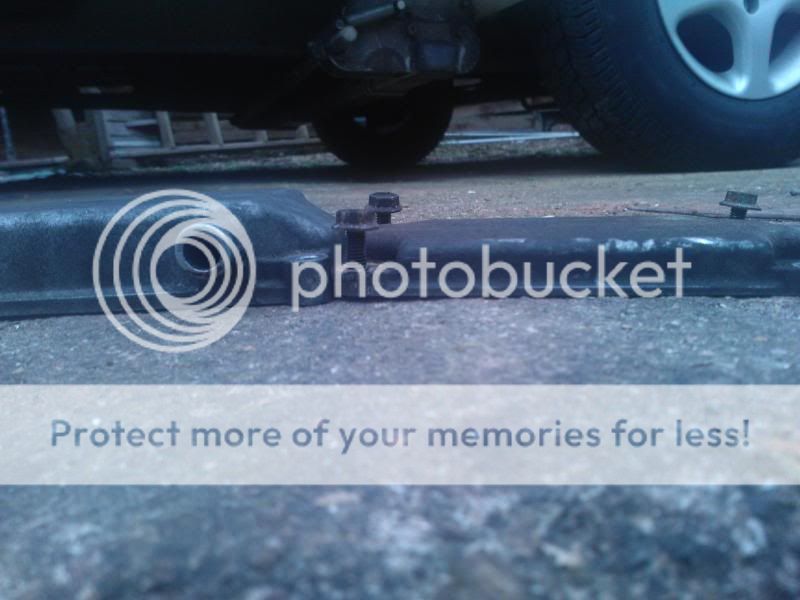

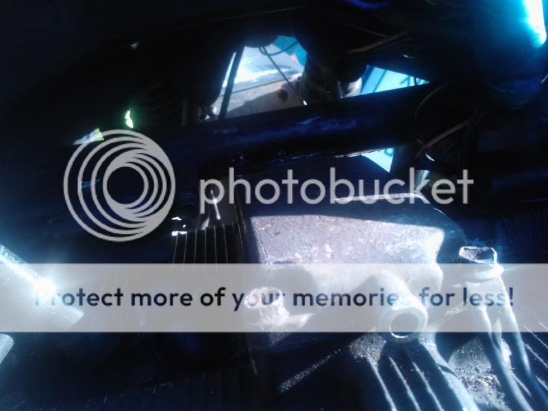

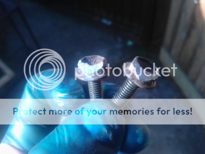

I then found that even that wasnt enough to get clearance for the top rear engine mount bolt to go in. So i Had to chamfer the leading edge of the breather box and remove a face off 2 of the bolts.
https://i251.photobucket.com/albums/gg307/virusjohn/GSX%20rat/skimmedbolts.jpg
As you can just about see in this picture, there isnt much space.
https://i251.photobucket.com/albums/gg307/virusjohn/GSX%20rat/cover.jpg
Infact, the entire bloody thing is tighter than an nuns cunt, I had to oval part of the fuel tank support bar to clear it at the other end of the breather box to get it to clear.
https://i251.photobucket.com/albums/gg307/virusjohn/GSX%20rat/tight.jpg
Note the inner tube inbetween to attempt at removing some vibes.

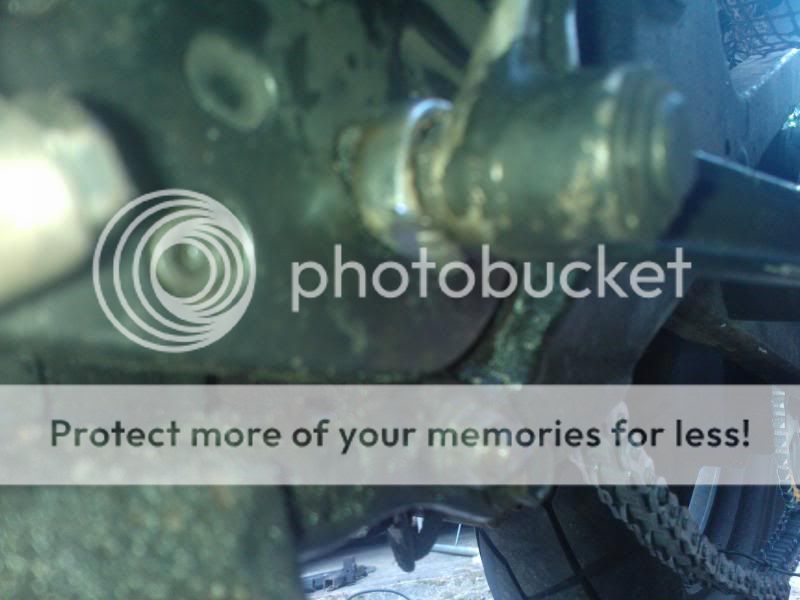

More progress today, first of all I dealt with the front sprocket cover.
The 600f cover has a boss for the gear change lever yet the bandit 12 one doesnt. Luckily it is removable.
https://i251.photobucket.com/albums/gg307/virusjohn/GSX%20rat/sprocketcovers.jpg
So a bit of hammering got that out, and then I drilled a hole in the bandit front sprocket cover to mount it, however the rose joint at the lever end was colliding with the raised part of the cover.....
So I chopped up an old imperial ring spanner as a spacer, job done.
https://i251.photobucket.com/albums/gg307/virusjohn/GSX%20rat/spannerspacer.jpg

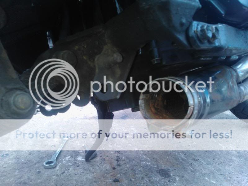

Next was the exhaust, after mounting the downpipes I noticed the main stand eyelet on the frame was in the way.
https://i251.photobucket.com/albums/gg307/virusjohn/GSX%20rat/exhaustfail.jpg

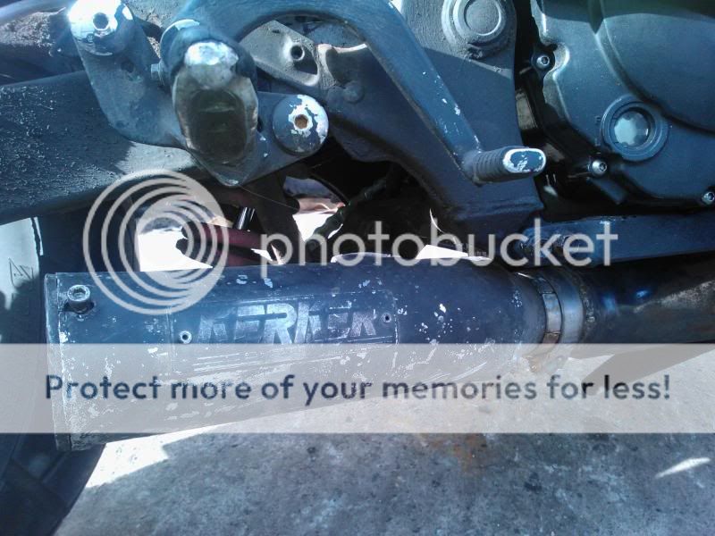

Luckily, I don't have a main stand, and neither do I give a shite about that bracket, so out came the angle grinder, and on went the kerker.
https://i251.photobucket.com/albums/gg307/virusjohn/GSX%20rat/pipewin.jpg

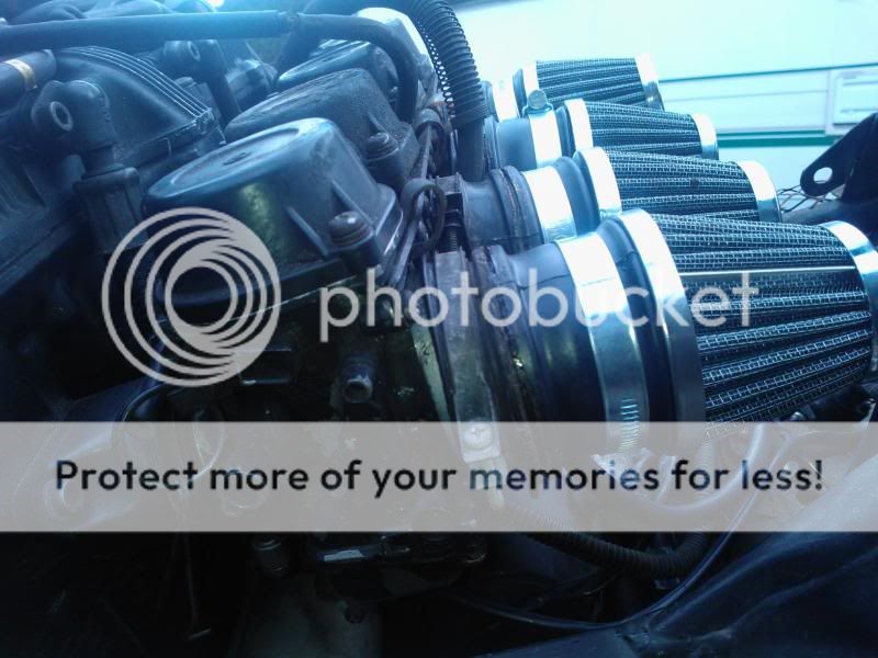

Next was to fit the air filters (cheers temelucus)
I decided to use the airbox snorkels from the gsx600f airbox, primarily because the pods kept popping off their mounting rubbers thanks to the bandit carbs having oval inlets. However by doing it like this it reduces turbulence in the air intake, which is the biggest nightmare about tuning CV carbs on pods. hopefully this will help me later on when Ive got to get it running well.
https://i251.photobucket.com/albums/gg307/virusjohn/GSX%20rat/pods.jpg

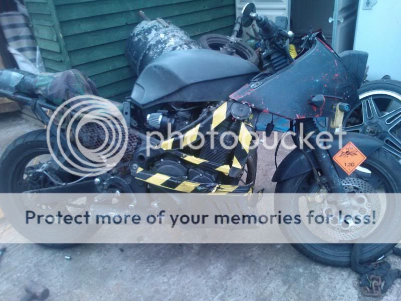

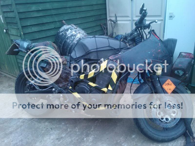

It was at about this stage I got eager and decided to throw the bodywork back on it to see how it looks now.
https://i251.photobucket.com/albums/gg307/virusjohn/GSX%20rat/mockup.jpg
not too dis similar from how it was before but still, nice to see it in one piece (ish) again.
