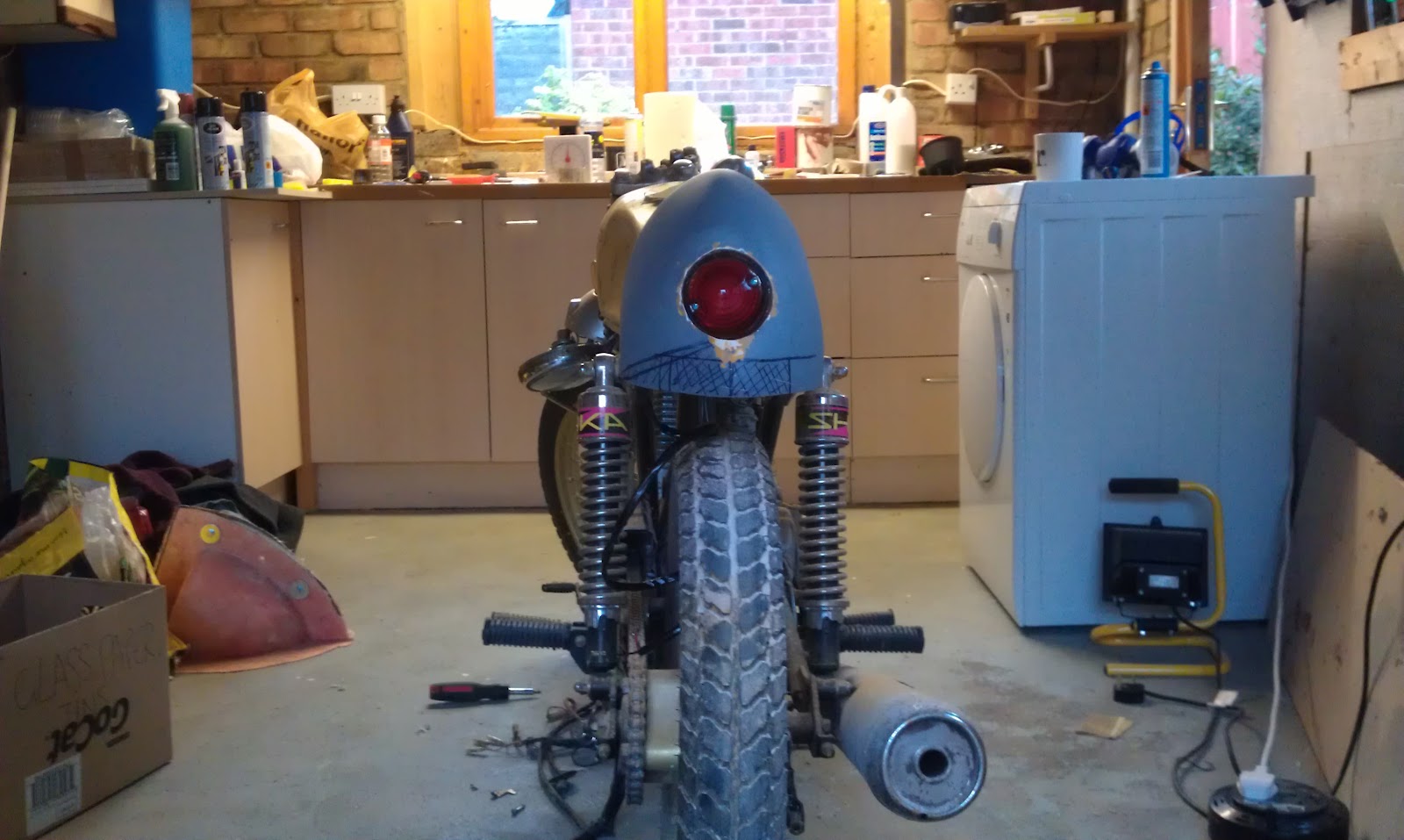

I'm planning on a cafe racer project this year and I have some rough ideas which I need to put down on paper (in pencil) towards going to my final outcome. The basis of the project will be a CG125 more than likely due to me being a student and money being tight, I've been looking at tails etc and know how to make one myself but my idea is to have an integrated brake light without the need for indicators.
The way I want to fit the tail light is something like this:-
https://1.bp.blogspot.com/-Rurslssmt4A/T6t231vbgpI/AAAAAAAAANc/ACaMUm9ziyM/s1600/IMAG0322.jpg
I want to avoid the big gaping gap if I can by making a nice clear lens to suit the curve of the unit, I'm just wondering how I would do that or if it is indeed possible to do at all?

If you can find something that's the right size/shape then you could make a mould and use liquid plastic.

How come? The light in that pic is from a land rover if that helps? surely that is E-marked?
And Liquid plastic is it uber clear Andy?

I've only done bends in acrylic. At school we had a strip heater; at home I use a blow torch and a couple of bits of metal for the 'strips'.
However, I'd have thought if you made a mould and heated the whole area, it'd turn out ok if it was quite thin.

I would use a male and female mould heat the sheet up, put on the male mould and press on the female. You would only have a few seconds to do it in though.
cimbian
Joined: 27 Sep 2012
PostPosted: 08:54 - 30 Apr 2013    Post subject: Reply with quote
Make a male plug from MDF and a DIY vacuum former.
