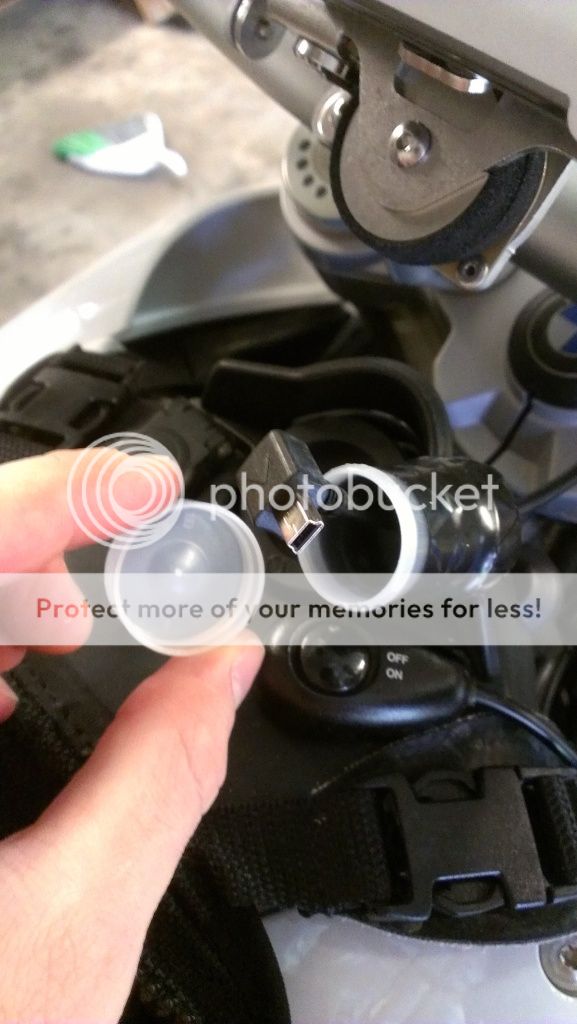

The link where it came from where they discussed mcgyvering a plastic film by creating a hole big enough for the cable to go through and sealing the gap with electrical insulation tape, and then all you have to do is open the film cap cover to expose the plug then plug it into your GPS device. It's certainly a cheap way of doing it?
https://advrider.com/forums/showthread.php?t=829603&page=2
https://i1116.photobucket.com/albums/k571/Herman_Melville/IMAG1286.jpg
