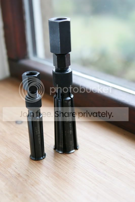

https://i853.photobucket.com/albums/ab92/smack_ph/BB/JT5H8825.jpg
yen_powell
Joined: 22 Jun 2008
PostPosted: 20:36 - 10 May 2013    Post subject: Reply with quote
koolio wrote:
Don't know how the image below will help on anything other than standard ball bearing cups.
I used exactly one of these (with a slide hammer) to remove the race inside an FJ1200 headstock which also has no lip to drive against (Also on an XT225 Serow, must be a Yamaha thing). As the tool is expanded the lip forces it's way under the race, then the slide hammer pulls it out.

Ah ok my apologies. Where can I get one and will it damage the cup upon removal?

https://www.ebay.co.uk/itm/BERGEN-Pro-5-Piece-Inner-Blind-Bearing-Puller-Set-NEW-/390404587484?pt=UK_Hand_Tools_Equipment&hash=item5ae5ed3fdc
