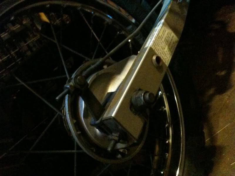

Thanks for the replies. I took a picture of the rear wheel I just wondered if someone could verify for me as I'm a little stumped with all the terminology - I loosen the nuts on rear wheels spindle (the big bolts) and the. Twist the smaller bolt (on either side) on the end of the swing arm to adjust the chain?
https://i108.photobucket.com/albums/n21/binnie_2006/null_zps0a38087e.jpg

PostPosted: 14:04 - 29 May 2013    Post subject: Reply with quote
Yep.
Loosen the big nut on the spindle.
Loosen the rearmost of the two nuts on the adjuster on both sides of the bike (the lock nut).
Adjust by turning the nut under the lock nut in small increments equally on each side until you reach the correct amount of free play.
Hold the adjuster nuts with a spanner to prevent them moving and tighten the lock nuts.
Tighten the spindle nut and recheck free play.
Finally, check the back brake adjustment as moving the wheel back will alter it slightly.
Job done. Thumbs Up
