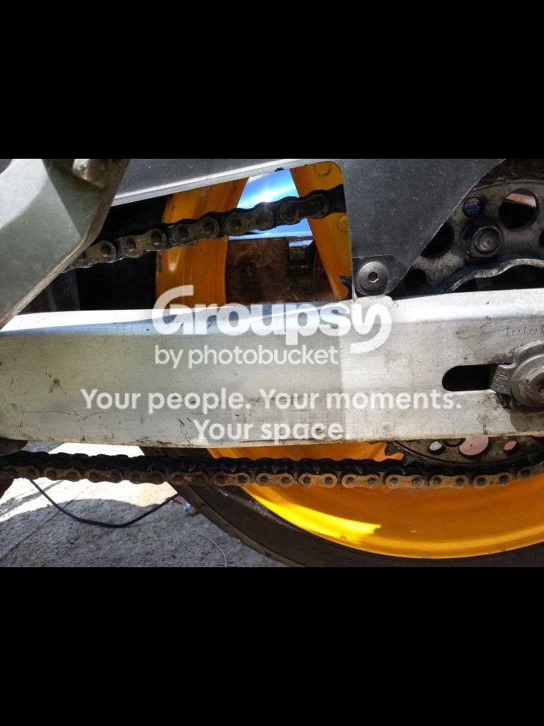

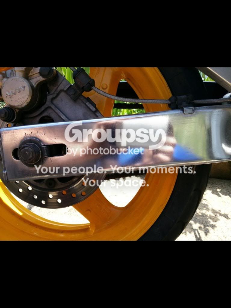

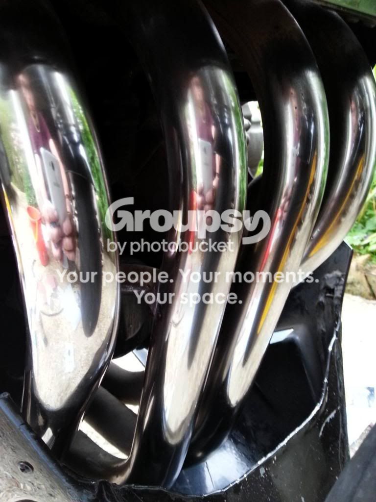

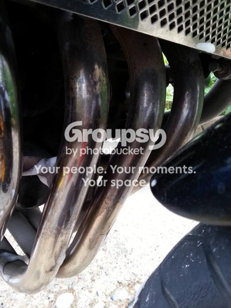

Over yesterday and today I decided to give polishing my swingarm and downpipes a go, it took a gold few hours but I think it was worth it, i used different grades of wet and dry paper with autosol and a lot lf rags. Anyway pictures below Smile
Before
https://i1295.photobucket.com/albums/b630/reedmeredith/image_zps0f7ad2ed.jpg
After:
https://i1295.photobucket.com/albums/b630/reedmeredith/image_zpsc7b4d970.jpg
Before:
https://i1295.photobucket.com/albums/b630/reedmeredith/image_zps9f27db07.jpg
After:
https://i1295.photobucket.com/albums/b630/reedmeredith/image_zpsd4439fac.jpg

What grade wet & dry, did you use ?
I'll have to give it a go.
Nice job by the way. Very Happy

Started with 180 on a vibrating sander thing, just to get all of the crap off, then worked up from 400 up to 1200, then autosol.
The swingarm I just used 180, then a worn down 180 then autosol (couldn't be bothered to go and buy different grades until I decided to do my downpipes today) Laughing
Only thing is, one side of the swingarm didn't come up as shiney for some reason, doesn't bother me though.

It didn't smoke at all, I made sure all of the polish, finger marks etc. were off, apparently left over oil and stuff can make the downpipes change colour unevenly.
