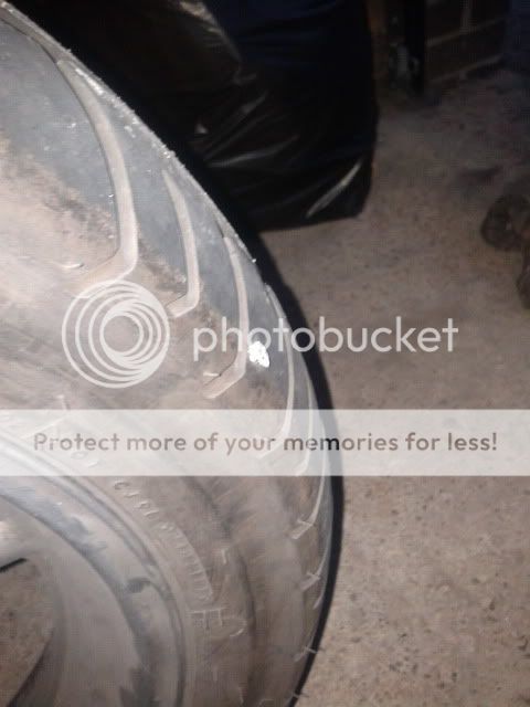

Morning all,
I just returned from an early hours hoon and noticed this weird shiny thing sticking out of my tyre:
https://i1323.photobucket.com/albums/u587/mjs1066/20130605_043506_zps3270f346.jpg

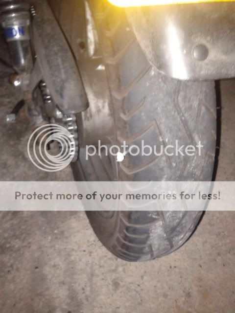

Gave it a gentle tug with a pair of pliers (ooh-er Missus!) and sure enough it's a motherfucking nail. Just in time for a sunny day off work I might add. Fuck my life.
https://i1323.photobucket.com/albums/u587/mjs1066/20130605_044129_zps6c1b0fd3.jpg
Up to now I've been lucky and never had to deal with a puncture before so need to know what my options are. There's a good 2 to 3,000 mile of tread left on the tyre I reckon, so if a repair is possible how much is it likely to set me back and where should I go to get one? Or should I just cough up £100 for a new tyre?
Any advice welcome!

PostPosted: 05:23 - 05 Jun 2013    Post subject: Reply with quote
Bit close to the edge for my liking mate....
New shoes time.

PostPosted: 07:56 - 05 Jun 2013    Post subject: Reply with quote
New shoes time.
This. Anywhere else on the bottom of the tyre then it can be plugged. But thats a bit close to the side for my liking too.

PostPosted: 09:10 - 05 Jun 2013    Post subject: Reply with quote
I don't think you'll find anywhere that'll do a proper plug that close to the sidewall, so you'd have to do it yourself. As its not a new tyre i'd just get a new one.

PostPosted: 09:23 - 05 Jun 2013    Post subject: Reply with quote
I think even Paddy would baulk at plugging that. Wink
Too close to the sidewall for comfort, I'm afraid. New tyre time.

PostPosted: 09:34 - 05 Jun 2013    Post subject: Reply with quote
New tyre time Thumbs Up nowhere will plug that because of where it is

PostPosted: 09:36 - 05 Jun 2013    Post subject: Reply with quote
leave it in there for now. I had a nail in the centre of my GSXR tyre for about a year, didn't leak.
Islander
Joined: 05 Aug 2012
PostPosted: 09:48 - 05 Jun 2013    Post subject: Reply with quote
That's very bad advice. There's a massive difference in construction between the centre of a tyre and the sidewall edge - the OP would be risking an eventual blow out. Leaving an object that size in the centre isn't a smart thing to do either.

PostPosted: 09:57 - 05 Jun 2013    Post subject: Reply with quote
it's fooked, new tyre needed Thumbs Up

PostPosted: 12:16 - 05 Jun 2013    Post subject: Reply with quote
Meh, I'd put a self tapping screw in it for a temporary fix.
Or plug it myself.
PostPosted: 12:27 - 05 Jun 2013    Post subject: Reply with quote
Nah, looks fine to me, I've seen someone plug so close its patch on the inside was overlapping the sidewall.
If it was close to the limit or ~2mm I'd just swap it.

PostPosted: 12:29 - 05 Jun 2013    Post subject: Reply with quote
I'd get it plugged and forget it ever happened if it was me Smile

PostPosted: 13:27 - 05 Jun 2013    Post subject: Reply with quote
Plug it and ride on regardless.
The tyre's on it's last legs anyway so if you are not pushing it to it's physical limits it'll be fine.
I've not bothered pluging before and skooted a bottle of Slime from Halfords into a nailed tyre. Ran it to the wire then. Smile

PostPosted: 15:24 - 05 Jun 2013    Post subject: Reply with quote
Thanks lads for all the advice, getting a new tyre fitted tomorrow Karma
