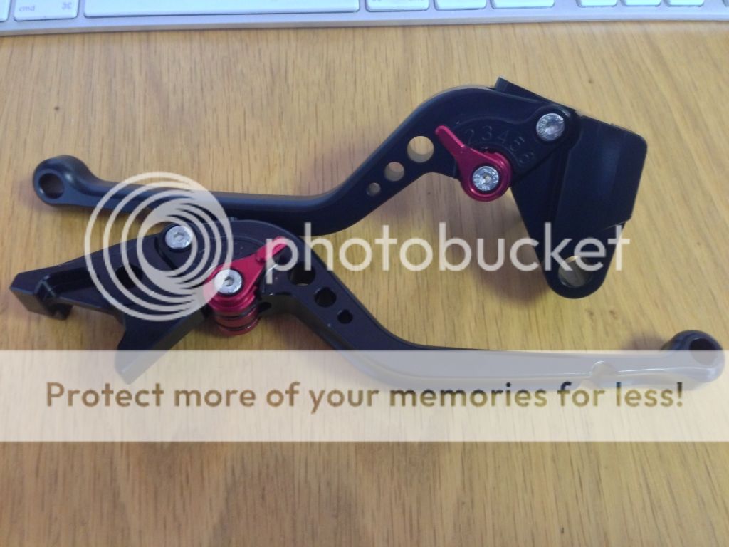

I've just got these
https://i1312.photobucket.com/albums/t525/wotsthestory/ER-6F/302a1ad9-1b09-41bd-ae6c-27401a299e4c_zps8d3780f9.jpg~original
I have adjustable levers already on the ER6 (they are as standard), but they don't look as nice as these, also these are a shorter pull.
May seem like a really daft question, which it probably is, how do you install them? By that I mean what position should it be at to install and where in the adjustment of the cable should it be to allow adjustment back and forth.

Leave them in that 1 position to fit.
Brake lever is just a straight swap, remove screw/bolt, swap lever, then adjust it to where it's comfortable for your span.
Clutch lever should go on without changing the cable adjuster on the bars apart from a bit of turning to line up the slots. Then again adjust it for your span or where you want it to bite.
Clutch bolt/screw may have a sleeve (tube thing) around it you will need to use in the new lever.

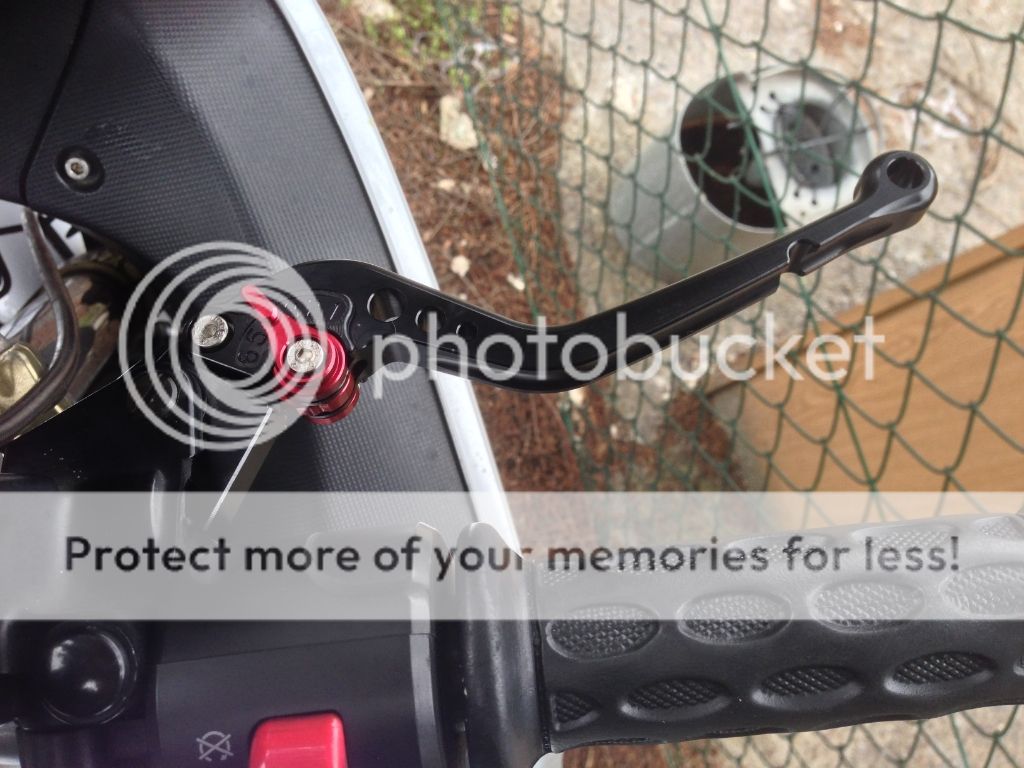

Brake lever installed!
https://i1312.photobucket.com/albums/t525/wotsthestory/ER-6F/466fadd5-6be0-4c4e-8762-e179addc0207_zpse5b64995.jpg~original
10mm nut on the bottom, then undo the screw, swap and put back. Took 2 minutes, if that.
Position 4 seems to leave me just clear of the grip when fully compressed. We'll see what it's like riding. It is pretty firm as the fluid was replaced a week ago and bled through.
The clutch needs a socket to get to the nut and possibly a socket on top, I'll do that when I get home.
Looks good though.

Brake was fine, no problems at all. I wasn't able to brake hard as such, as it had started raining and was greasy.
Clutch lever fitted. This is a little floppy, but I know the original one was too, it's almost as though it's missing a washer, vertical motion more than anything.
Clutch is fine, but down shifting when slowing rapidly (engine braking) you have to be careful, to stop the rear wheel squirming. It is greasy out there, but It wasn't too bad prior. Think I just need to get used to the shorter travel, as I'm probably dumping the clutch rather than feeding out as before.

Was there a sleeve in the old lever you swapped to the new one?
The floppiness could be in the lever assembly itself. Try gently tightening the allen bolt and nut that hold the lever to the blocky part (technical term).

Sorted the looseness in my lever, there is a sleeve in the existing lever. It's a brass coloured sleeve, which drops in from the top, so it can't actually fall out. Once in, lever was much firmer. Still not sure if I've adjusted the clutch correctly, will find out in my favourite hooning point tomorrow. Laughing
