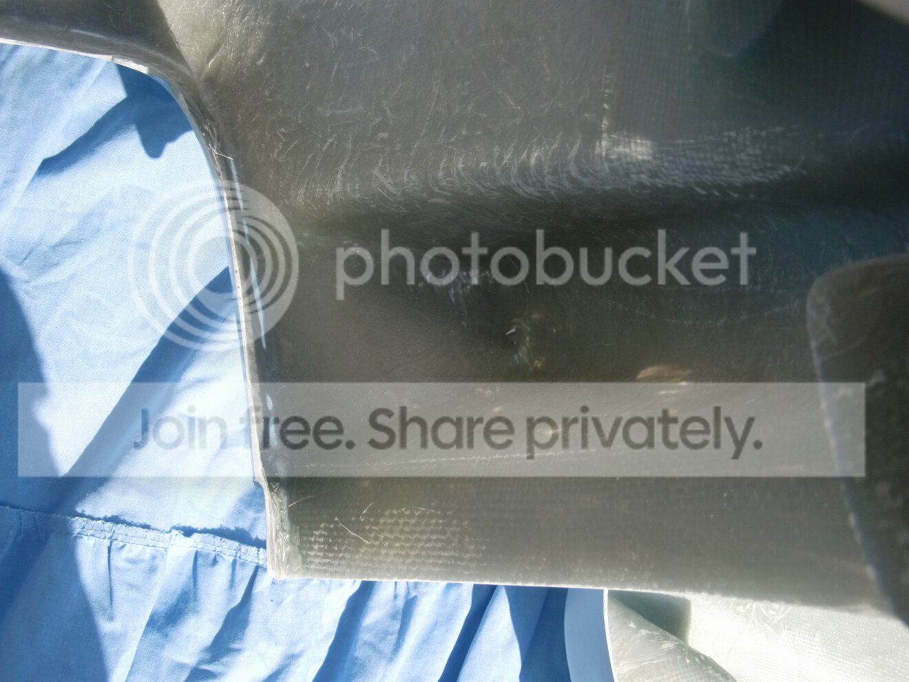

https://i48.photobucket.com/albums/f216/stinkwheel/VFR/1CIMG1010_zps616da97e.jpg
They look pretty good quality on the whole, feels pretty heavy duty compared to a lot of race fairings I've seen and feels less likely to snap than the standard plastics. There are patches of extra fibreglass in the bits where it'll be prone to flexing.
