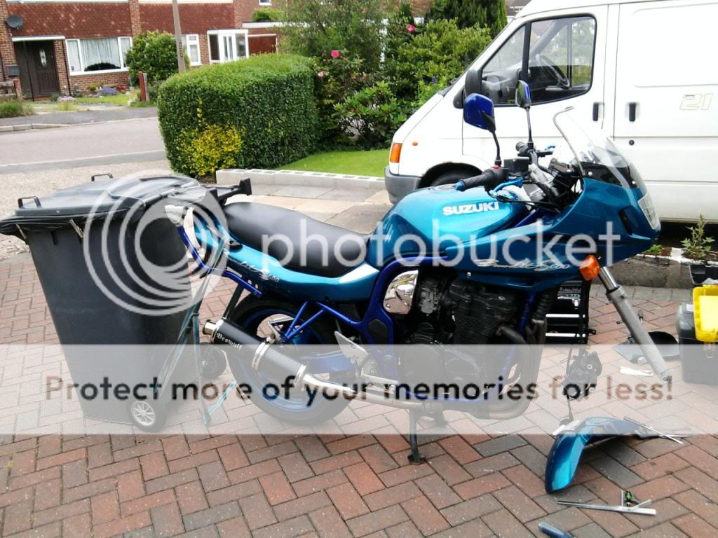

Joined: 23 Mar 2013
PostPosted: 16:05 - 12 Jul 2013    Post subject: Reply with quote
I do mine by putting the side stand (none of my bikes has a centre stand) on a brick so the bike stands more upright, then put a trolley or bottle jack under the frame on the opposite side to lift. If I'm not feeling brave, I replace the jack with bricks or an axle stand.

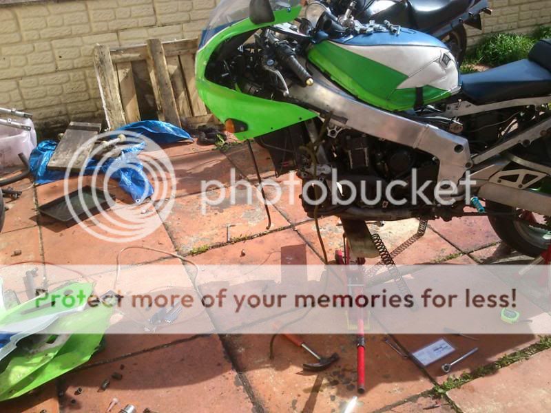

PostPosted: 17:58 - 12 Jul 2013    Post subject: Reply with quote
I just used a trolley jack and piece of wood last time I done mine:
https://img.photobucket.com/albums/v320/andy36586/forksremoved_zps635ade0e.jpg

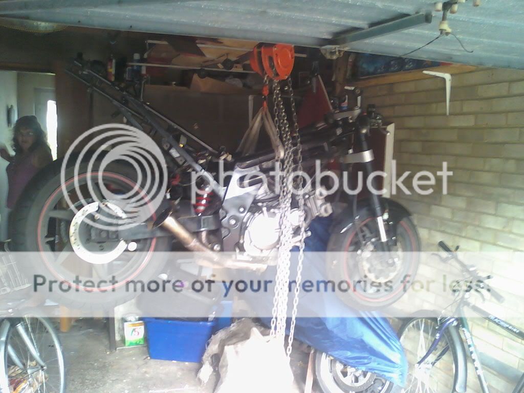

jimbob005
Joined: 25 Nov 2012
PostPosted: 07:51 - 14 Jul 2013    Post subject: Reply with quote
https://i154.photobucket.com/albums/s267/jimbob005/Photo0137_zpsadb1e4f3.jpg
