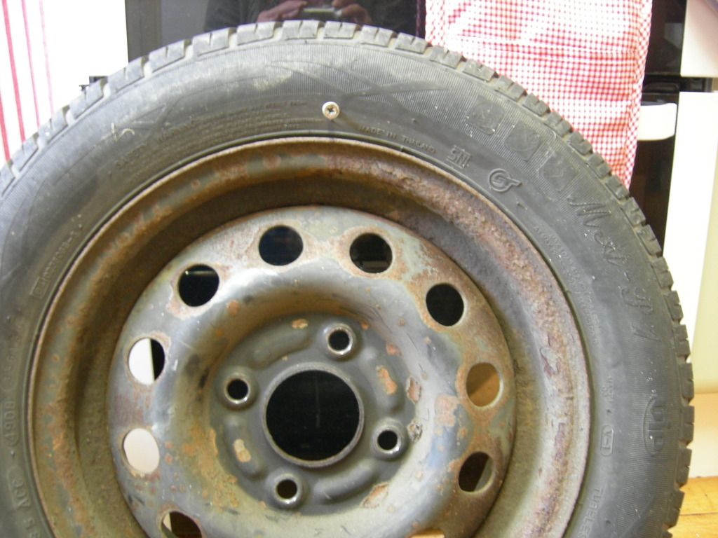

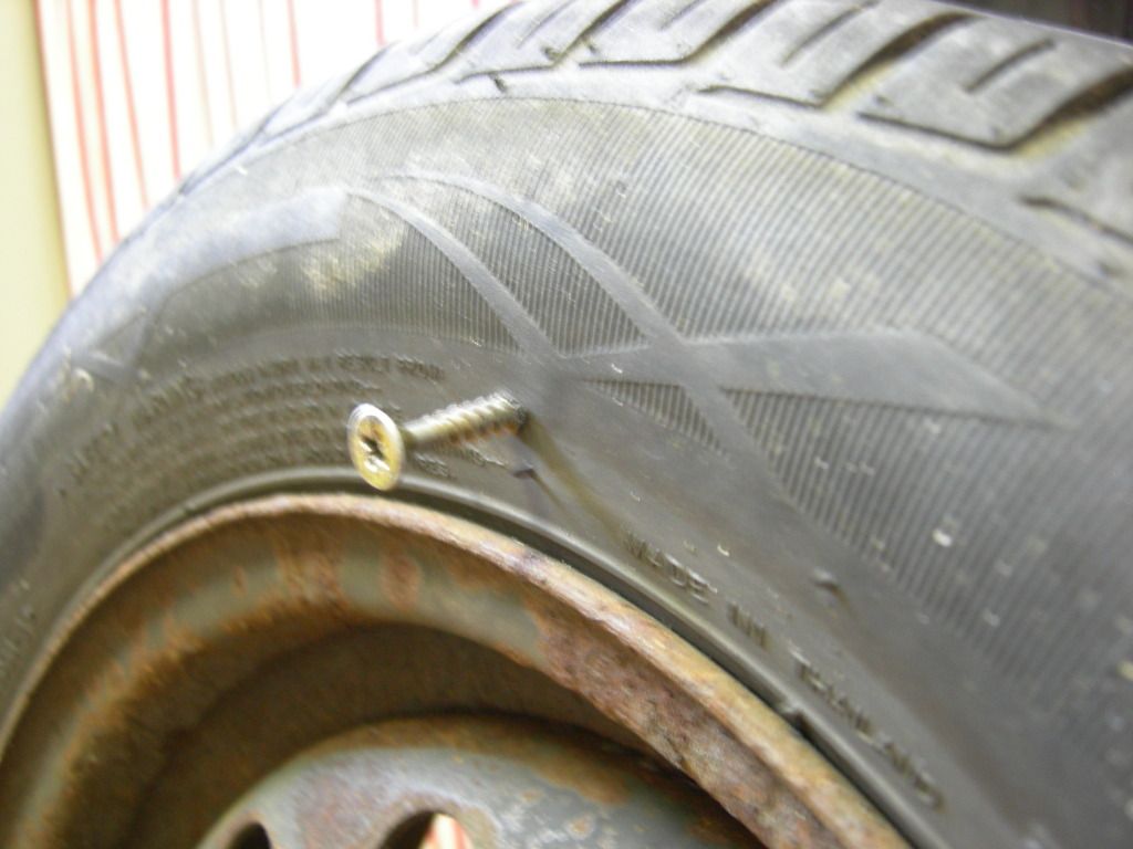

Regarding the puncture. Got a picture of it. I repair my tyres if they are punctured outside of the "allowed" zone, which is generally the central thee quarters of the treaded area.
Full on sidewall repairs are a little bit naughty. But if it's still on the treaded part of the tyre, I'd fix it. Thumbs Up
Got a couple of pics and am going to get it done asap as we now have no spare. It's been in the kitchen since yesterday waiting for the police to have a gander, it's already getting on my wick Very Happy

That didnt get in there by chance. No way.
