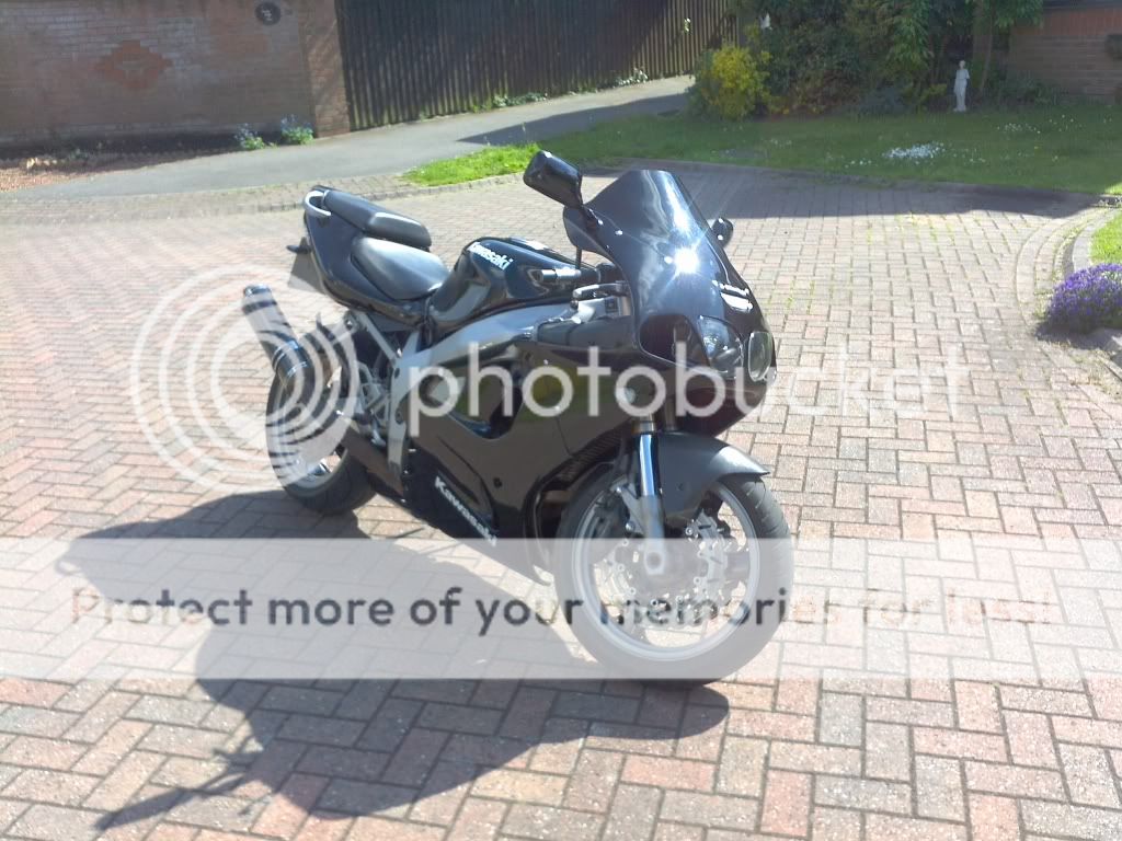

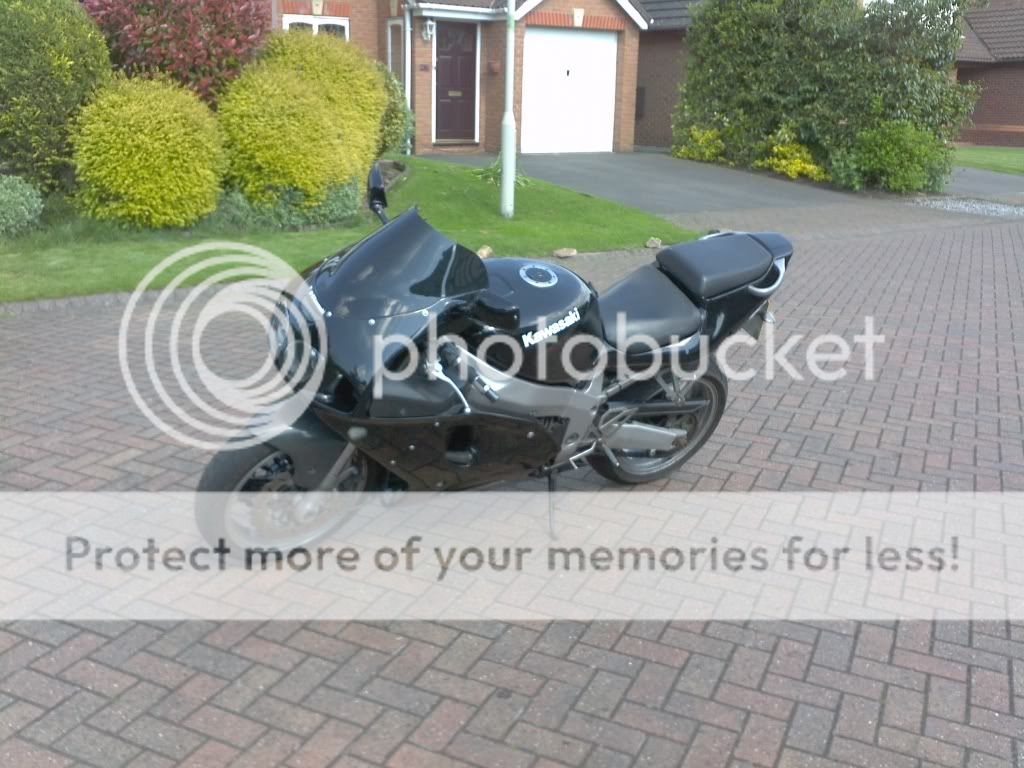

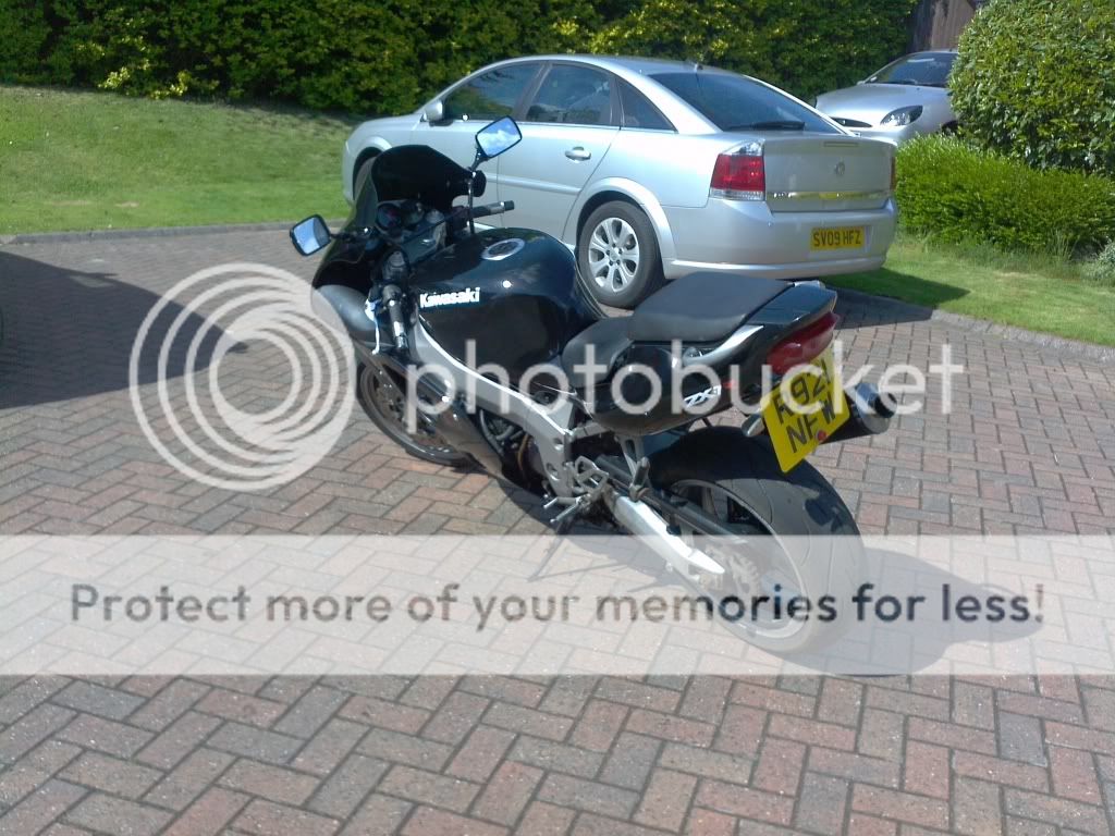

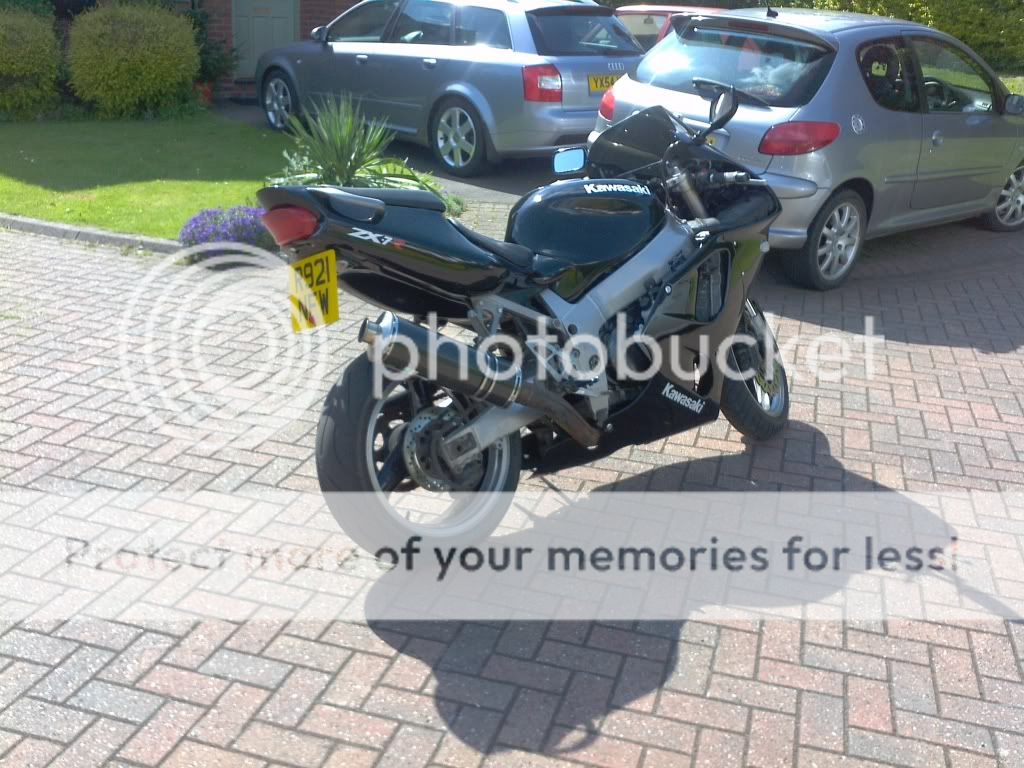

Here she is!
https://i1148.photobucket.com/albums/o564/pixelguyy/IMG_20130526_155805_zps111af514.jpg
https://i1148.photobucket.com/albums/o564/pixelguyy/IMG_20130526_155814_zpsc85811e2.jpg
https://i1148.photobucket.com/albums/o564/pixelguyy/IMG_20130526_154708_zps8c827aed.jpg
https://i1148.photobucket.com/albums/o564/pixelguyy/IMG_20130526_155825_zps342fbaf9.jpg
as you can see she doesnt look too bad but needs a lot of cleaning up and aftermarket parts fitted Smile before anyone asks about the EXHAUST the reason it looks so odd is because its a jph ducati exhaust welded on by the previous owner... looks silly but sounds awesome.

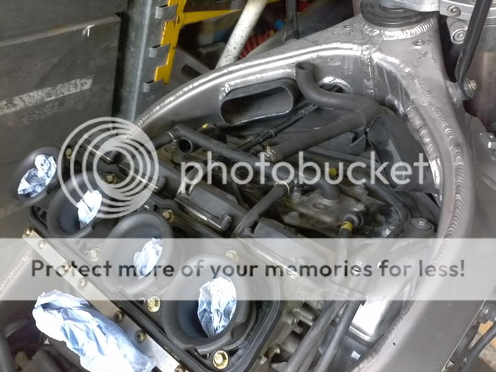

anyway first things first, i did the clean air mod as any ZX7r owner should! these bikes weigh a ton so every little helps.
https://i1148.photobucket.com/albums/o564/pixelguyy/IMG_20130531_115151_zps78491b3c.jpg

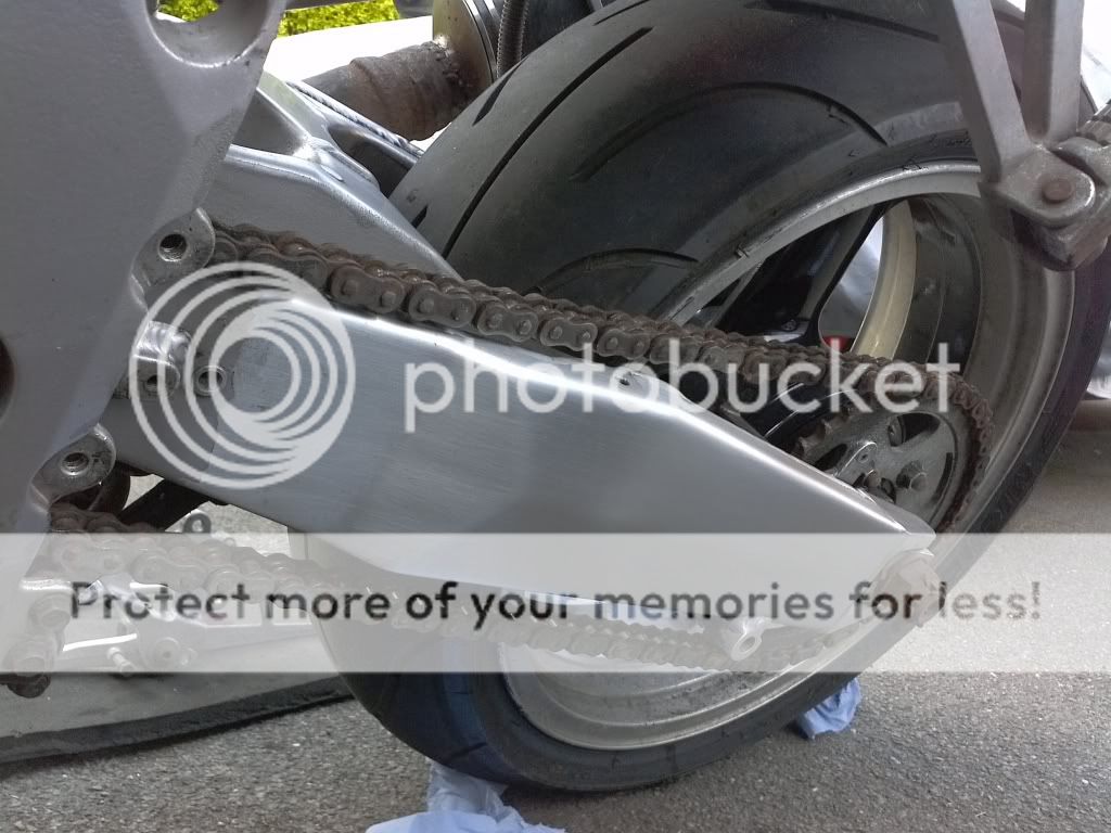

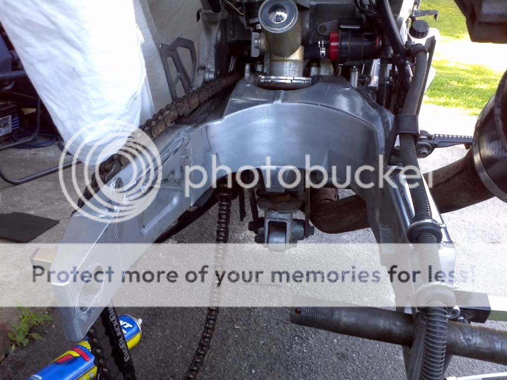

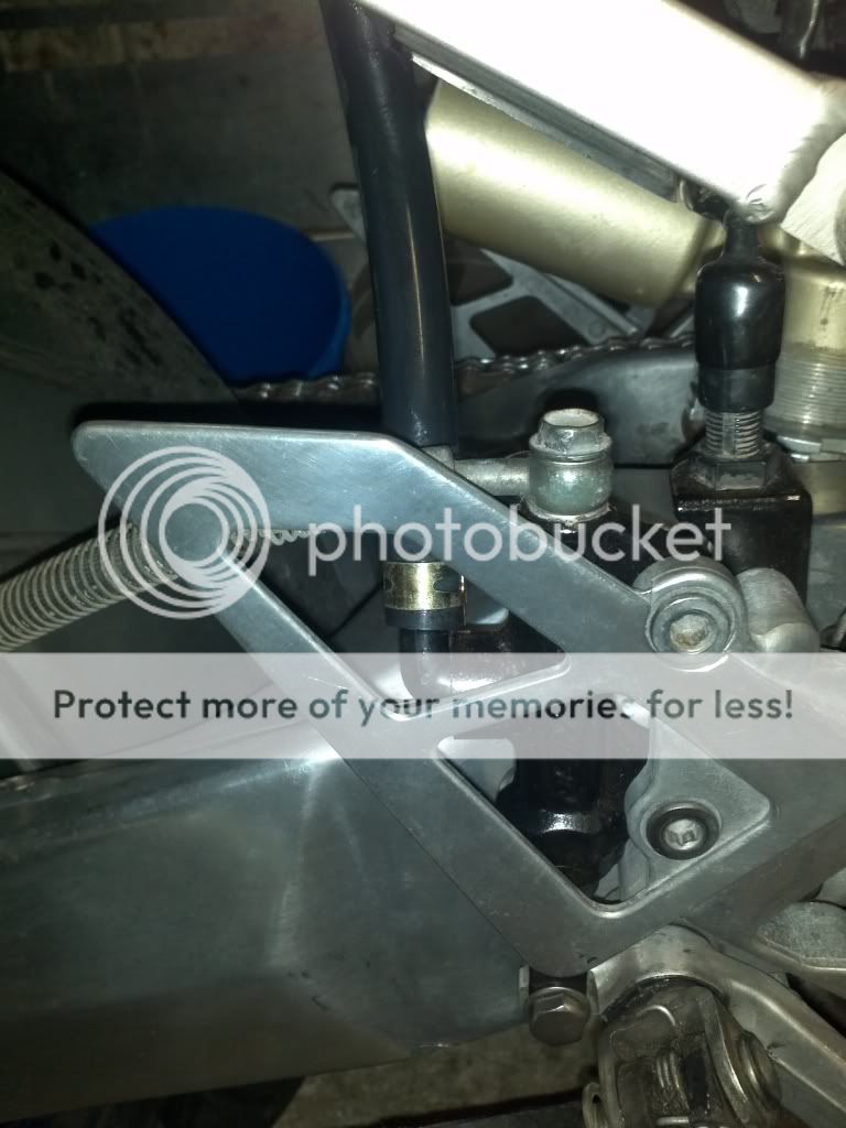

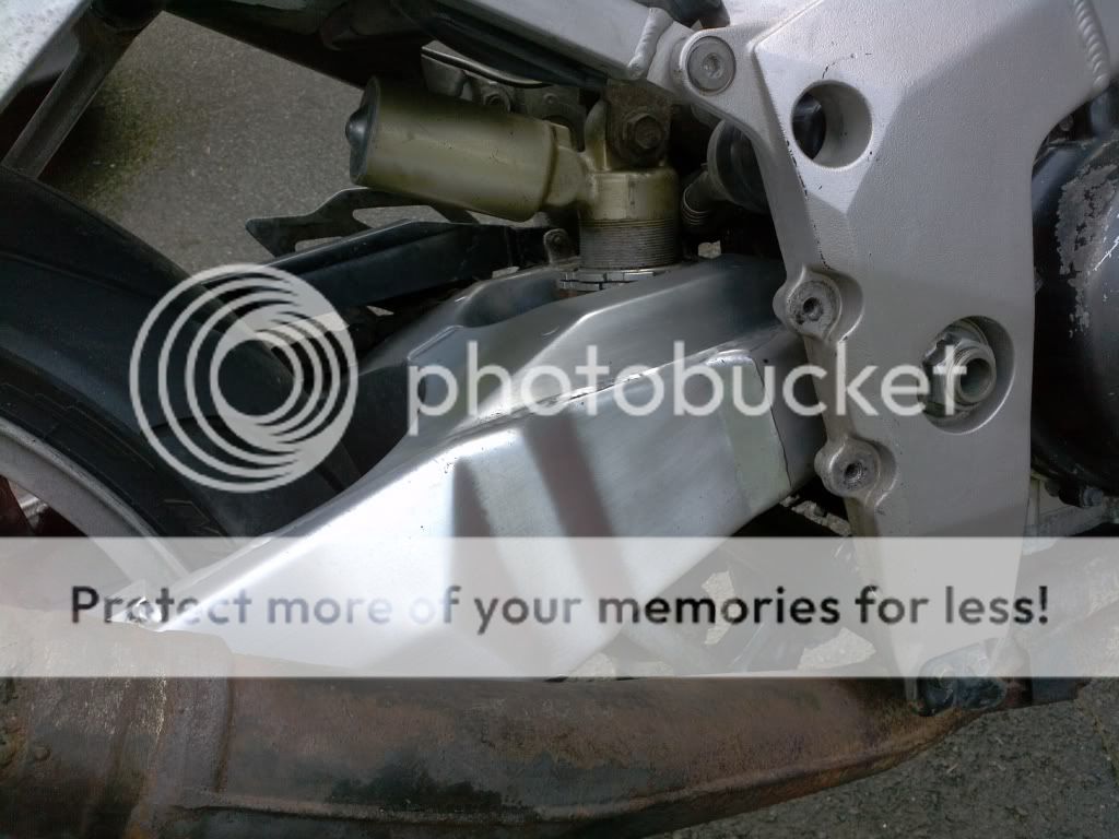

brushed the swingarm

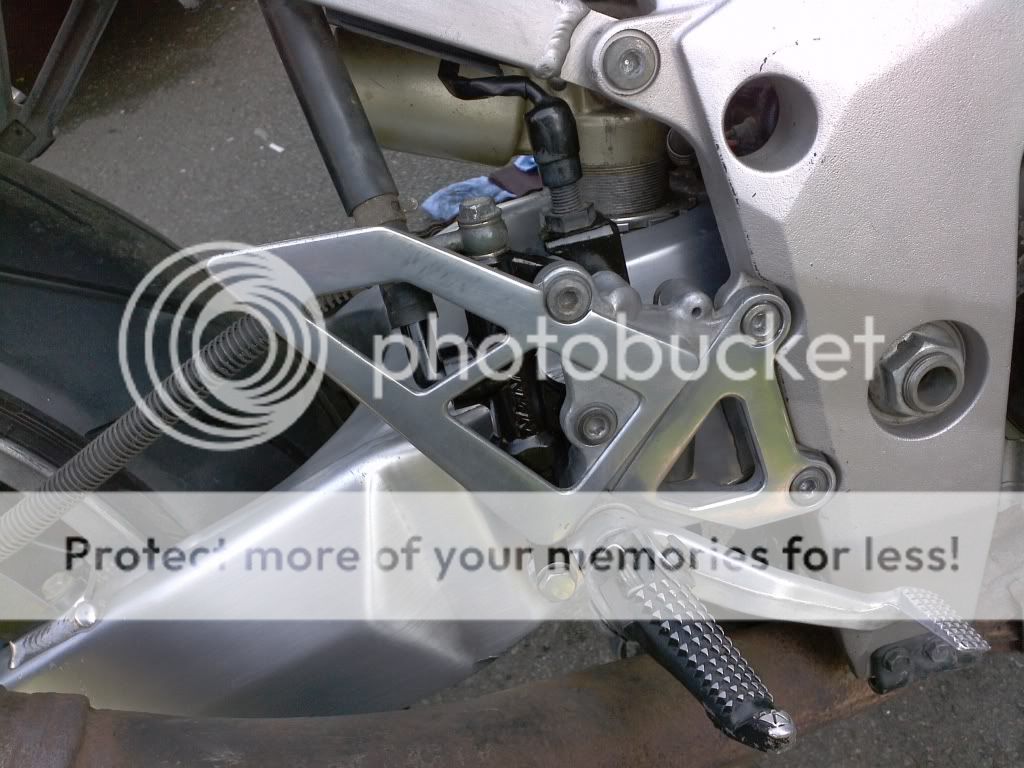

https://i1148.photobucket.com/albums/o564/pixelguyy/IMG_20130531_142640_zpsb5695f5f.jpg
cleaned up the rearsets and sprayed the bracket and master cylinder black
https://i1148.photobucket.com/albums/o564/pixelguyy/IMG_20130531_171809_zps5b37f1b8.jpg

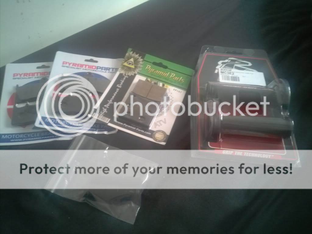

goodies :3
https://i1148.photobucket.com/albums/o564/pixelguyy/IMG_20130601_090312_zpsa37cc088.jpg

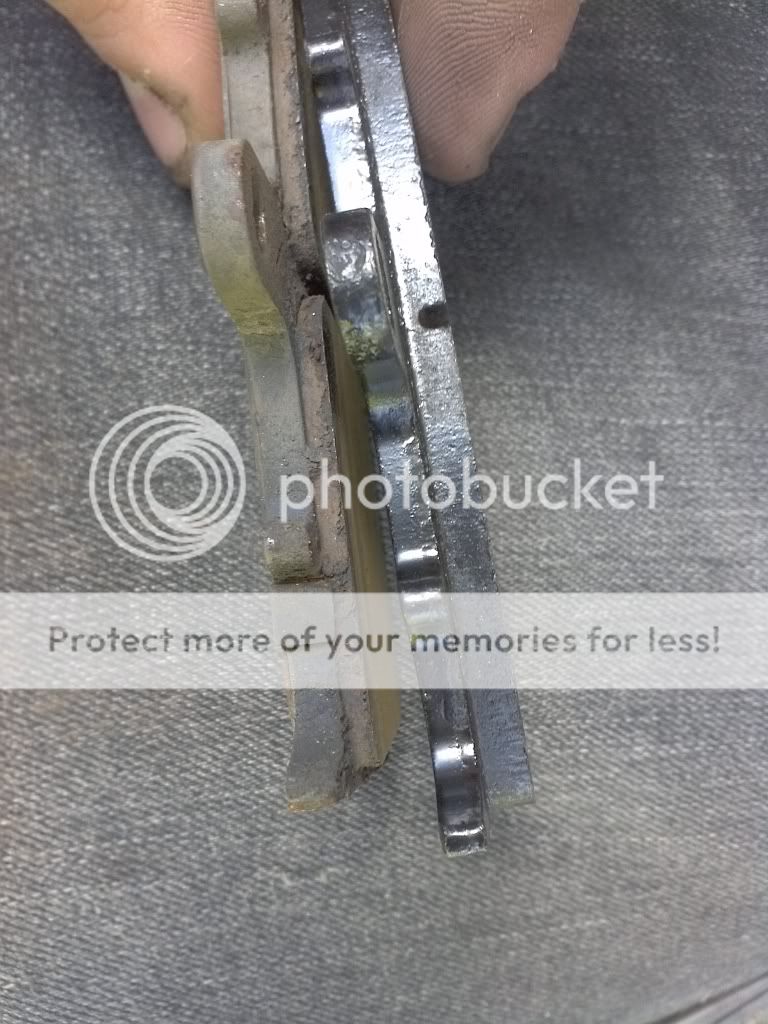

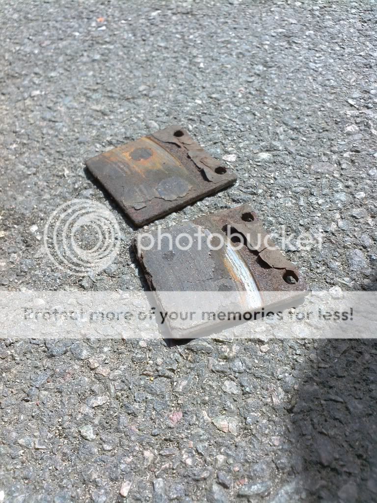

pad comparison
https://i1148.photobucket.com/albums/o564/pixelguyy/IMG_20130601_120220_zpsa1be00f7.jpg

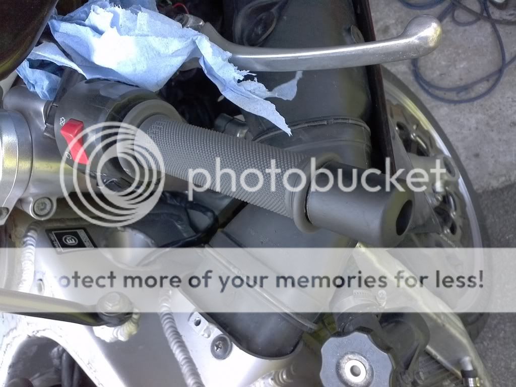

grips Very Happy
https://i1148.photobucket.com/albums/o564/pixelguyy/IMG_20130601_131500_zps277dc852.jpg

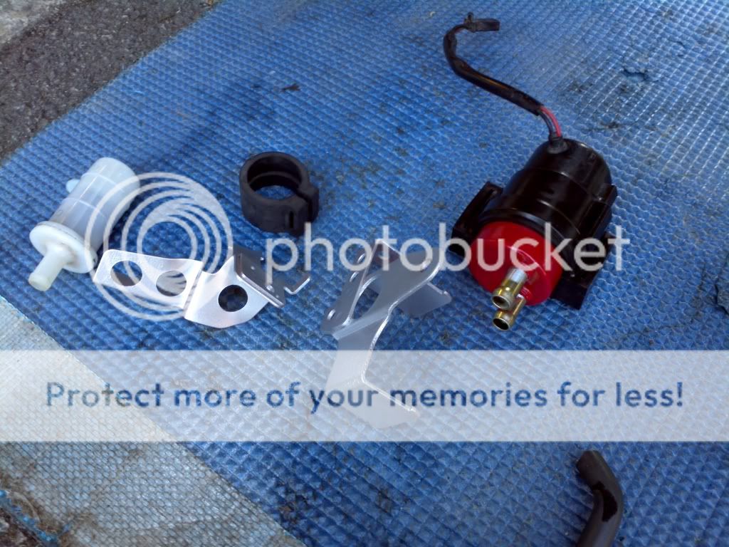

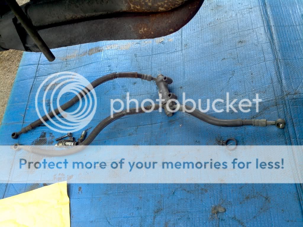

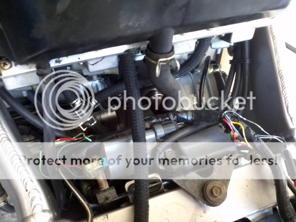

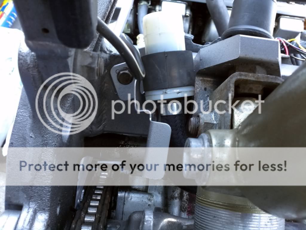

cleaned up the engine bay, purchased all new fuel lines and sprayed all the holding brackets + fuel pump!
https://i1148.photobucket.com/albums/o564/pixelguyy/IMG_20130603_182456_zps8e8b5d24.jpg
https://i1148.photobucket.com/albums/o564/pixelguyy/IMG_20130607_105901_zps6db6bc42.jpg
https://i1148.photobucket.com/albums/o564/pixelguyy/IMG_20130603_192506_zps4e9d180d.jpg
https://i1148.photobucket.com/albums/o564/pixelguyy/IMG_20130603_183608_zps830936d4.jpg
https://i1148.photobucket.com/albums/o564/pixelguyy/IMG_20130603_192501_zpse307d165.jpg

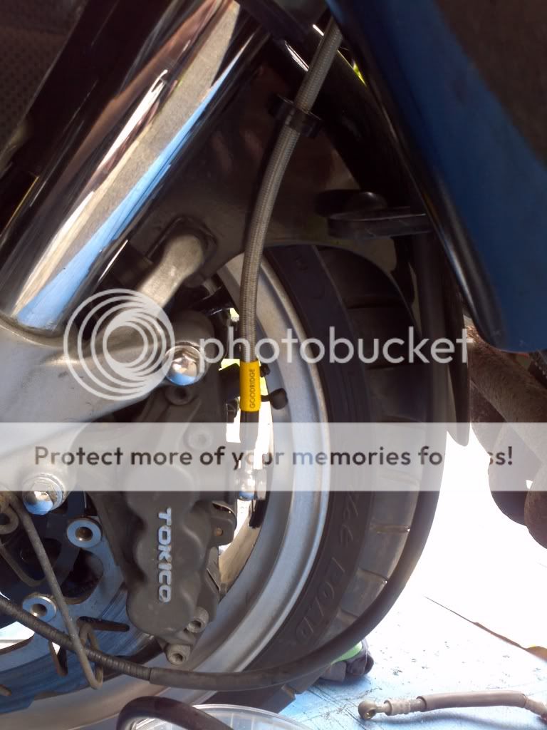

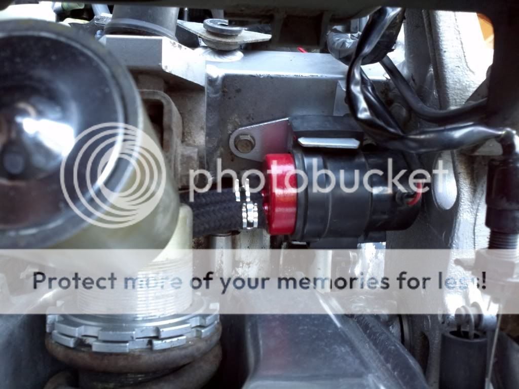

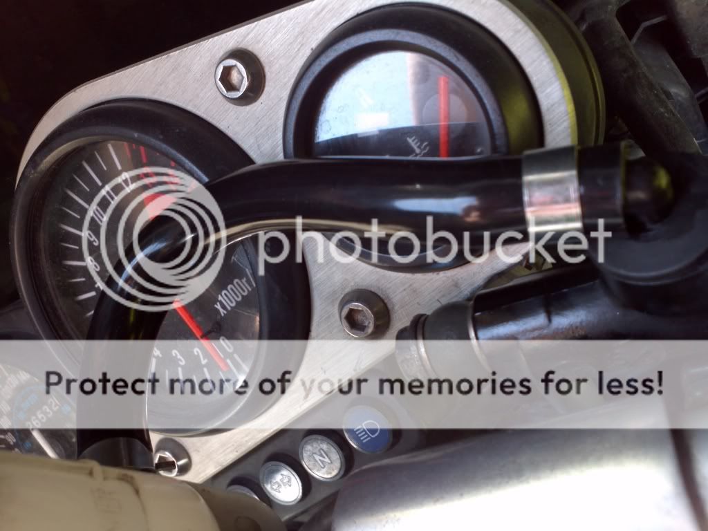

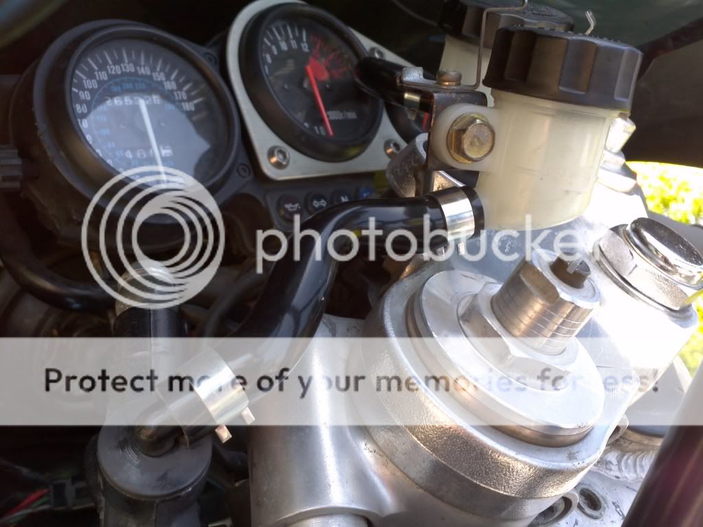

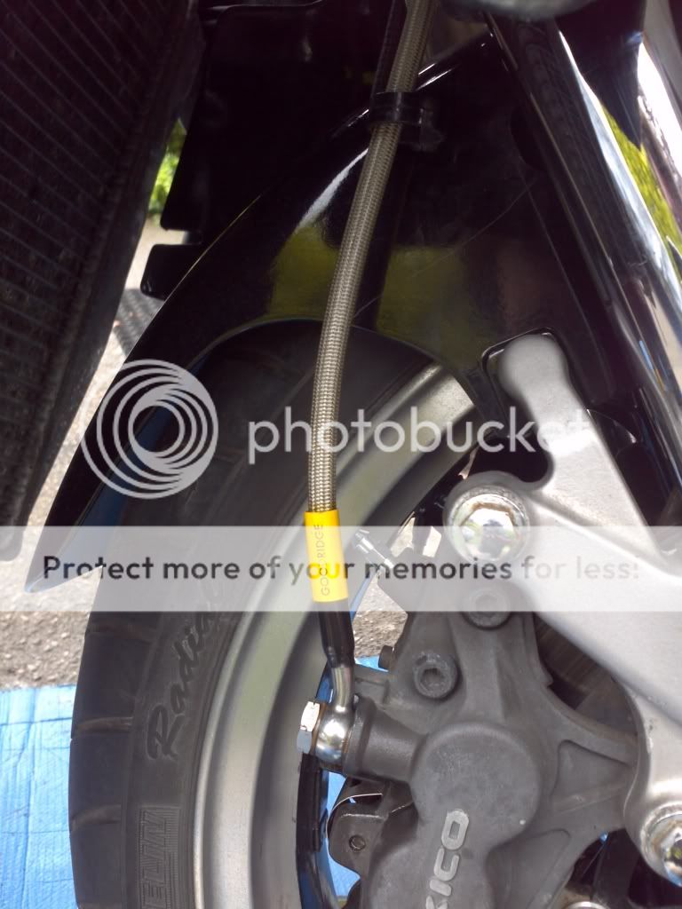

new brake/clutch reservoir lines fitted! Mr. Green
https://i1148.photobucket.com/albums/o564/pixelguyy/IMG_20130604_125537_zps4fd9a96b.jpg
https://i1148.photobucket.com/albums/o564/pixelguyy/IMG_20130604_125544_zpsc6940bb6.jpg
https://i1148.photobucket.com/albums/o564/pixelguyy/IMG_20130612_214019_zps3cf4a17a.jpg

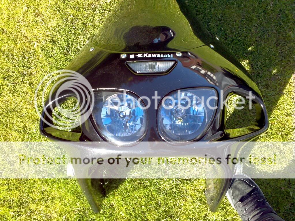

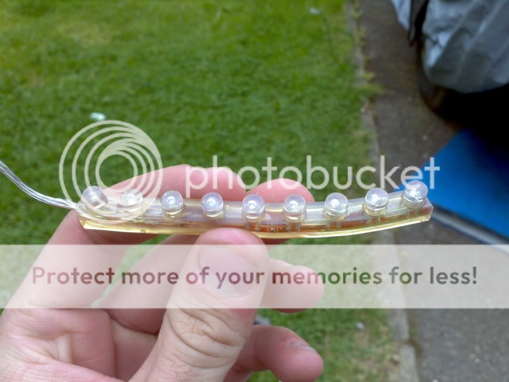

decided to take a look at the front end and clean the insides of the headlights and change the clock bulbs for LEDs all that mumbo jumbo!
https://i1148.photobucket.com/albums/o564/pixelguyy/IMG_20130604_174410_zps3593394a.jpg
https://i1148.photobucket.com/albums/o564/pixelguyy/IMG_20130604_162950_zpsfa3a7d9e.jpg
https://i1148.photobucket.com/albums/o564/pixelguyy/IMG_20130604_174427_zps0cc4a1e5.jpg

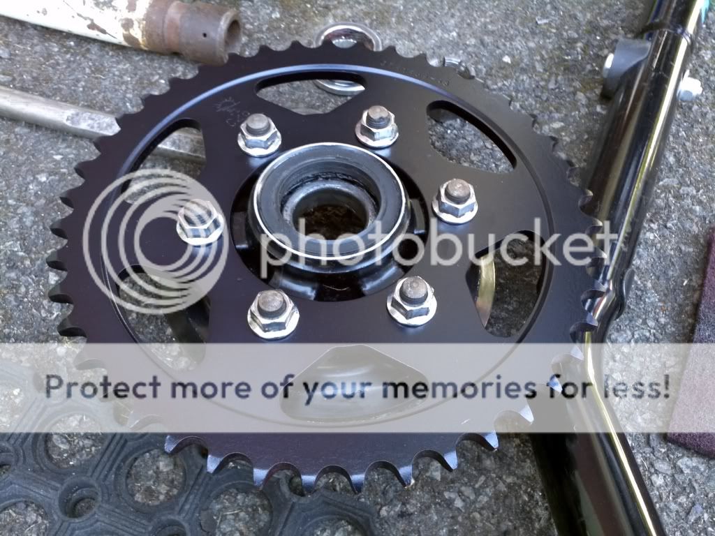

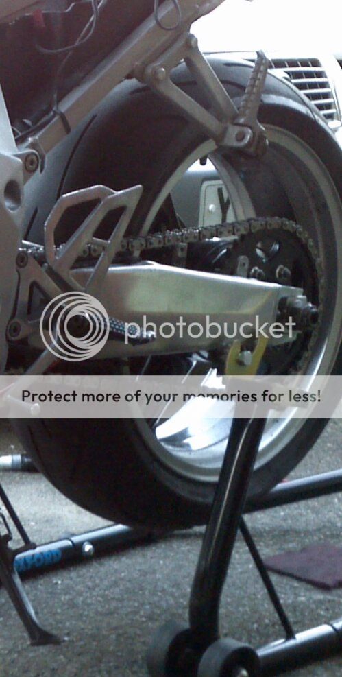

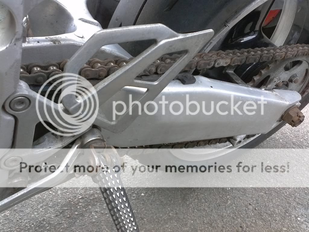

continued too clean up the rear end with the good old wire wheel and paint!
https://i1148.photobucket.com/albums/o564/pixelguyy/IMG_20130606_164118_zps4ee9db4b.jpg
https://i1148.photobucket.com/albums/o564/pixelguyy/IMG_20130606_173423_zps65ff3cde.jpg
https://i1148.photobucket.com/albums/o564/pixelguyy/IMG_20130606_173551_zps1e1f7926.jpg
https://i1148.photobucket.com/albums/o564/pixelguyy/IMG_20130606_164109_zpsbe017eac.jpg
https://i1148.photobucket.com/albums/o564/pixelguyy/IMG_20130606_174333_zps4ea0654a.jpg
https://i1148.photobucket.com/albums/o564/pixelguyy/IMG_20130606_164139_zpsa3a523ee.jpg
https://i1148.photobucket.com/albums/o564/pixelguyy/IMG_20130606_173415_zpsc70fa17e.jpg
https://i1148.photobucket.com/albums/o564/pixelguyy/IMG_20130606_181045_zpsa7ab5bec.jpg
https://i1148.photobucket.com/albums/o564/pixelguyy/IMG_20130606_20232201_zps0537d604.jpg

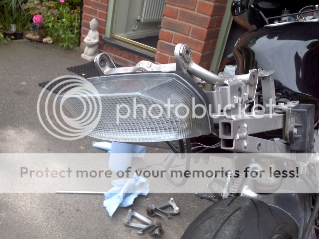

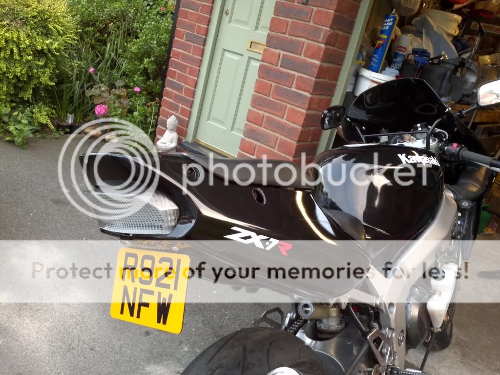

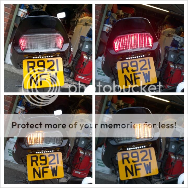

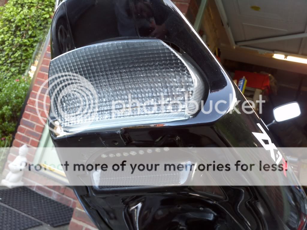

luckily the bike came with an undertray and i wanted too get rid of my indicators on the rear sooooooooooooo.....
https://i1148.photobucket.com/albums/o564/pixelguyy/IMG_20130612_141201_zpsc4225c86.jpg
https://i1148.photobucket.com/albums/o564/pixelguyy/IMG_20130610_181824_zpsf1b6fb95.jpg
https://i1148.photobucket.com/albums/o564/pixelguyy/IMG_20130610_181853_zps3c053467.jpg
https://i1148.photobucket.com/albums/o564/pixelguyy/IMG_20130610_181906_zps3a14ebb9.jpg
https://i1148.photobucket.com/albums/o564/pixelguyy/IMG_20130610_205123_zps2843aa11.jpg
https://i1148.photobucket.com/albums/o564/pixelguyy/IMG_20130610_194143_zps6642a8a5.jpg
https://i1148.photobucket.com/albums/o564/pixelguyy/PhotoGrid_1370895555258_zps4e400e4d.jpg

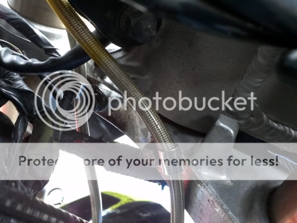

Braided front lines came today, nabbed them secondhand for £20! bargain i couldnt resist! unfortunately one of the lines has yellow staining so i had to fit it upsidedown which made it a bit of a pain.
https://i1148.photobucket.com/albums/o564/pixelguyy/IMG_20130612_143018_zps726fb3cb.jpg
https://i1148.photobucket.com/albums/o564/pixelguyy/IMG_20130612_143023_zps0361af87.jpg
mounted cable guides where the old link reservoir sat!
https://i1148.photobucket.com/albums/o564/pixelguyy/IMG_20130612_144032_zps7de9c9f7.jpg
https://i1148.photobucket.com/albums/o564/pixelguyy/IMG_20130612_143030_zps890aa8a2.jpg

Nice bike. I wish I could be bothered to make my 6r this nice but I'd rather to for a ride and make it dirtier Razz
Just a couple of concerns; the tail light unit won't pass an mot and could get you a fine from the police if they take issue with it. Silicone hose is also pretty dodgy to use in a braking system as it reacts with the fluid.

I've recently fitted a smoked version of that rear lamp to my 7R. Keep your old indicators for MOT though, as they are supposed to be 260mm (I think) apart. At the last MOT the examiner did measure mine.
Are you going to get the wire wheel and high temp paint on those headers? Did mine last weekend and makes the bike look much better.
haha its all worth it, takes a lot of time though!
thanks for the heads up! as for the light i was also concerned about this but i permanently have my lights on meaning the taillight is always red as standard ones are so i think it should be okay Smile i still have all the standard parts just incase! also iv used this type of silicone hosing for all my brakes and none have had any problems so i think it should be okay! Mr. Green

thanks Very Happy ill have a word with my friend who does MOTs see what he says!
iv already high temp painted half of the pipe that sticks out of the fairing and it makes the bike looks a lot better! as for the header area that is hidden i think ill just leave them until i get a new system Laughing

What did you use to clean up the metal such as rear sets? my project is in a similar metal state in need of cleaning

I believe those tail lights are illegal as there's meant to be a certain distance between the indicators, and those tail lights fall foul of it. Can't find the wording online to back that up, so may well be talking rubbish though.

i used degreaser and a jetwash too get all the caked on dirt and mud
rubbed them down with some scotch brite to get the remaining crap off (scrotch brite is the rough stuff ontop of a washing up sponge)
and gave them a rub of autosol metal polish Wink

not sure whether too just use the taillight as a brake light and stick some normal indis into the undertray now hmmmm..... Sick
Might want to get a bit of rubber between the line and the clip or it will eventually wear through the PVC, then the braiding, then you'll die.
Good work so far though Thumbs Up .
joezxr
Joined: 06 Jan 2013
PostPosted: 11:48 - 13 Jun 2013    Post subject: Reply with quote
funnily enough i had to remove the rubber because the pvc coating stuck too it lol, iv re-positioned them so that they glide freely and made sure the metal isnt very sharp so all should be okay! Smile

Why don't you remove the plastic coating off the hoses? its what I did and it makes them look like new..........................
https://i121.photobucket.com/albums/o222/woodyeee/IMAG0807.jpg
Then all you do is buy a couple of these stainless hose clips.........
https://i121.photobucket.com/albums/o222/woodyeee/IMAG0906_zps5e65643f.jpg
Job done Very Happy
Glad your off has not put you off biking as it looks nasty.....but remember chicks love scar's Laughing
Keep up the good work Thumbs Up
Job done Very Happy
i didnt realise you can just take them off! Surprised
how did you do that with a stanley blade or something? i think ill let mine get a bit more yellowish then peel them Mr. Green

joezxr wrote:
Job done Very Happy
Yes i carefully cut the sleeve with a stanley knife and peeled it off.
