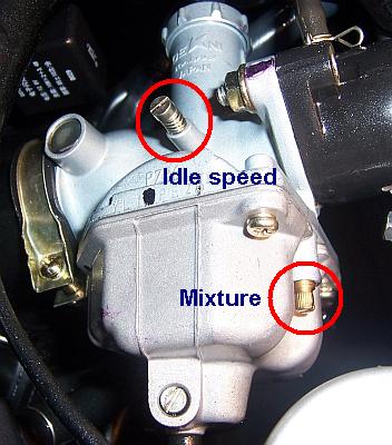

Get its clothes off and have a look at the carb.
Does it look like this?
https://2.bp.blogspot.com/__DYtEEjm5wE/SdE2lp3cYgI/AAAAAAAAABo/92yQIiecTJM/s1600/carb.jpg
If so, you'll want to adjust both the idle mixture and idle speed screws until you've got it running sweetly.
They tend to come set lean from the factory, so I'd expect you'll want to unscrew the mixture screw a bit, but who knows what's been done to it. Just try small adjustments in either direction until the idle revs are maximised.
Use the idle speed screw as necessary to keep it idling smoothly then back it out until it's idling at about 1200 - 1500rpm, as low as it'll comfortably go once its warmed up.
Do all this with the choke off.
If your carb looks different, then post pictures of it - someone will know where to poke it.
Thank you very much, will have a lookie tomorow and report back, ace pic!! cheers
