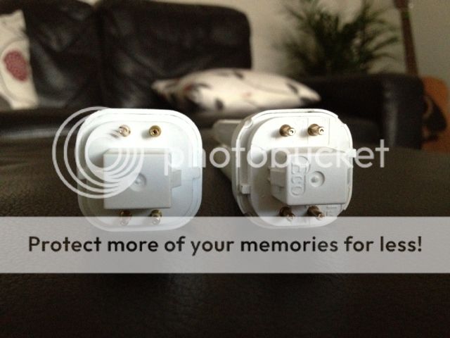

Right so I've just bought a new house and the outside light at the front has one of those 4-pin energy saving fittings in it. The bulb is too bright and I want to swap it for a dimmer one. Here's where the fun starts. I bought a smaller bulb and, spot the obvious problem:
https://img.photobucket.com/albums/v404/angryjonny/bulbs_zps4dd72131.jpg
New bulb on the left, old bulb on the right. The plastic teeth on the side are in different places on each bulb. There are gaps in the holder for the teeth to slot into. The old bulb fits, the new one doesn't.
Is there a reason why they've done this? Is it unsafe to fit a 10w bulb where there was an 18w one? Or can I just file the teeth off the new bulb and shove it in there?

hi im a sparky, yeah there is a reason for this, without going into it too much, the light fitting is for ie 18w and no more no less.
like said in the previous post, remove lamp holder and replace with what ever you want, 230V mind.

Feel free to go into it as much as you like. I'm here to learn, that's why I started the thread. What happens if I fudge a 10w bulb into an 18w holder? I can understand the dangers of adding watts, but taking them away...? Bayonet and screw fittings will take anything from 8 to 150w.

Looks like you have two different brands of bulb, possibly the manufacturers are trying to monopolise somehow?
This 10W version also has the off-centre notches, as do the 13W, 18W and 26W versions, so with those you could mix and match as you please.
So my Internet-educated guess says you can probably file off those notches as it's just the manufacturers being dicks Thumbs Up

Gx24q-1 on the left and gx24q-2 on the right.
You could file them down but easiest thing would be to buy the correct lamp in the first place. Wink
Bases are specific to wattages btw so SA your wrong IMO.
Oh yeah, my bad.
Looked closer at the link I put in my last post, turns out the 10W and 13W versions have q-1 bases, and the 18W and 26W versions have q-2 bases, which would separate the wattages as you say.
Presumably it's only to stop you from going too high of a voltage, rather than too low, so yeah I guess everyone suggesting filing it down is ok in this instance.
However, to satisfy my own curiosity... What's wrong with stepping the wattage up? Isn't the bulb just a component in a bog standard main ring house circuit? As long as it doesn't exceed the 230V supply, what's the big drama?

Well that's kind of my original question. Why, exactly do they do this? It's irritating enough that I can't buy standard incandescent bulbs any more (no, energy saving bulbs are not "just as good" and the halogen ones are harsh) but to be restricted to a particular wattage based on the bulb holder seems needlessly restrictive.
So I've filed the teeth off. Fight the machine, Jon!
As for suggestions to change the holder; well I could but it's part of an outside lamp unit that came bolted to the house when I bought it, brand new. To replace the whole lamp would be pretty wasteful when I already have a bulb that almost fits it and a Stanley knife. If there are no real-world risks associated with fettling the bulb (and I've yet to hear a good reason why they're manufactured this way) then that's what I'll do.
There is nothing wrong with stepping the wattage up as long as the fitting is rated for it.
I think you are getting confused with voltage and current, the voltage won't exceed 240v but as the wattage goes up so will current draw.
Lights are either fed from a 6amp MCB or 5amp fuse wire. Outside light could be off the house ring but fused Down to 3amps at the switch fused spur.
The only limiting factor is what the manufacturer has rated there fitting at and the max switching capacity of the PIR.
