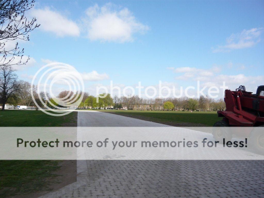

I designed and supervised a new road in a park a few months ago. I should only have supervised but there were no drawings at all when it was given to me to sort out.
It's an open block type so no gulleys required, water runs through the blocks and then through the graded fill underneath. It was to prevent the park getting wrecked by HGVs when they set up events.
