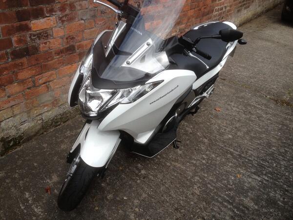

For the past two weeks the cbr chain has been bouncing around a bit because I hadn't adjust the slackness - I don't have the tools to undo the rear axel, so thought "I'll just take it to Honda next week".
Called up yesterday, brought it in at 9am today, they tightened the chain and when I set off there were horrible crunching noises as some of the rings around the thingy's on the chain had completely come off.
If I'd gone on the Mway today, that chain would've come off and I would've been a gonner. Guys at Blackpool Honda have been awesome, new chain + sprocket kit is costing me £160+, but they'll have it done tomorrow and they gave me this 700cc hybrid in the meantime:
https://pbs.twimg.com/media/BSwR8FsIgAAmAJT.jpg
It's actually not bad, twist and go, still faster than plenty of cars and (I have been told) does 109mph.
Moral of the cool story bro: keep your chain tightened properly!!
