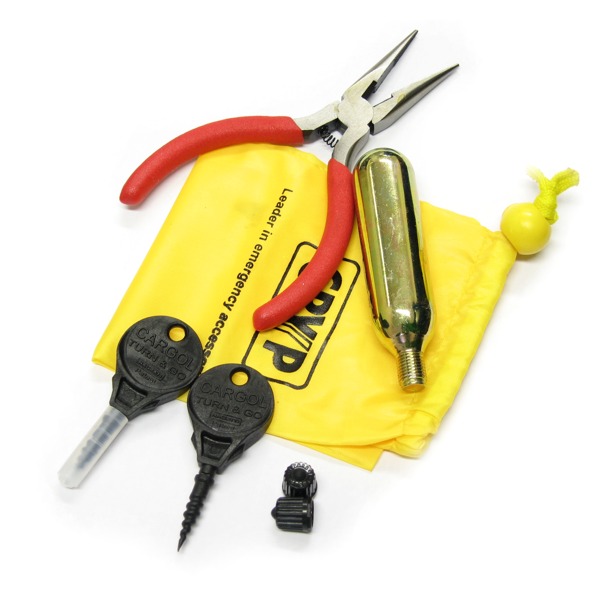

I carry a slightly different kit. Mine has 2 plastic 'screw keys' and some compressed air. The idea being, you get a puncture, remove offending object (nail etc) then take the plastic key and screw it into the hole. once its in all the way, you snap of the head, and fill with air.
https://www.sportsbikeshop.co.uk/product_images/motrax_k004.jpg
One of them, but without the pliers(and more CO2)
I was shopping around for a roadside repair kit, and thought it looked easier than the "make the hole bigger then smush in some rubber, glue, cut it off etc" type ones Embarassed . Never had to use it so no idea how well/if it works though.
