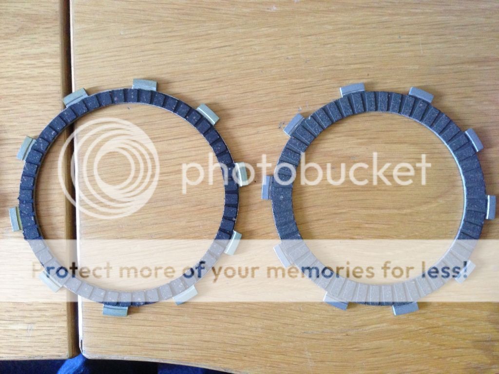

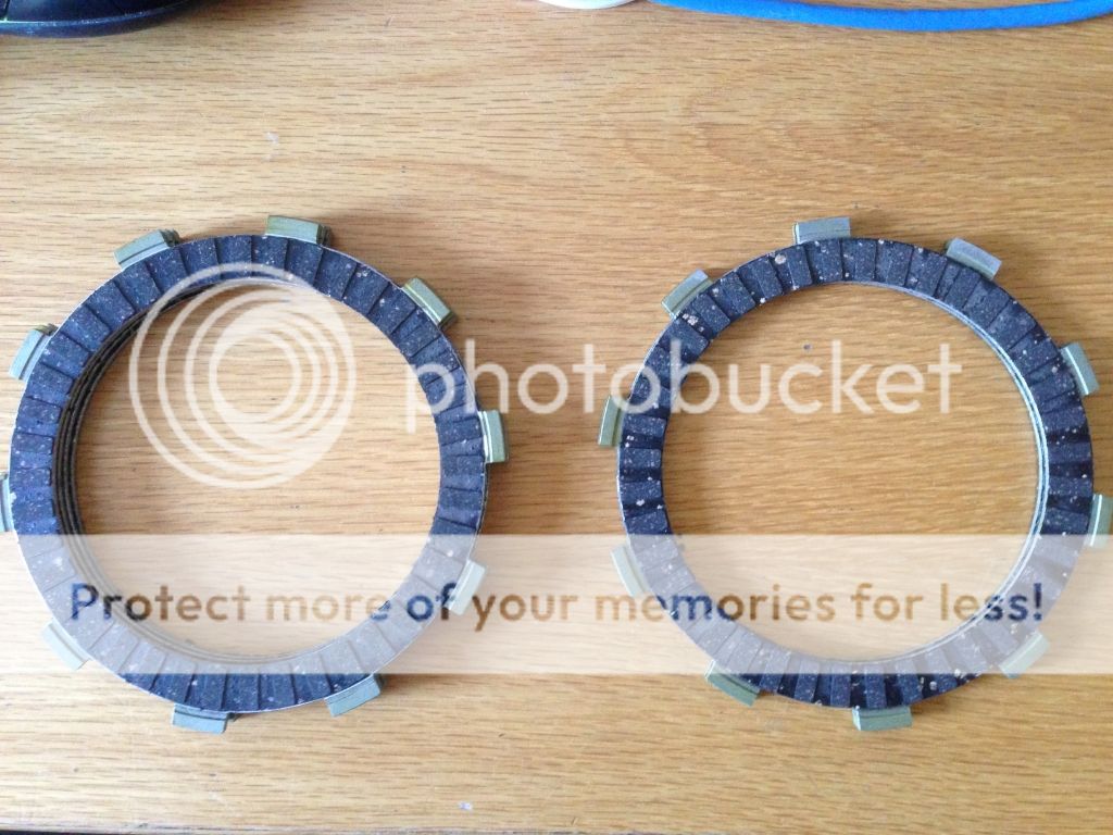

I received 8 clutch plates, which is correct. My clutch plates are still in their basket, on the bike so I can check when I get in, but wanted to confirm these are correct. There appears to be 3 or 4 different types. One has silver lugs, which I think is the one that fits in the lugs on the outside of the basket. One plate has a shallower ring than the others, I'm sure this will be apparent when I split them all up where this fits. They arrived in two piles of 4. The first picture shows one of the piles of 4 and what appears to be identical ones in a pile of two. Then the second picture shows the totally different plates. I did have a look at the Haynes book of lies, which is also at home, I do remember it had plates labeled A and other letters. When I looked on the bike, they seemed to be mostly A.
I'm hopefully going to do this tonight, any advice? I did get a new nut so it can be pressed back into the shaft. I have new EBC clutch springs, they were £1 more than the regular ones, clutch plates are pattern. New clutch cover gasket too. It was all disassembled without too much issue, currently loosely fastened together.

Same as my Vara, 4 larger looking plates, one smaller. I too was confused but all was clear when cracked open Thumbs Up
