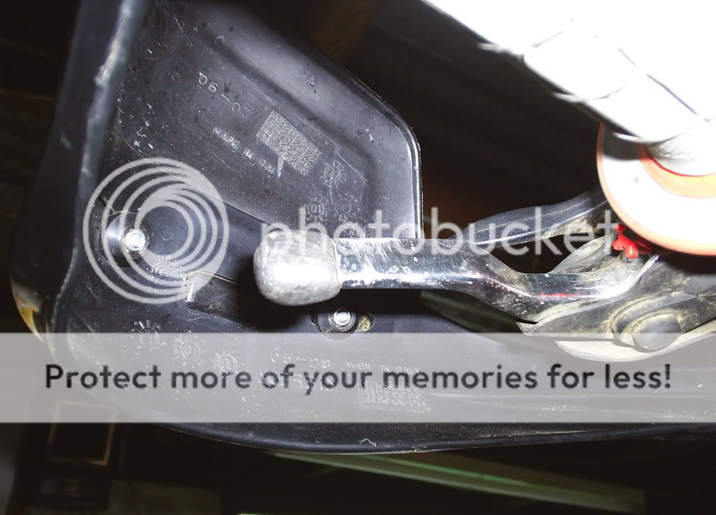

I use only two fingers to pull the clutch lever in.Having ridden dirt bikes in enduros for quite a few years I am usually holding onto the bars of a machine which is moving around a lot.Having a light clutch is an absolute must while racing.This has carried over onto the road bikes and I run the R1 with a motocross lever
https://i666.photobucket.com/albums/vv23/WiNot_Rhencullen/Workshop/Picture402R1clutch.jpg
I even shortened the standard hydraulic clutch lever on the KTM as that trapped my smaller fingers when pulled right in

Many people have fitted shorter aftermarket levers and found the bikes easier to ride.I prefer a full length brake lever on the road bikes,but that is my preferance Thumbs Up
