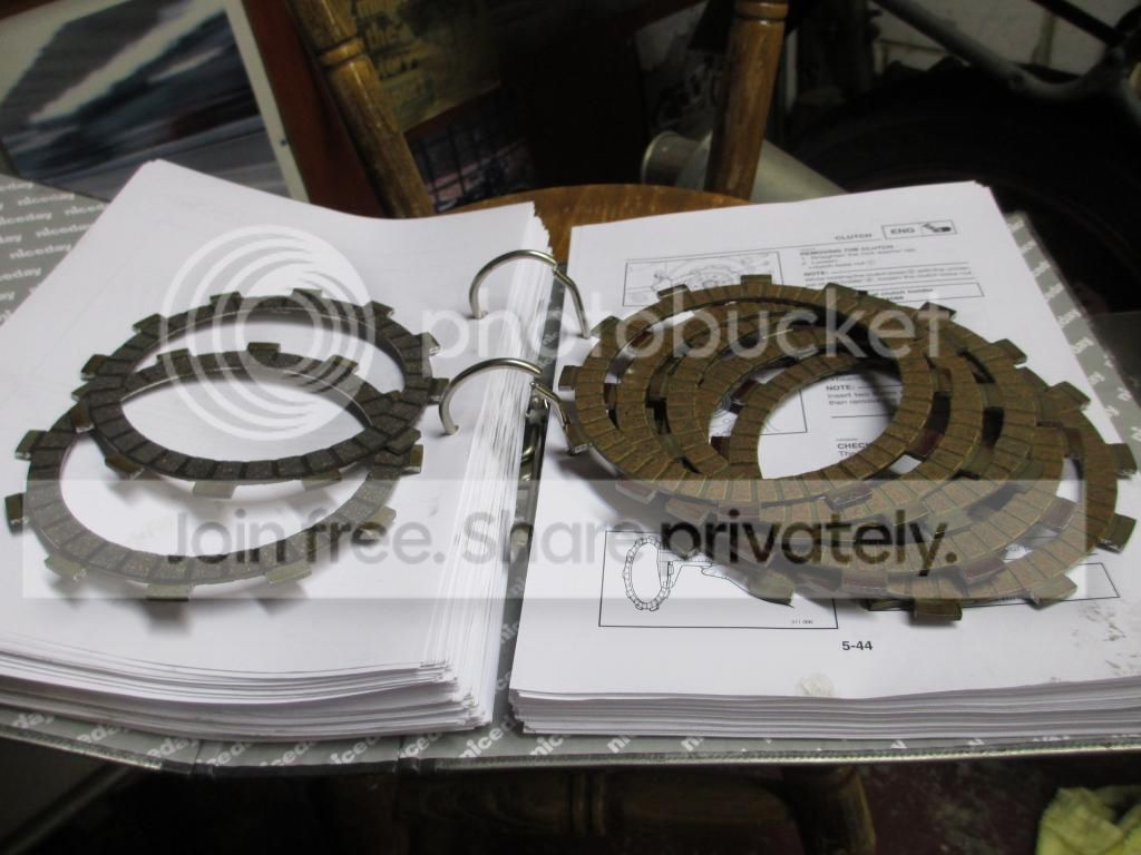

You should have some form of manual to tell you the tolerances of the wearable parts. I have the Official Yamaha Manual. I think the Manufacturers manuals are the best. You should find them with a bit of googling if not ask at the relevant model specific forum. If you work in an office, stay late one evening and print it out, top off the feeling of smugness by also taking a ring binder to put your 500 page manual in. Laughing
https://img.photobucket.com/albums/v295/chris-red/IMG_0064_zpsb6795805.jpg
Here's mine, as you can see if been here before!

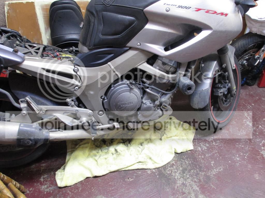

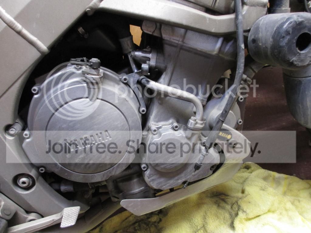

Right starting on the job. If you didn't know the clutch is on the right hand side of the bike. It is behind the casing where the clutch cable goes into it's usually the big and round one. While this guide is based on the TDM, most bikes are very similar.
https://img.photobucket.com/albums/v295/chris-red/IMG_0058_zpsa7d65c0c.jpg
Now normally it's worth changing the oil, but mine was done recently so I'm not going to. You can avoid spilling oil by leaning the bike on the side stand. Note if you open the casing on a centre stand it is likely piss oil out.
First park the bike up on the side stand and leave it for a while let it cool (if you have been using it) and let the oil settle.

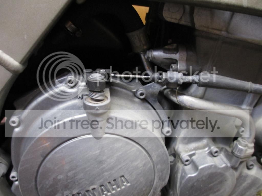

First thing you need to do is remove the clutch cable. Undo the bolts holding the cable outer to the bracket to free up some slack.
https://img.photobucket.com/albums/v295/chris-red/IMG_0060_zps68b9a5e2.jpg
The mechanism on mine has a little tab to prevent the cable from coming you need to bend it up to let the cable out.

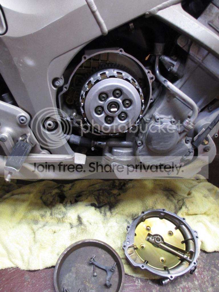

Once it's off it time to undo the casing I have a towel under mine to catch any spray oil luckily it wasn't needed. Make a note of the lengths of the bolts coming out on the TDM they are all the same barring the the 2 that hold the cable bracket. Other bikes may be different. Keep all bolts in a tray or something it makes it much harder to lose them I also use different trays for different areas.
This is what you'll be greeted with.
https://img.photobucket.com/albums/v295/chris-red/IMG_0062_zps5feb9096.jpg
https://img.photobucket.com/albums/v295/chris-red/IMG_0063_zps83e2030d.jpg

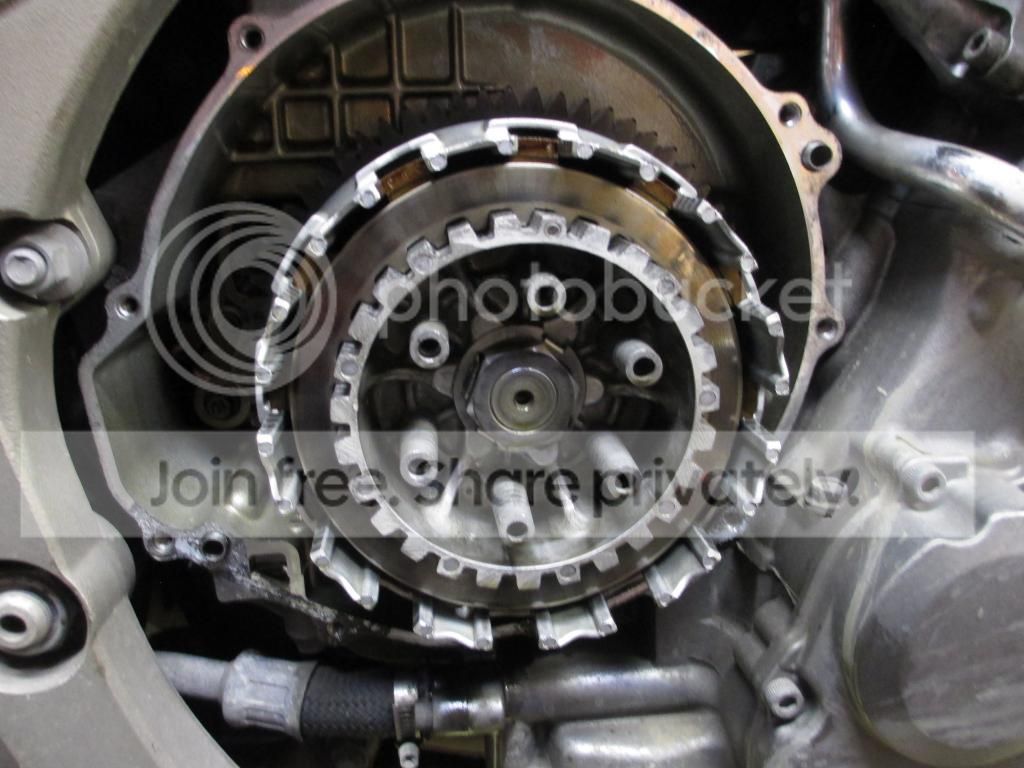

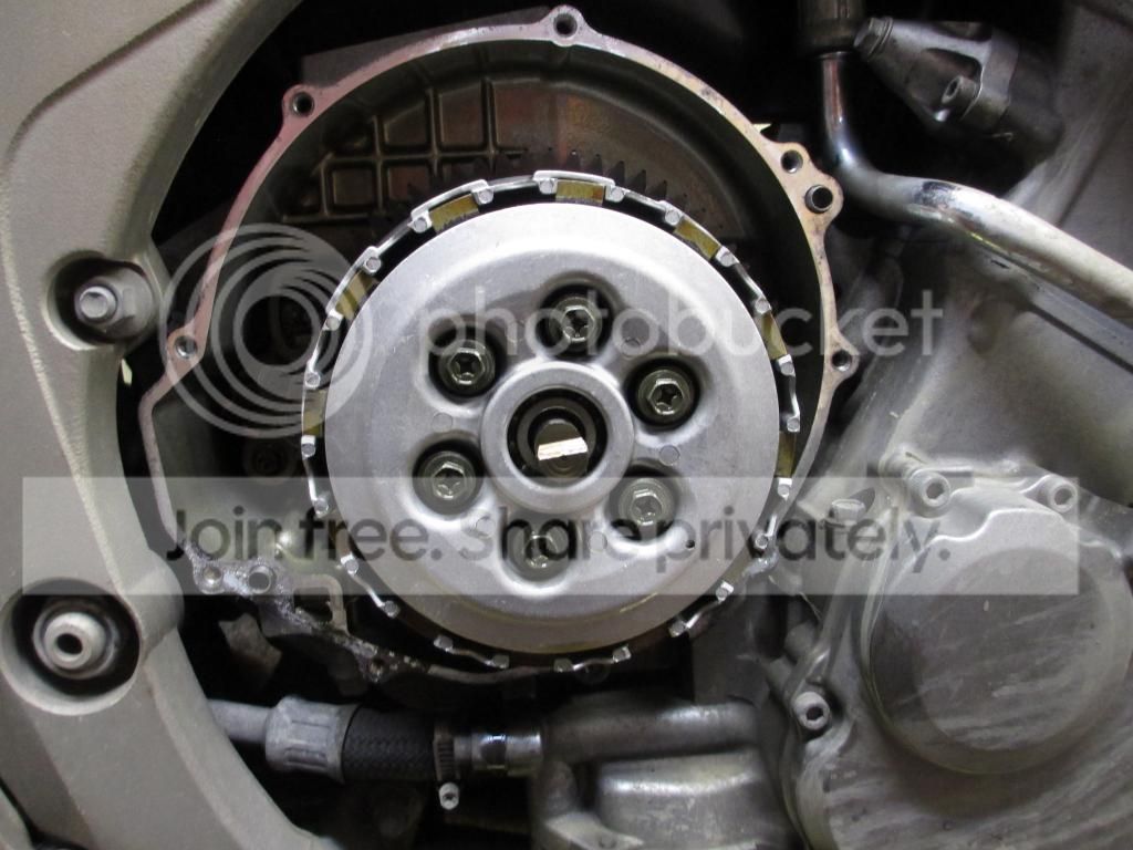

The silver disc is the pressure plate, pulling the clutch lever pulls this outwards. The bolts have springs that force the pressure plate onto friction plates and give you drive. Remove the bolts but be careful they are sprung. The springs are the first wearable part, there will be a guide to what length they should be. I know mine where fine as they are 'heavy duty' and not too old.

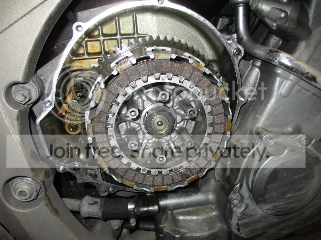

After the Pressure plate is off (and a few other plates) you'll have this.
https://img.photobucket.com/albums/v295/chris-red/IMG_0065_zps026ddbde.jpg
The silver plate is the steel plate the brown ones are the friction plates. As you can see the steel plate attaches to the inside hub and the friction to the basket, see how it works yet? When you pull the lever the pressure is released the plates can separate and the Inside hub (connected to the gearbox) will stop spinning when the rear wheel does while the basket and friction plates will keep spinning as it is connected to the crank.
Pull out all the plates The friction plates will need to be measured for wear as will the steels. My friction plates were on the limit which would explain the very slight slippage I had. I already gathered this was the issue has my steels are reasonably new.

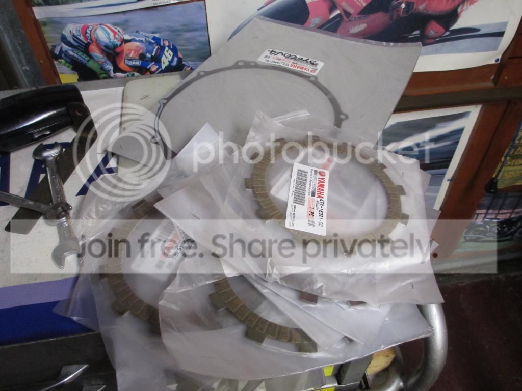

Here some I purchased earlier. I'll only use OEM Plates after some EBC ones shattered and trashed my clutch basket I was lucky it fucked nothing else.
https://img.photobucket.com/albums/v295/chris-red/IMG_0059_zpsc6a5a677.jpg
The downside of OEM, that is about £115 worth of parts. Crying or Very sad That consists of the 9 Friction plates and one Gasket. Always replace the gasket with a new one you probably could get away with reusing the old one if it is in good condition but it isn't worth it for the sake of £5-10. It'll cost you more than that in oil alone if it doesn't seal.
Once all unwrapped for the TDM you have 9 plates, 7 of 1 type and 2 of another, the 2 fit on either side of the complete clutch, I don't know what maybe they have different material to grip the the pressure plate/basket.

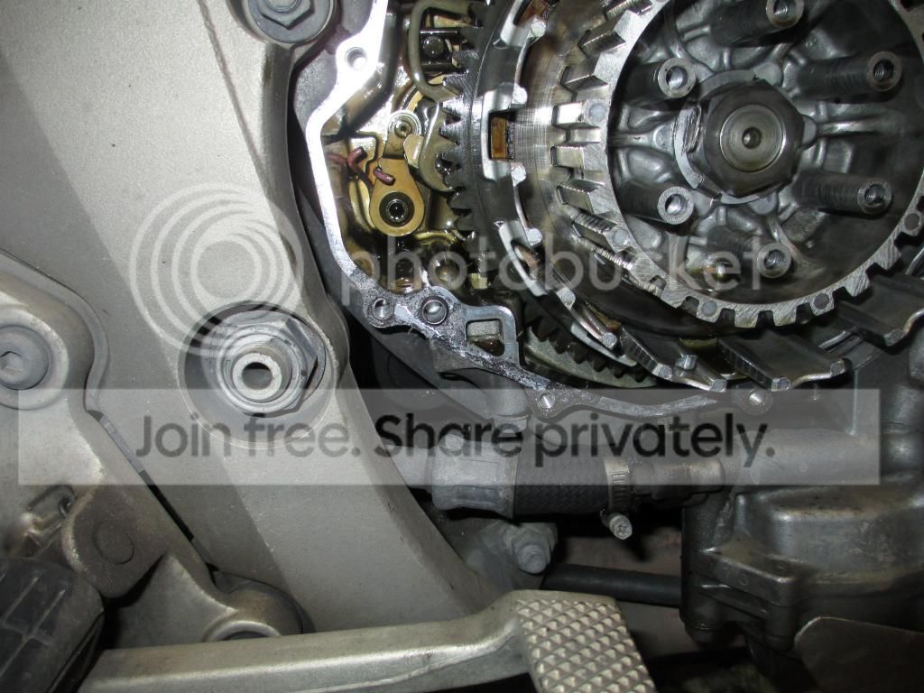

Before fitting the plates, some cleaning up to do, the gasket surface is a bit manky in places clean it up, I use a Stanley blade.
https://img.photobucket.com/albums/v295/chris-red/IMG_0071_zps81947129.jpg
This is where you can check for the other kind of wear in the clutch. The basket fingers can get grooves in them, you can see in the lower corner of the above photo although this looks far worse than it is mine is fine. If it gets too notchy the clutch can stick as the plate can't release.
https://img.photobucket.com/albums/v295/chris-red/IMG_0072_zps1d8d8128.jpg
