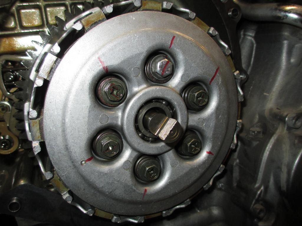

See thread on clutch rebuild for example of torque wrench causing a bolt to snap that otherwise wouldn't have. Did clutch rebuild, diddnt use torque wrench, no kittens were killed, 10,000 miles later it's still going strong.
chris-red wrote:
...Now the little bit of fail, my draper torque wrench appears to be fucked, I set to to 10nm to do the bolts up and the second I thought this seems a bit tight the fecking head of one of the bolts sheered off. Luckily removing the bolt wasn't too much trouble.
https://img.photobucket.com/albums/v295/chris-red/IMG_0073_zps6dbea3dd.jpg
I replaced it temporarily with another bolt and washer but I have a new one on order. I also marked the bolts as as I had no torque wrench I had to guess, I'll have it open to replace the bolt in a few days so I can check them. When you tighten everything up do them all up part way and tighten them by choosing one then pick the opposite one and do another and the opposite etc.
Well, things which require calibration in business, don't often go out of calibration, so I wouldn't say it's useless.
You'll most likely find, that there was a problem with the bolt, rather than the torque wrench. Sure, you may not have broken the bolt if you weren't giving it the torque, but you may have been left with an inferior bolt. There's a reason manufactures specify torque and without it, how can you be sure?
Calibration I can understand, however an 18 month old torque wrench that has been used maybe 3-4 times should never be so un calibrated it snaps a bolt at 10nm.
It wasn't the bolt as I put a completely unrelated bolt in the vice set it to 10nm again and managed to snap it before the torque wrench clicked.
