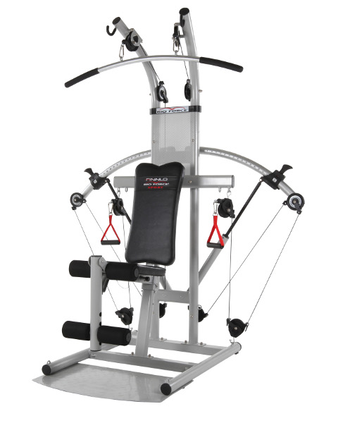

It's for making a barbell based 'multifunction trainer'.
I've got a decent set of Olympic weights and DIY 'power cage' at home, but would like something to stick in the motorhome when working away.
After having the amazing ideas, it seems people have stolen them and made them a few years ago Razz.
The pistons in the 'bio force multigym' claim to do what I want.
https://resources.sport-tiedje.com/bilder/finnlo/bioforce/finnlo_bioforce_001_d.jpg
I'm not convinced they do. Apparently you could get replacement pistons before, but it's not clear where - it seems to be a generic item re-branded by various companies.
