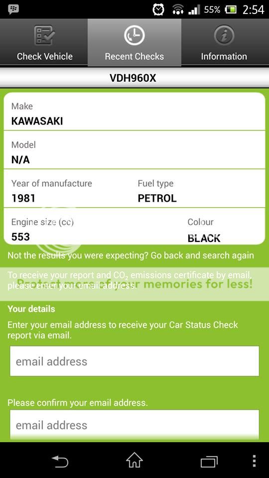

hi every one i just brought myself a project. it is in a bit of a state but hoping with some help to transform it into a go-cart or offroad buggy.
depends on state of engine in the bike i brought . like i say its a bit of a state so 1st i need to get it running to test engine and look at options, all the wiring is a mess wires cut ect the bike has been stood for many moons by the looks of. to get help il need to know what im working with. this leads me to the question. i need help to find out what bike it is, i know its a suzuki. reg check comes back that its a 550cc but model is unknown, the age has come back 1981. the frame numbers was on a sticker that has been sprayed over. looking over the net i have looked and the gs550, looks very similar but its down to the brakes mine has rear drum and twin disk the only ones i can find have rear disk or rear drum and single disk at front. this has been turned into a bit of an essay but hope someone can help https://i1271.photobucket.com/albums/jj632/Master_Jay9119/1471934_10151990920507207_1016595451_n_zps6da2ad3d.jpg

Black Kawasaki...
Date of Liability 01 07 1994
Date of First Registration 28 08 1981
Year of Manufacture 1981
Cylinder Capacity (cc) 553cc
CO₂ Emissions Not Available
Fuel Type PETROL
Export Marker N
Vehicle Status Unlicensed
Vehicle Colour BLACK
Vehicle Type Approval Not Available
jay9119
Joined: 21 Nov 2013
PostPosted: 11:41 - 21 Nov 2013    Post subject: Reply with quote
i am still missing the model. and it seems all data reports are not very informative.
Bezzer
Joined: 14 Apr 2005
PostPosted: 11:44 - 21 Nov 2013    Post subject: Reply with quote
It's not a Suzuki the GS550's were all 549cc, the Kwacker GT550 were 553cc. Post a picture to confirm it.

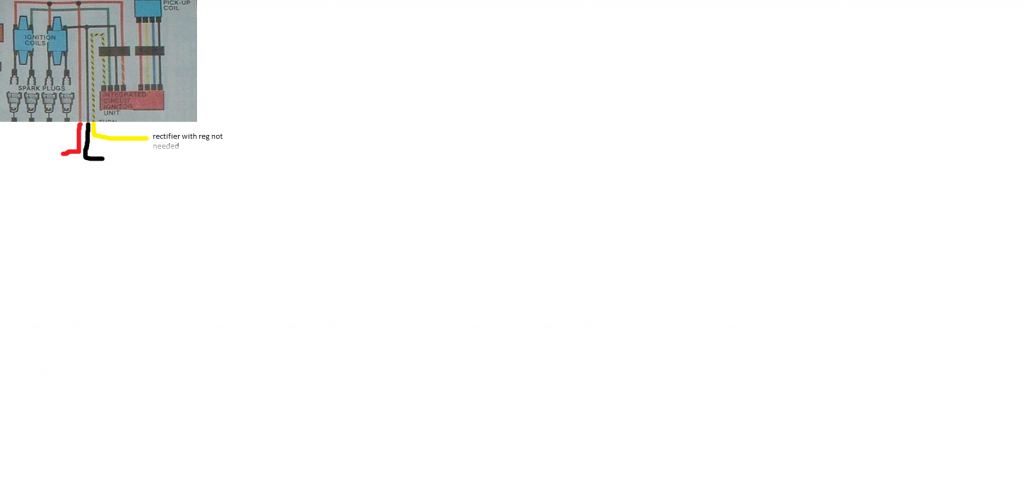

does anybody have a basic wiring diagram i want to build my own simple loom to get it running well at least try to get it running i dont need lights ect. and like i say my bike has twin disk on front, rear drum with twin shocks and a single exhausts

jay9119
Joined: 21 Nov 2013
PostPosted: 13:39 - 21 Nov 2013    Post subject: Reply with quote
i was after a simple loom just to get the spark i dont want light ect
jay9119
Joined: 21 Nov 2013
PostPosted: 14:28 - 21 Nov 2013    Post subject: Reply with quote
looking at the diagram above there is a lot i don't want.
the last loom i made was for a pitbike and was as simple as you can get, you have the wires from the stator plate to a cdi unit then to the coil to the spark off the cdi there was a wire you earth to kill engine
can i do the same on this even tho it has more cylinders so..
smegballs
Joined: 28 Oct 2007
PostPosted: 14:42 - 21 Nov 2013    Post subject: Reply with quote
Just get into mspaint and start getting rid of the shit you dont need. Start with light stuff and gradually reduce it down and down until you are just looking at the ignition circuit.
Like this, I've started you off.....

jay9119
Joined: 21 Nov 2013
PostPosted: 15:57 - 21 Nov 2013    Post subject: Reply with quote
surely this will be easy just need to find what the red and black connect to.
https://i1271.photobucket.com/albums/jj632/Master_Jay9119/cutdownloom_zps638f8fb6.png
i wont be using the battery or starter motor so wont need the rectifier
smegballs
Joined: 28 Oct 2007
PostPosted: 19:03 - 21 Nov 2013    Post subject: Reply with quote
Red is an ignition (and killswitch) controlled live.
Yellow/Black is ground. - (No idea why Kwak don't follow convention and keep black ground)
Black is one of the cold ends of the HT coils.
It looks like black is sent to the tacho as some kind of pulse so I'd leave it unconnected for the time being.
This is what I would try as a starting point.
https://i.imgur.com/zrGV49p.png

smegballs
Joined: 28 Oct 2007
PostPosted: 19:56 - 21 Nov 2013    Post subject: Reply with quote
jay9119 wrote:
thanks but i was hoping not to use a battery but will give it ago tomoz
What was you planning to use as the power source for the coils?
This is a TCI ignition system which will need an external power source. Unlike the self-exciting CDI ignitions on small two stroke and mx bikes.
