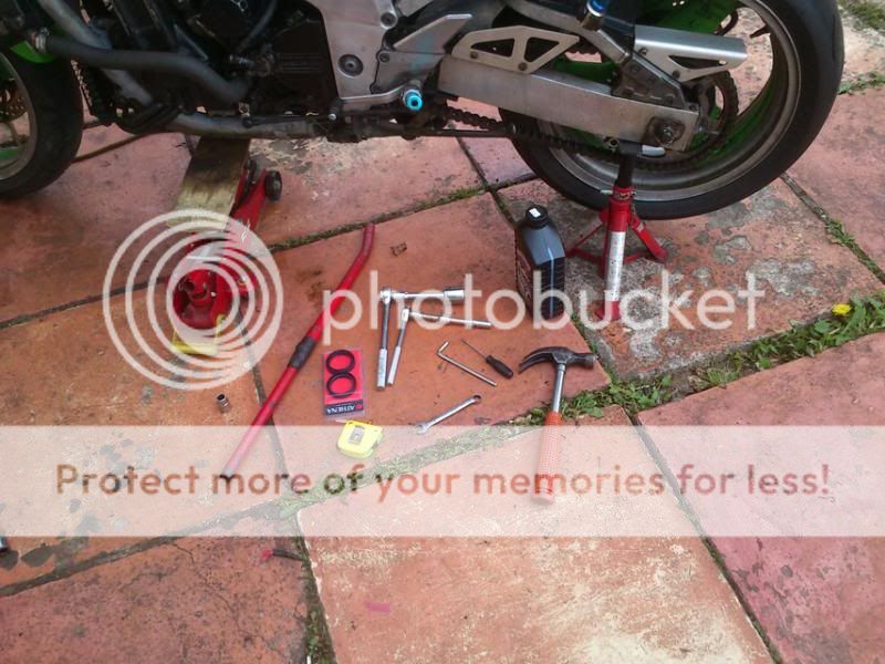

I'm sure almost everyone on here will disagree with me.... but I'll go ahead and say it anyway.
Unless you have a problem with the forks that require them to be completely stripped and rebuilt there is no need to go to all the effort of stripping them down.
I have done (to date), intruder 125, diversion 600, gpz 750, zxr 750 fork seals, and not once have I needed to strip the forks down.
Just drop the forks, remove the dust seals, use a screw driver to pop the old seals out then use them on top of the new seals to tap them into place... top up your fork oil, slap it all back together and you're good to go.... OK it's slightly more complex than that... but not much
This was the tools I used:
https://img.photobucket.com/albums/v320/andy36586/forksealtools_zps2e4d6c12.jpg
and this was after about half an hour:
https://img.photobucket.com/albums/v320/andy36586/forksremoved_zps635ade0e.jpg
